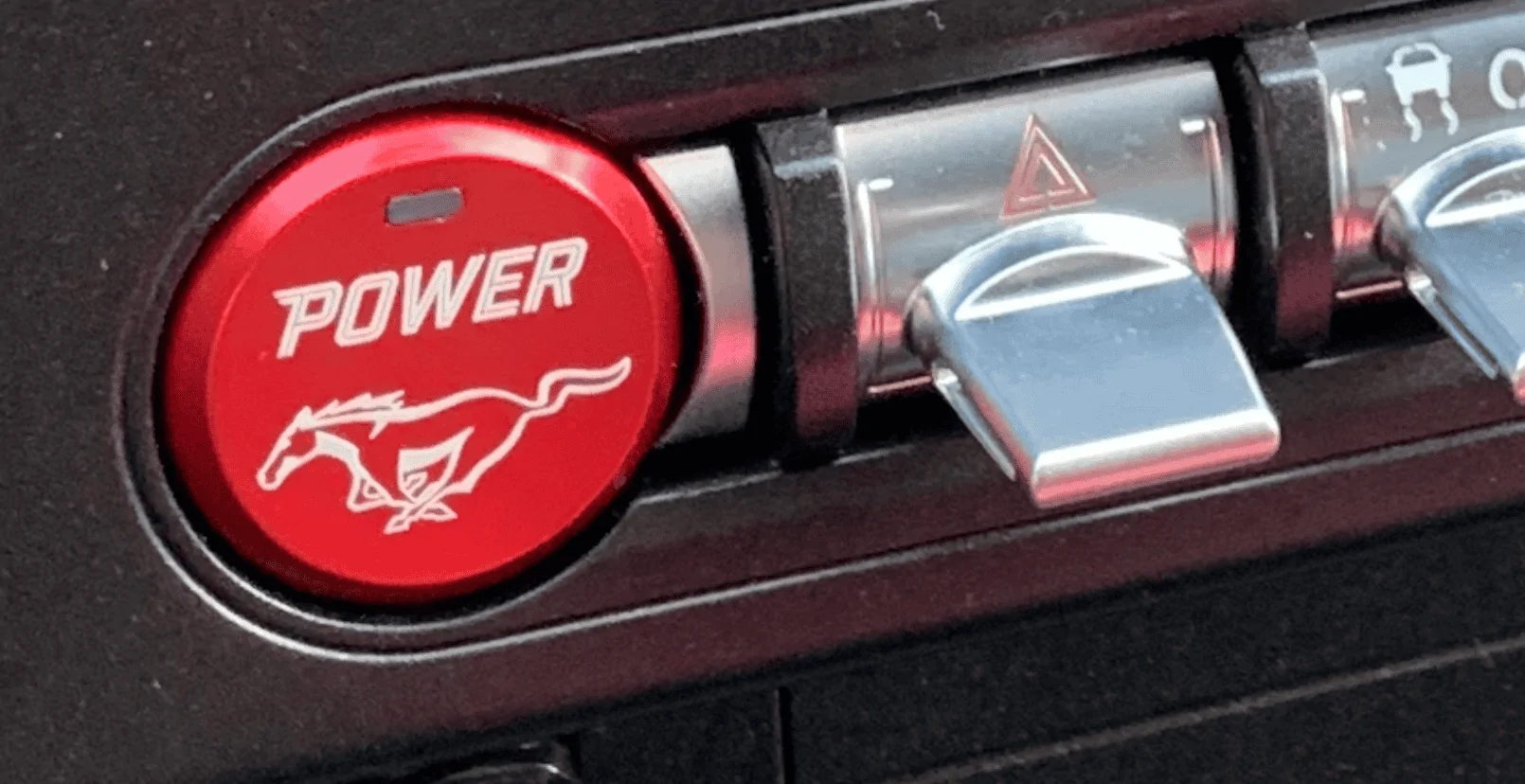

Sometimes it may feel like the button has clicked into place even though it actually hasn't. If something looks even vaguely amiss, then it probably is. When installed correctly the button is perfectly straight, and the LED fills the hole completely and is perfectly flush with the surface of the button.

I wish I could take the credit for that, but I must confess the pony wasn't my idea. I had actually ordered the standard "POWER" version, with an on/off symbol, like the one in Nick's picture. The pony was an unexpected bonus. :)

I like the pony. Did they just do that as a custom one? I didn't see it as an option.
