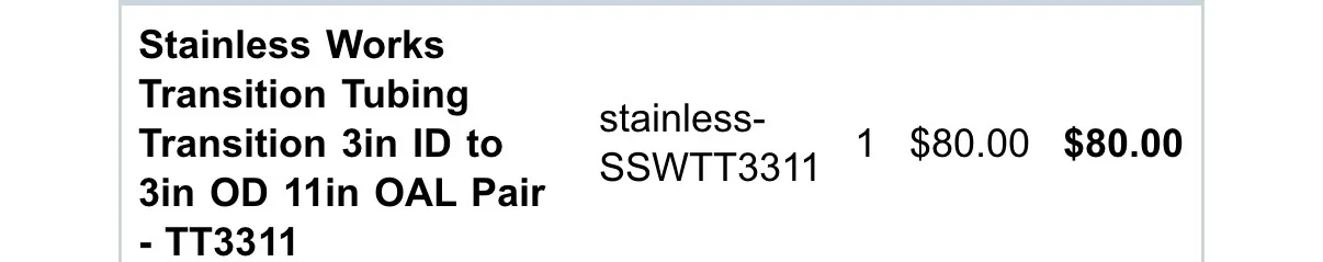

Stainless power / works makes "transition tubes" that will take the place of the cats for a delete .

I literally just bought mine a few weeks ago. Here’s the part number for the stainless works brand. Got them from Terry/Beefcake. I think full price was $100, I got them during the Memorial Day sale.

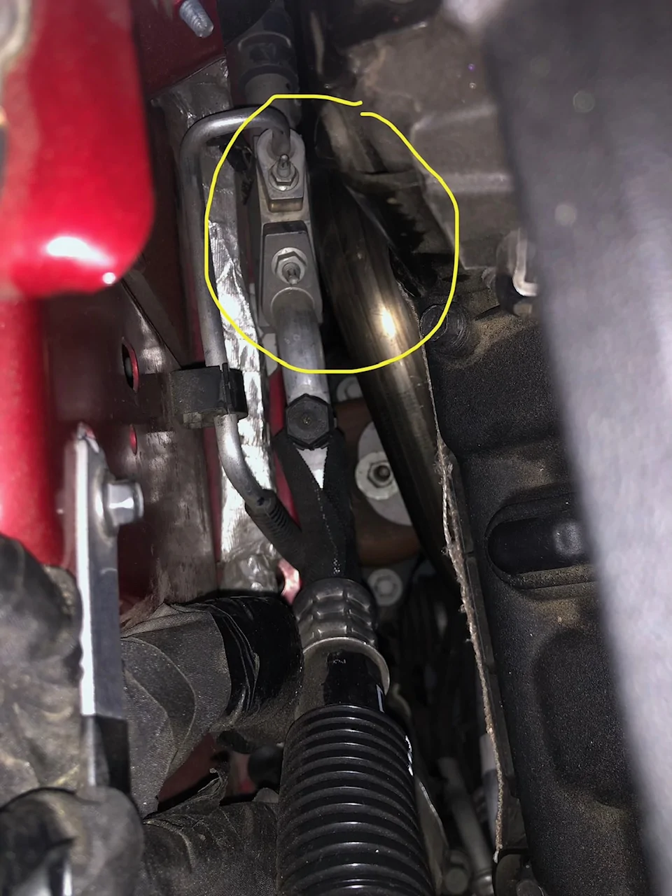

Are they sure it's the cats?
I have Stainless Power headers, and they are VERY TIGHT on one of the ac components. I'm sure it could cause a rattling sound, but I didn't like how close it was so I use a piece of high temp turbo hosing, bent it and drilled a little hole in it and put a nut on the top bolt to hold it in place.
I was wondering if it might cause a false knock if it vibrated.
It's even closer than it looks in the pic.
I have Stainless Power headers, and they are VERY TIGHT on one of the ac components. I'm sure it could cause a rattling sound, but I didn't like how close it was so I use a piece of high temp turbo hosing, bent it and put a bolt on the top piece to hold it in place.
I had the same issue with my Kooks headers. From up top it looked fine, but it was close enough to make contact at certain RPM or when turning left.
I was able to pry the line a little bit from underneath and gain enough clearance to stop the rattle.
