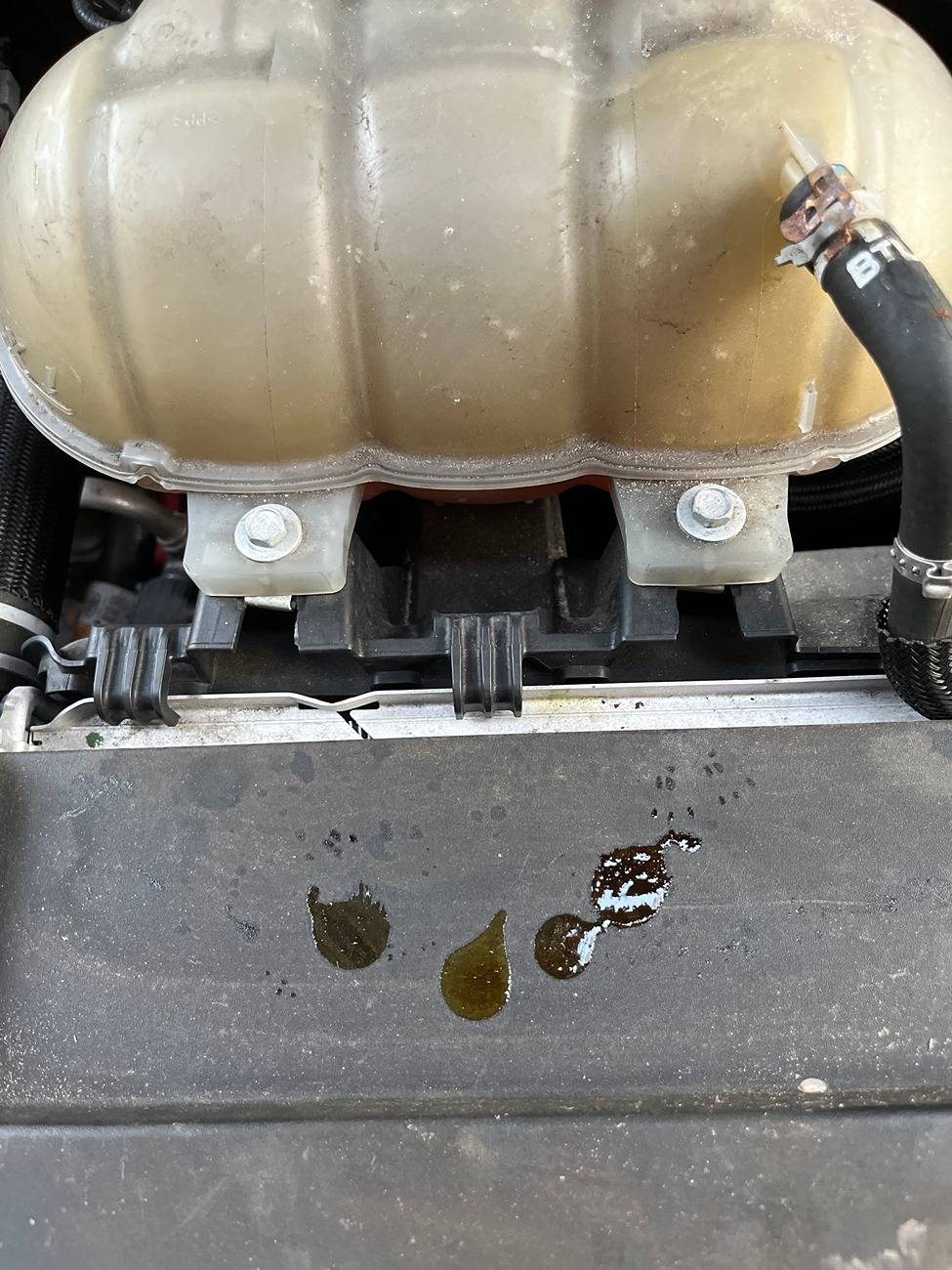

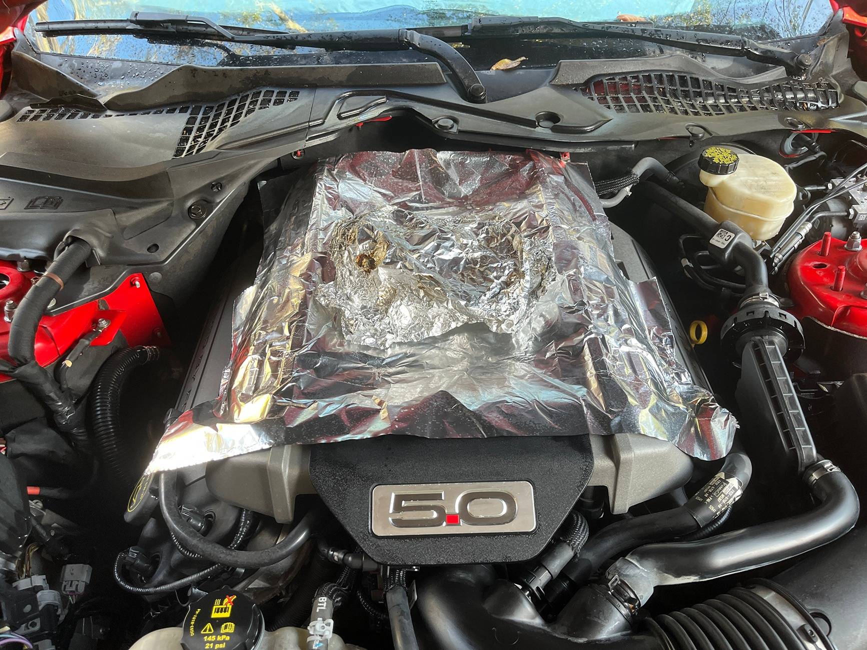

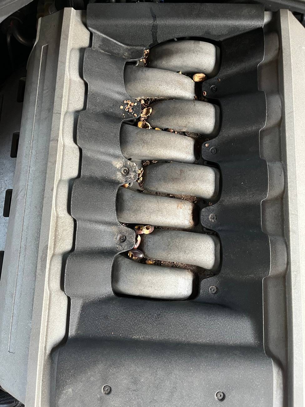

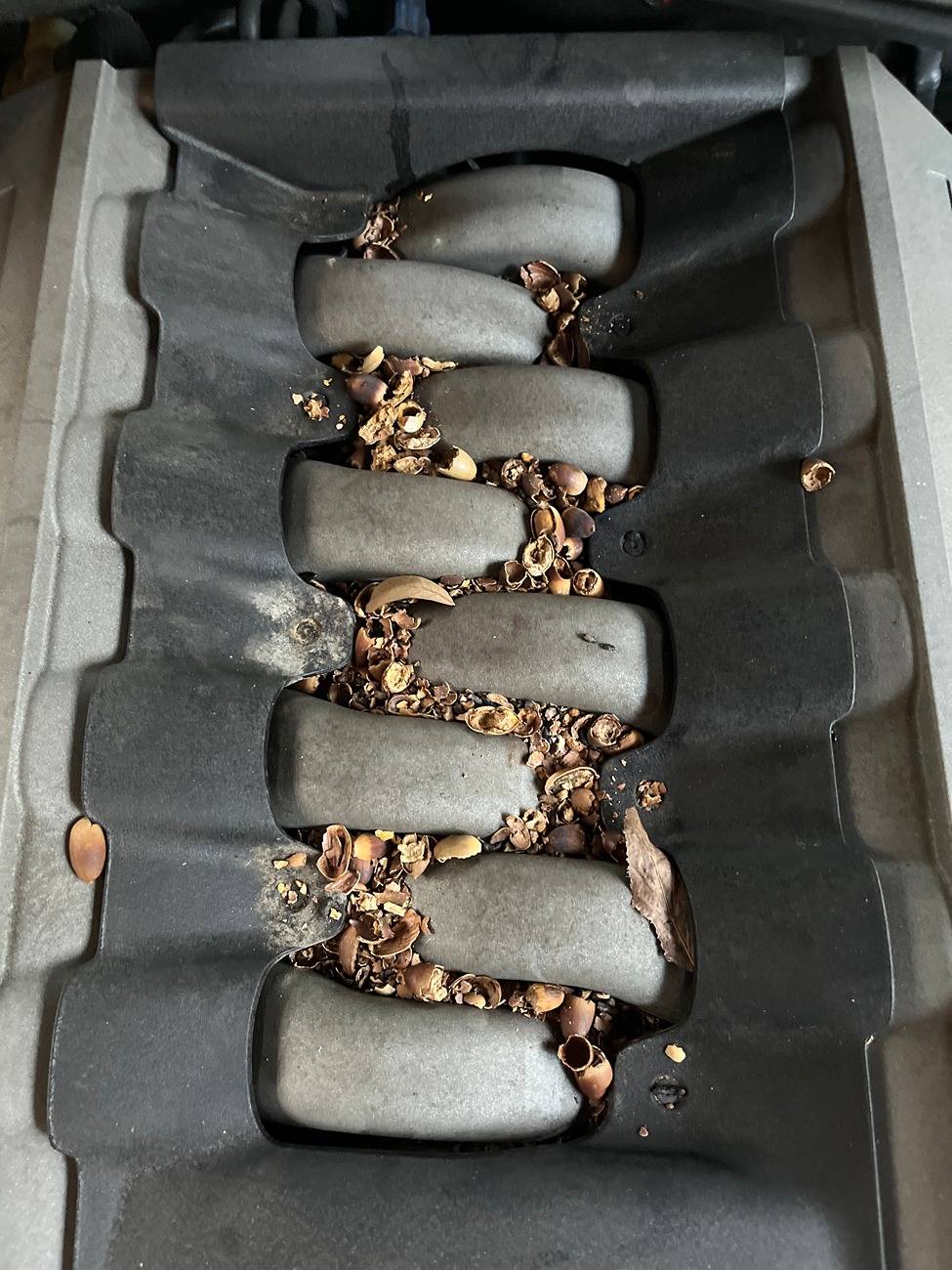

My car sits in a driveway in Tampa. I saw a pile of chewed acorns on top of the engine (Photo 1) yesterday and vacuumed them off. I looked under the hood this morning and saw more acorns (Photo 2), squirrel pee (3), and a squirrel crawling around in the engine bay. I covered the motor (I will remove it before driving) with foil (4) and sprayed it with insect repellant. Has anyone had a similar problem?

Hose off that entire engine bay to remove all defecation and scents.

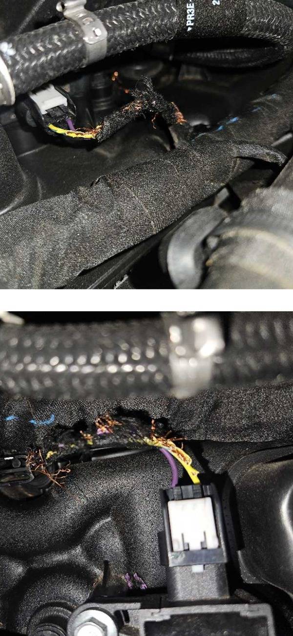

I'd be more worried about them chewing the wiring.
