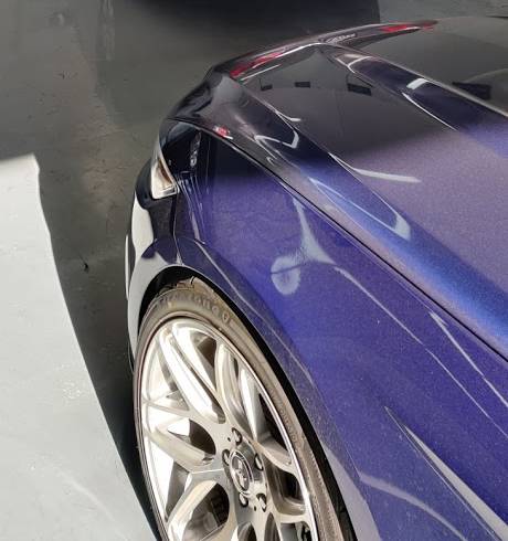

I’m on 20x10 square setup Et 35 and I added 5mm spacers to the front and running 275/35/20s all around. The cool thing about it, is that the speedo is accurate now ( checked with GPS and Radar) before it used to read 2mph over the actual speed

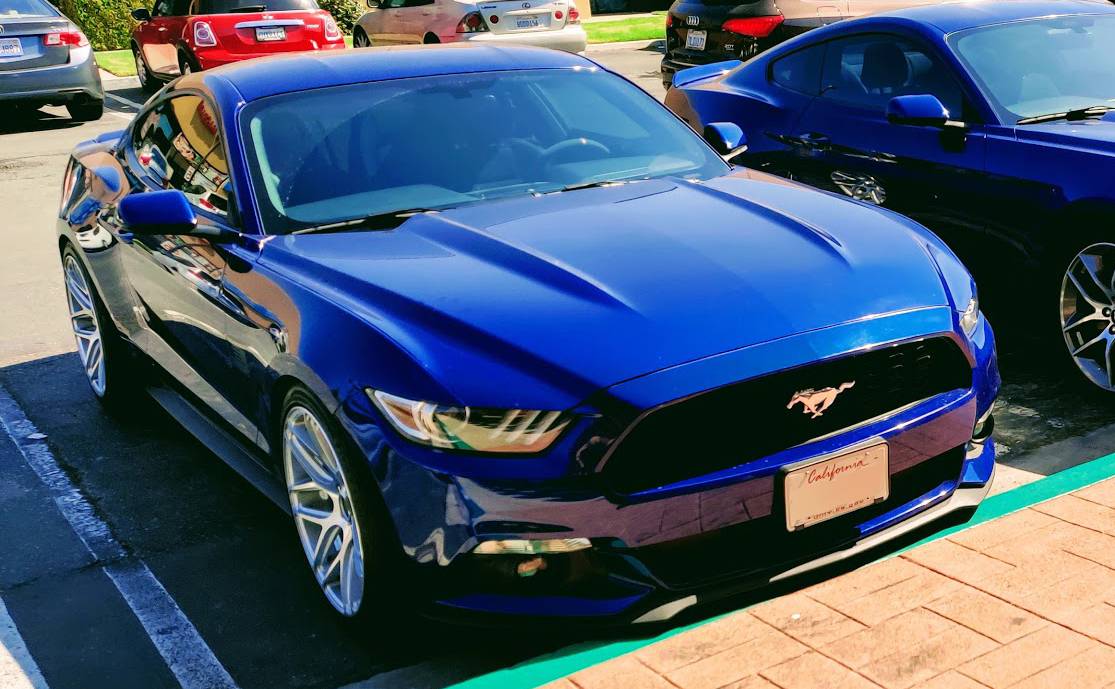

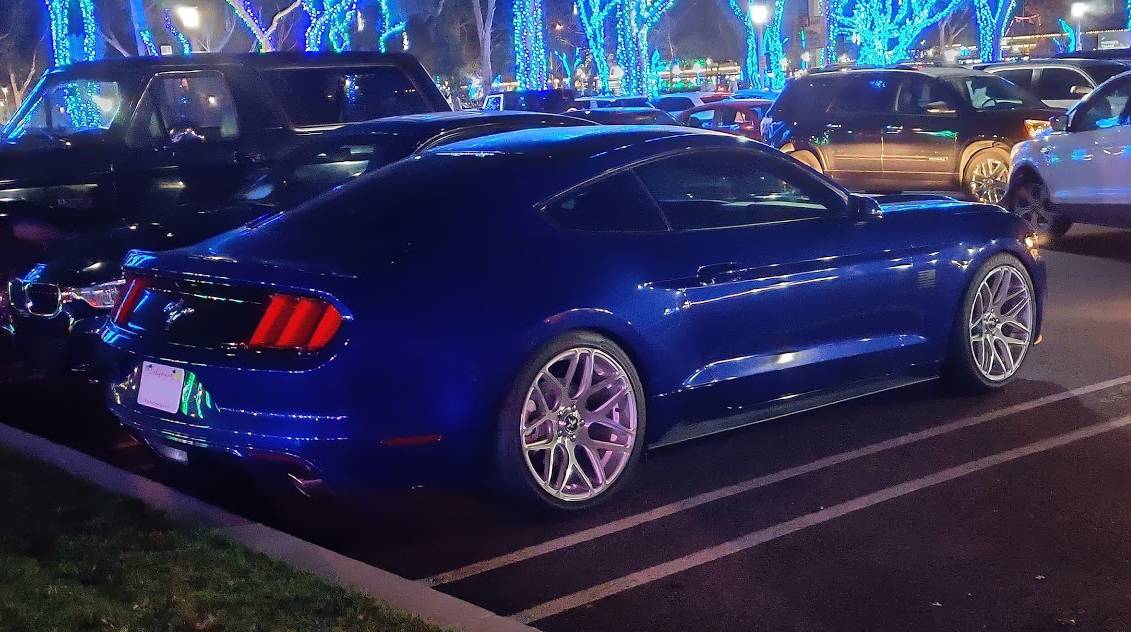

yes, here you go :)
It doesn't win any aggressive wheel fitment awards, but it looks good and doesn't rub and the speedo is accurate and it's on stock alignment, no camber plates,etc needed. Honestly for my car (v6) I think 275 is overkill, but I wanted the deep concave wheel look which I couldn't find on narrower wheels available.

yes, here you go :)
They look really good man. What about going with wheel spacers to make them more aggressive?

Thanks bro, I have 5 mm spacers on the front wheels only to get the gaps even between front and back. For some reason the rear of these cars receive 5mm less offset than the fronts, hence me adding the 5mm spacers on fronts. The reason I didn't go more aggressive is that I don't want to deal with all the downsides of the bigger spacers, such as, tire rub, wheel bearing failure
