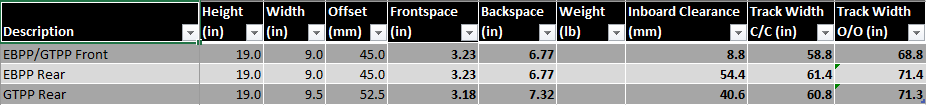

This shows the measurements of stock wheels for the Ecoboost Performance Pack (19x9 square) and GT Performance Pack (19x9F/19x9.5R). You will not have a problem using the 19x9 wheel in the rear.

The offsets are already accounted for.
Doing the math, when mounted on the rear, the outside edge of the 9" ET45 front wheel should only sit about 1mm farther out than the 9.5" 52.5mm rear wheel.
9" ET45 square wheels should work well for you.
