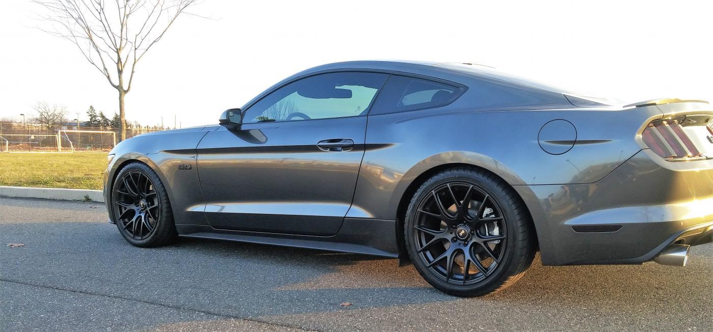

You will need a 5mm spacer up front and that's it. I've been daily driving this set up for over a year. No issues whatsoever.

You are correct
