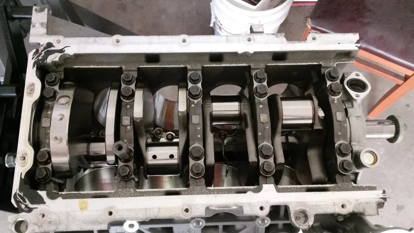

Is that an oil piston squirter I see there? I thought they took away those after the 12MY...
And here is the ugliness. #2, and 6.
I would also like add that oils ability to provide high levels of shear protection depends greatly on the additive packages in the oils as well.
