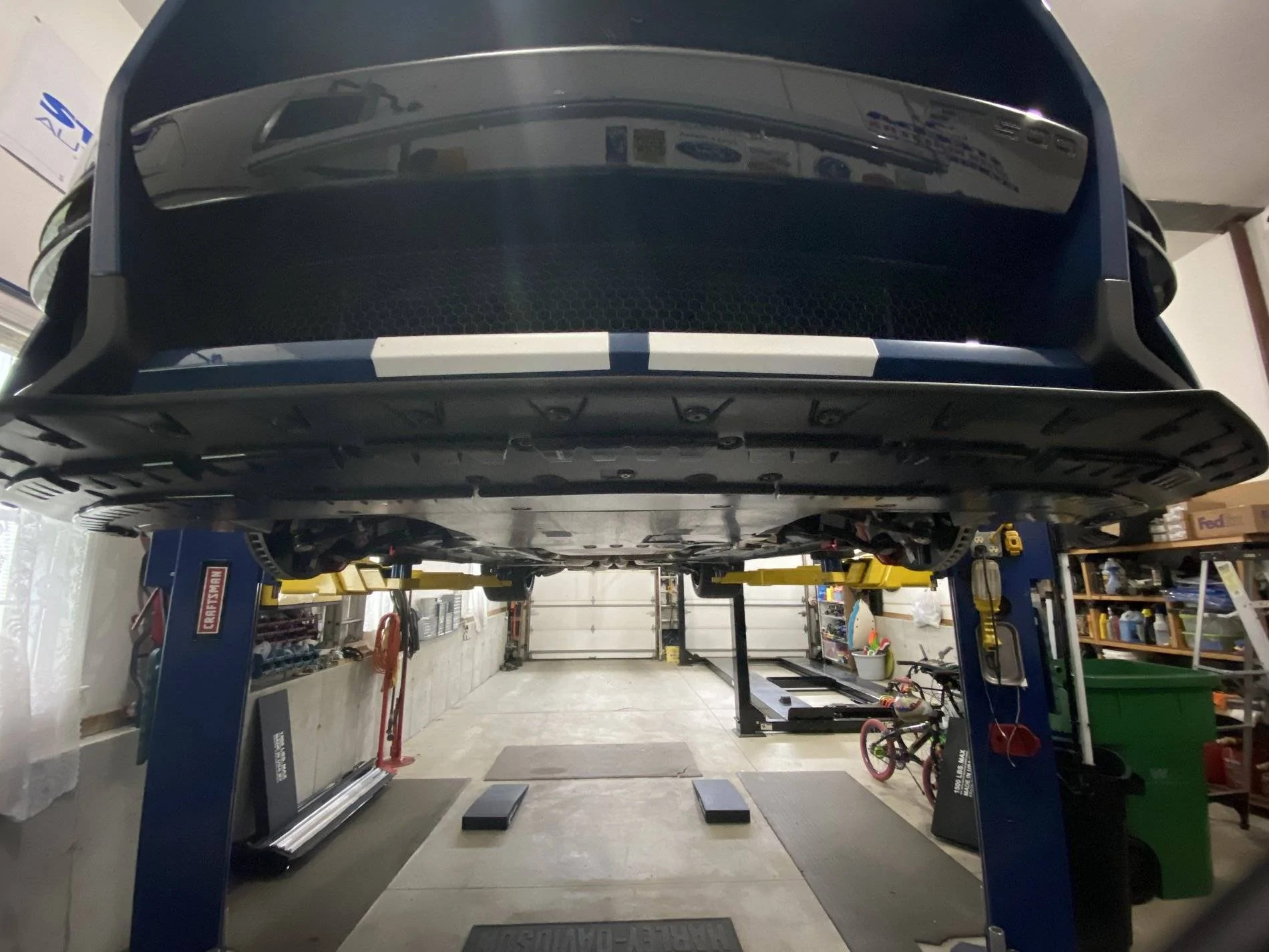

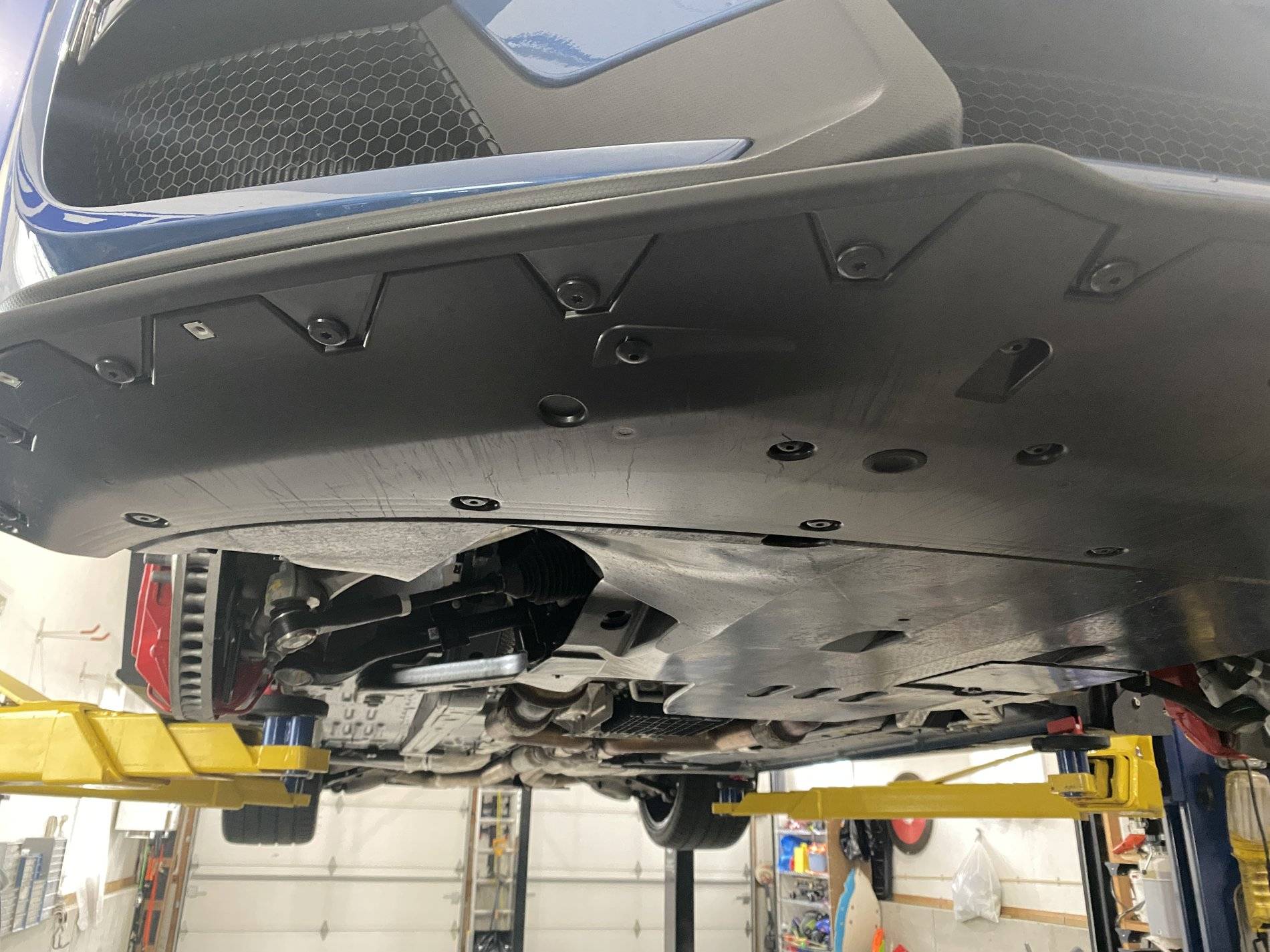

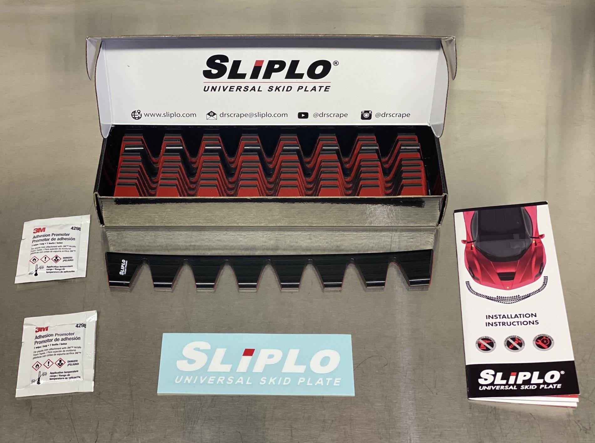

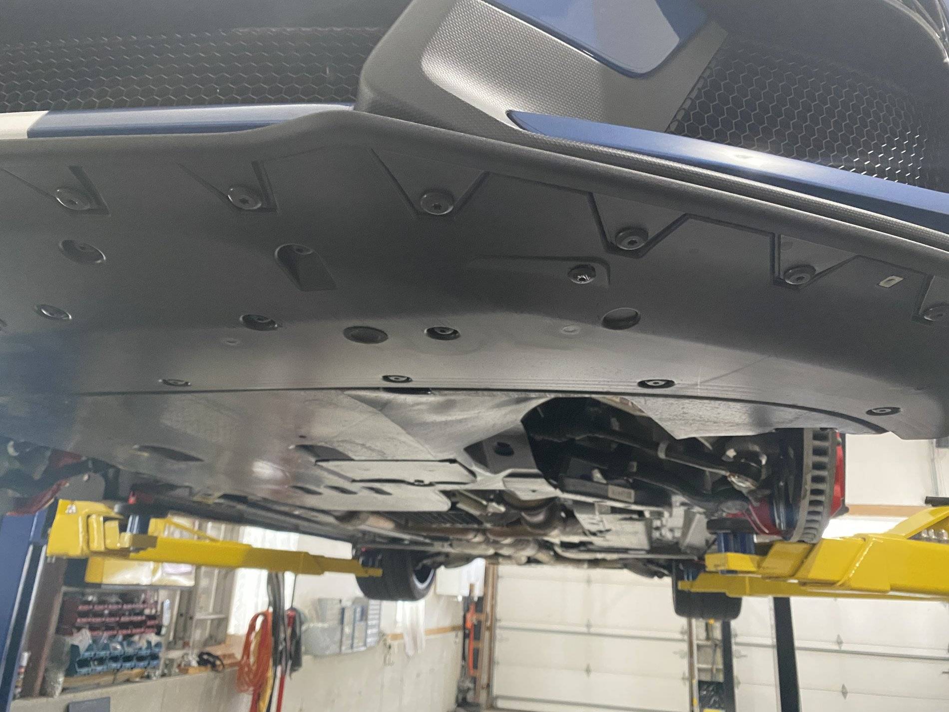

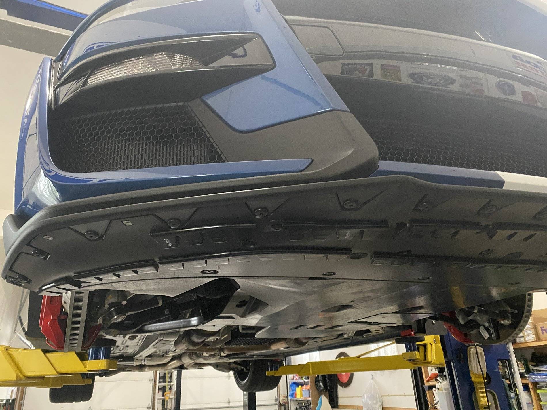

Today I installed some SlipLo scrape protectors on the under side of the splitter. I purchased these before Christmas, and had I installed them when I first got my car, I would not have damaged the splitter :facepalm: I thought I would make a post, incase others had not heard of them.
They are well designed, and come with (10) 8" strips that are flexible, and allow you to shape them how you want them. They come with adhesive promoter, but no alcohol wipes.

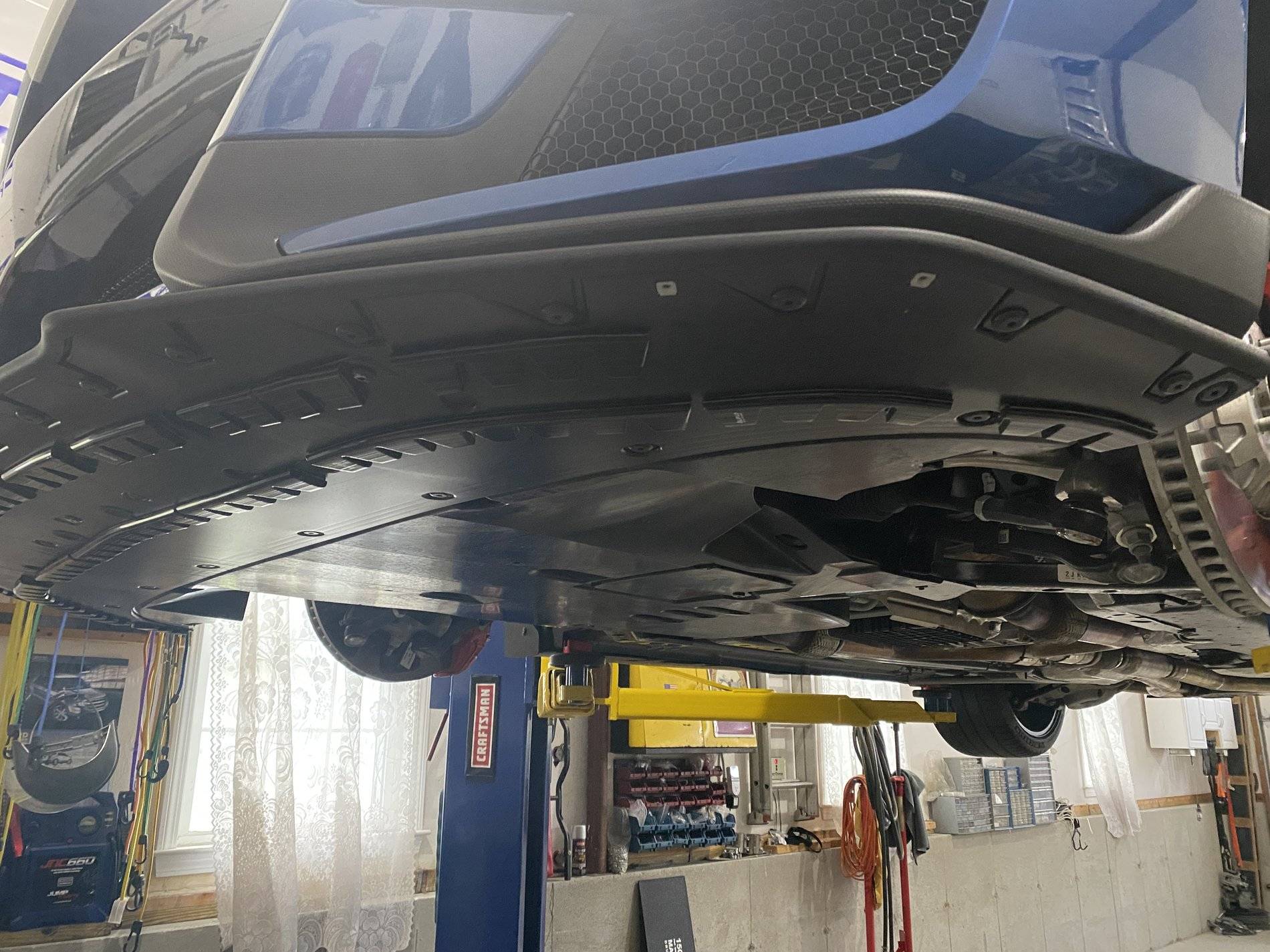

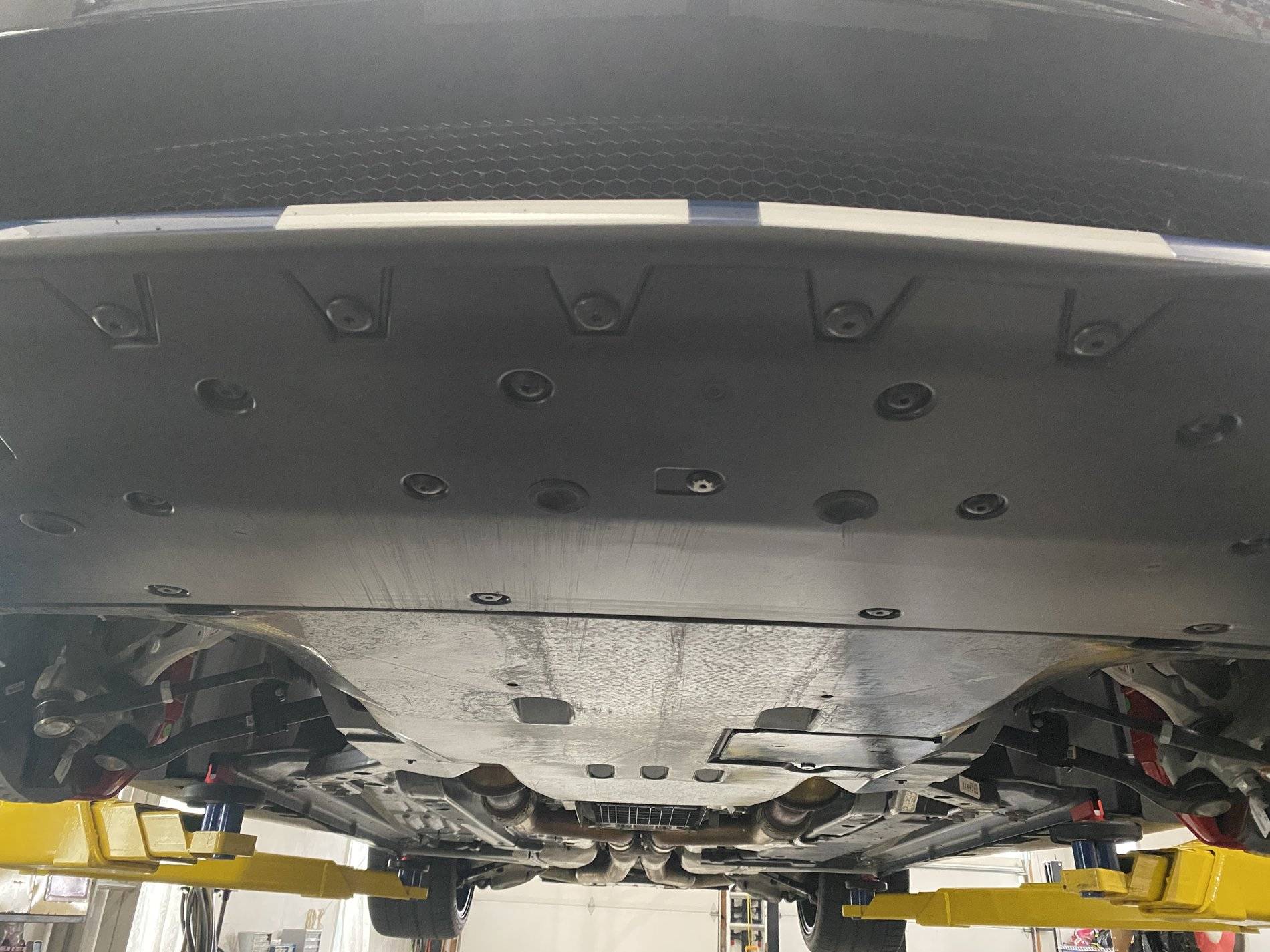

With only 600 miles, there are too many scuffs for my liking.

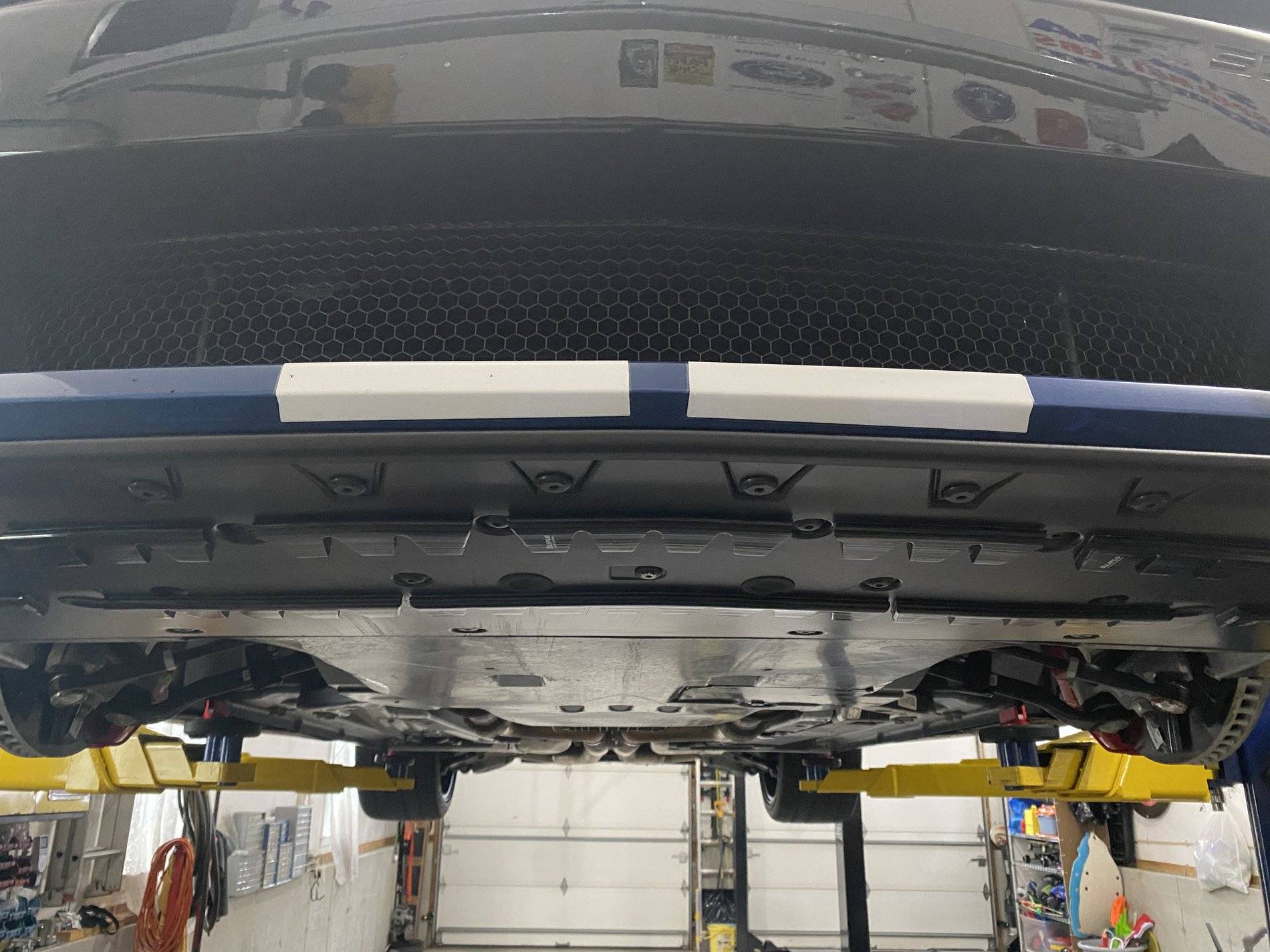

After some figuring, this is where I thought that I would get the best protection, and still allow me to take the splitter and wicker bills off, if needed.
I must say they are beefy, and easy to install. Try as I might, they will not budge, so I expect the to stay put.

The first three underneath pictures are the before, and the next three are after the install. I made two passes from left to right at what is noticeably the "high" spot, and where the scuffs my splitter suffered began.
I used all 10 pieces. Some of them I cut to stop before a fastener.
I only used one kit

I have pondered these. My only concern is that when you go in reverse these end up being a major snag point with the way they are cut. Looking forward to more updates
I think I know what your are thinking. I believe they will just slide over things in reverse in the same way as forward.
I'll keep you posted

It's working perfectly. This stuff is on there, ain't no way it will come off, and its super durable. I definitely recommend it.
