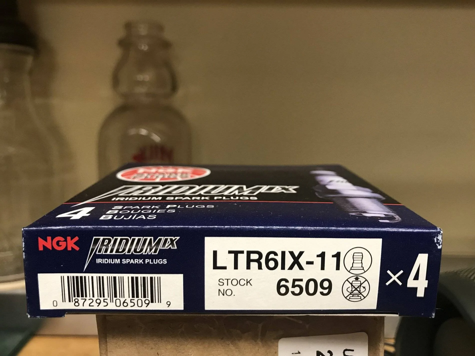

Trust me. But use the plug I posted.
K I'll buy those plugs, gap em to .037".. but 'trust me is relative' haha.

What was the final results with 93 & smaller gaps ?
IMO,
Low speed drivability.
Shorter cranking time to start.
Idle and low rpm smoothed out.
Honestly, you won’t know until you try. Results may vary but for the OP on the Sauce I’d go straight to closing up the gap with the plugs I listed.
Don’t close up the stock plugs. The LTR6IX-11 are gapped 11mm (.043) from NGK. Squeeze em down to .036”-.038”
