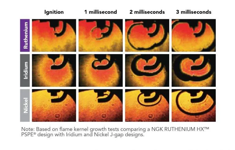

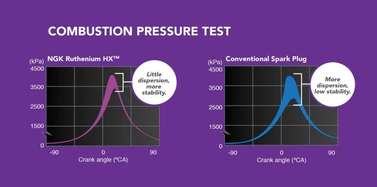

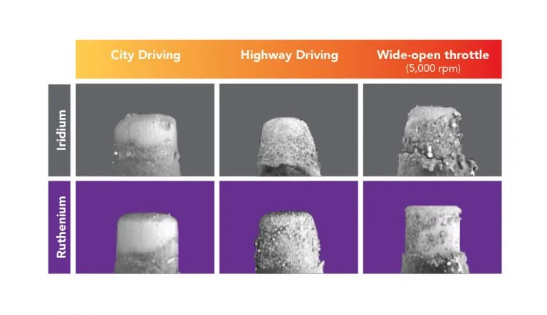

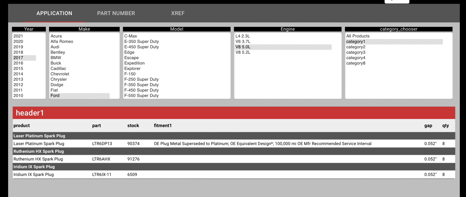

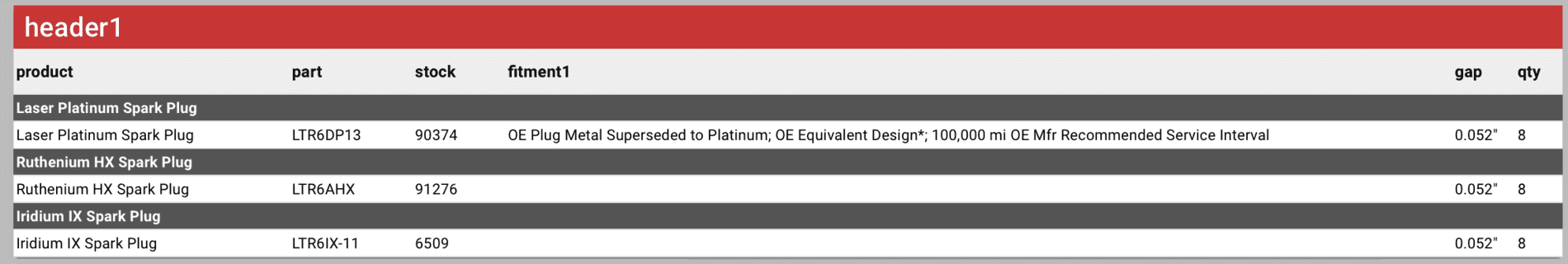

hop aboard the ruthenium train. chooo chooo. its ngk's newest plug design plug. they have a version for turbos, which im running in two cars, and a version for non turbo, which im running in one car. all 3 cars are running excellent.
EM20CARE at advanced auto parts, 20% off everything at moment. not sure how it puts pricing vs other plugs. may be small difference. but they are longest lasting plugs ngk offer now.
https://ngksparkplugs.com/en/products/ignition-parts/spark-plugs/ruthenium-spark-plugs
these are the NGK plugs for your car.

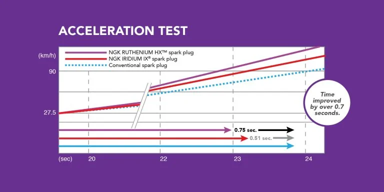

7/10 quicker acceleration ? Sound like the 90's are calling with those E3 plugs haha.
all I can tell ya, is it gave my other car 2mpg over what its ever had and have clocked 35-37 in my Mustang EcoBoost. before it was like 32-33mpg, better than new in all my cars, and my cars feel like they aren't even on. the little misfires on cold start in my mustang, they go away way quicker. the little denotation feeling shakes when I start up car.
a spark plug is a spark plug, but these bitches run damn good. here on out, its all im getting for my cars. all my cars. and supposedly the longest lasting plug NGK has now, increase the miles between changes to offset the price difference.
oh no. thats not how that graph reads. they are like 99% even, at 23 seconds the purple was there, and like a moment later red was behind it. so thats like 1% difference.
lets use 1/23rds for example. hx got there in 23 seconds, and the iridiums got there at 23/23rd and 1/8th. Lol confusing as fuck, but it is not claiming 30% faster.
edit, I have no idea how to fucking interpret this shit. I dumb.
