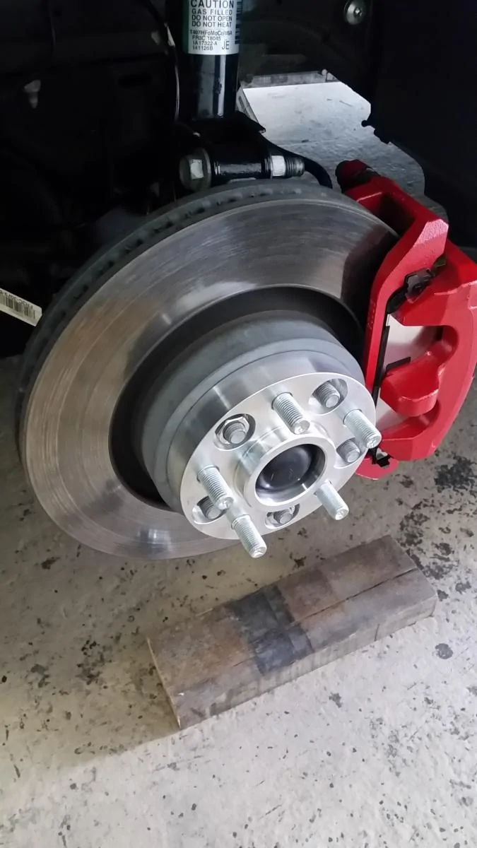

This looks perfect IMHO. Did you have to use longer studs?
Zakspeed
May 28, 2014
Tacoma,WA
2016 GT
They are bolt on style so no need for longer studs. Factory wheels have pockets on back so no need to cut the factory studs.
They are $245 for a set of 4.

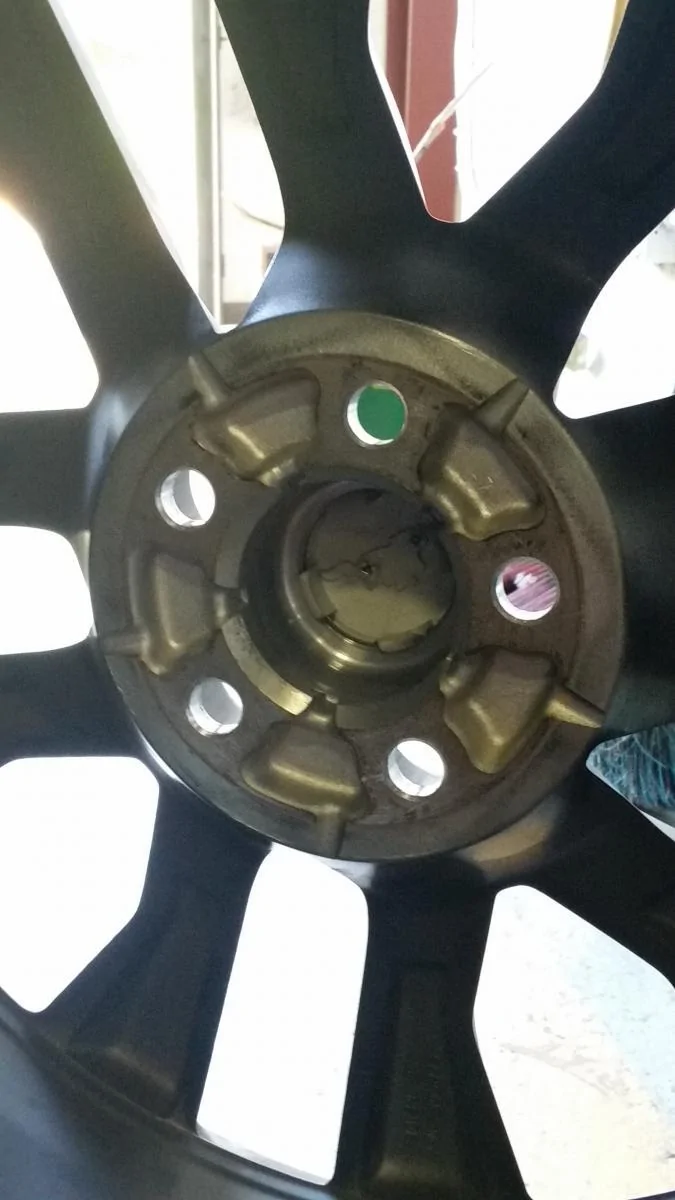

Do you have a picture of the inside of the stock 20" wheels? Some are saying it does not have pockets to accomodate the hub studs.

Inside picture of factory 20" wheel.

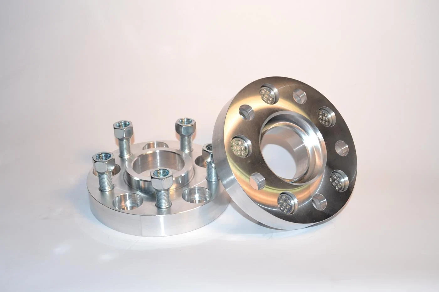

We are working on a set of 20mm.
These are made specifically for the mustang hub size so they are hub centered not just lug centric. If or when H&R releases a set they will be close to $300 for a set of 4. Be cautious of the cheap ones a lot of them are cast aluminium which is a no no for wheel spacers because they will crack.

What is the hub/bore size? Is it an aluminum/magnesium alloy? Will it also come anodized in different colors that would be cool. Will it come in different sizes 25/30mm, 1 inch/1.25 inch? Sorry for all the questions I am just really interested in getting one.
Zakspeed
May 28, 2014
Tacoma,WA
2016 GT
Bore 2.780" or 70.6mm
Hub 2.775" or 70.5m
Current material 6061-T6 round bar would like to do 7075 but probably too expensive for some
Anodized in clear, black, red, or blue
20mm and 25mm
Dorman grade 10.9 studs
