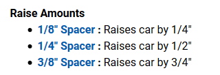

The springs don't contact the spacer. The top of the rear springs have a rubber seat that goes on top. The spacer goes between that rubber seat and the body perch.
Check the 2nd picture. https://www.steeda.com/steeda-s550-mustang-billet-rear-spring-spacer-3-8-inch-555-8250.html

Has anyone installed a spring spacer and didnt get the correct increase in height? I have all three steeda spacers, 1/8, 1/4, and 3/8. The 1/8 and 1/4 raised the rear properly by double but the 3/8 was short by 0.25 inches only raised 0.50 inches. Suggestions? Nothing wrong with install, double checked, and spacers measured out correctly and they are quality. Appreciate any thoughts.

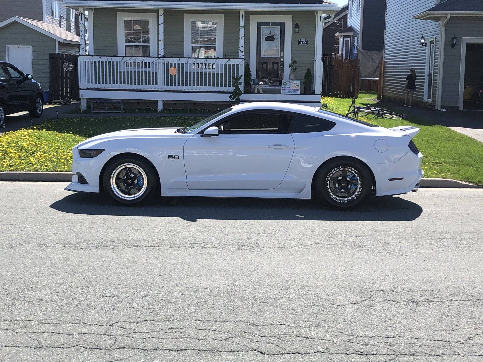

I have 305/45/17 ET Street R’s on the rear and 235/55/17 fronts on in that photo. Nothing rubs. My car hits the exhaust every so often. Hellion TT kit.
I have stock front struts and springs. In the rear I have BMR SP088R Drag springs and Viking Crusaders.
After this spacer is installed. I’m done with the rear end of the car. I am getting a drag spec front coilover this winter. Vikings or Steeda. I’ll adjust from there to make it to my liking.

I figured from the pic, I have 17s all around too. Same size tires in the rear but S/S. Dont know what year your car is, but the 18 Mustang I had to put smaller calipers in front to fit 17s, so I put Baer brakes. Awesome build you have going, especially with the TT kit.

My car is a Base 2015 GT. No issues with my brakes, but there is not much clearance between the wheel and caliper out front. Maybe 1/4” max. Lol. The car does work. I’ll be going E85 and throwing some power at it when racing opens back up. Car is a 6466 Hellion Kit. A2W and has a built engine and 6R80. It’s Dr. Jekyll and Mr. Hyde for sure.
