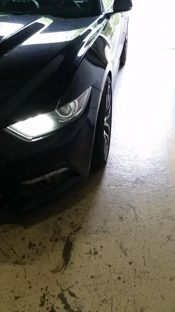

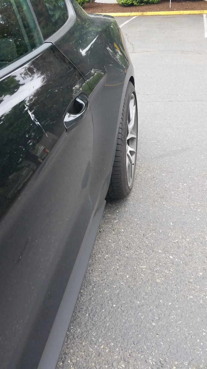

I have 1" spacers on the rears with 285 Invos sitting on sportlines.I'd like to see pics with spacers on PP wheels
Thanks
Please post pics!!! I'm very interested as I am thinking the same setup (20mm w/eibach).I am currently running a set of 20mm hubcentric spacers on the front of my car designed for S197 Mustangs. The only difference is that they have 1/2" by 20 thread studs.
