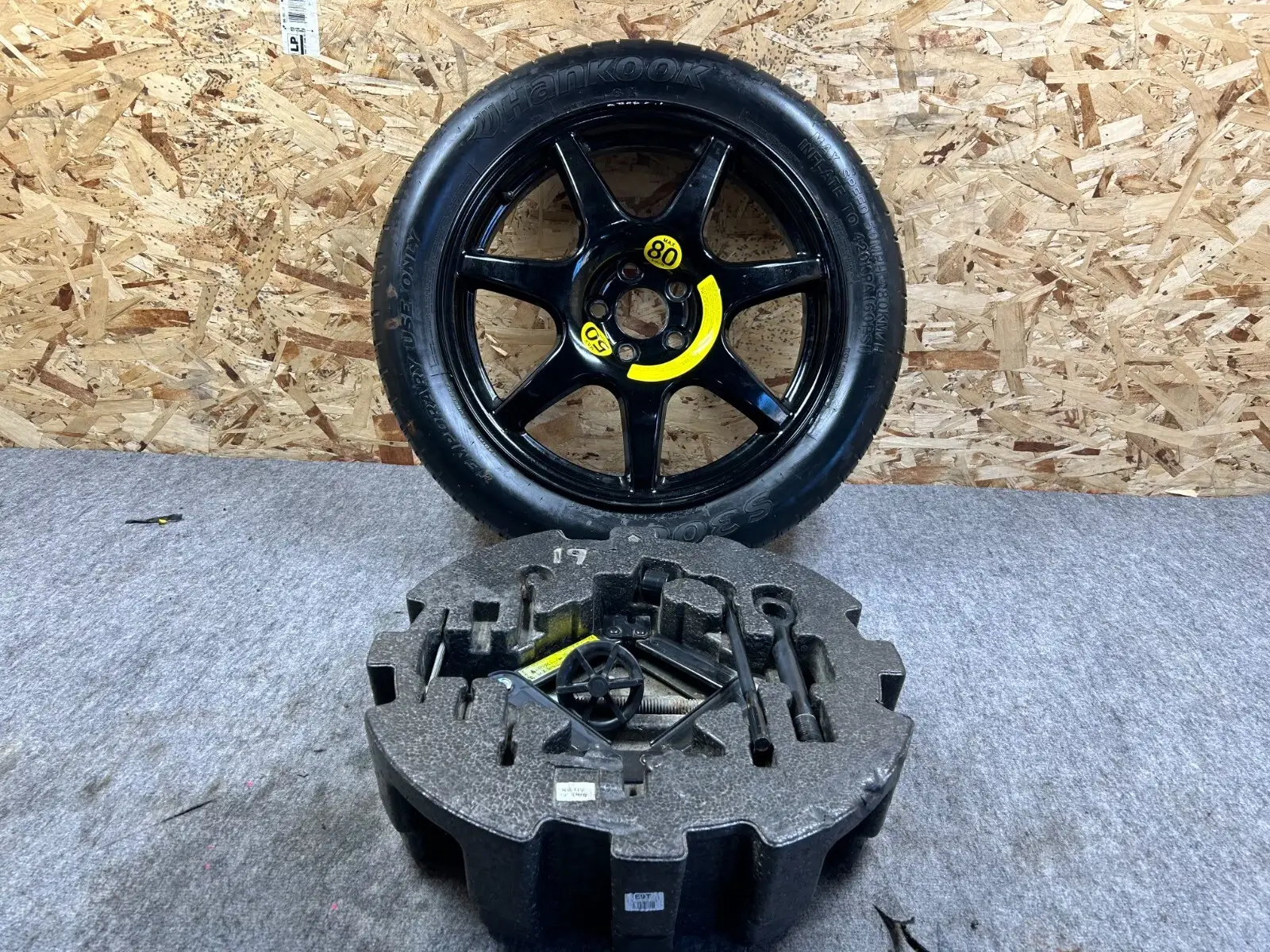

AA is a great option or..... If you're a cheapskate like me and want a dirt cheap option that functions the same, the Hyundai Ioniq and similar Korean SUV 19" aluminum spare tires (there are different temporary tire sizes that match Mach 1 vs GT PPP1 diameters) fit perfectly once you slightly enlarge the hub register diameter with a piloted hole saw and purchase appropriate lug nuts. The smaller diameter Mach 1 spare size fits fine in the trunk well but the larger diameter GT PP1 tire size spare requires partially deflating the spare if you want it to nest into the tire well. Skinny front drag wheels with properly sized tires also work but it's very pricy.

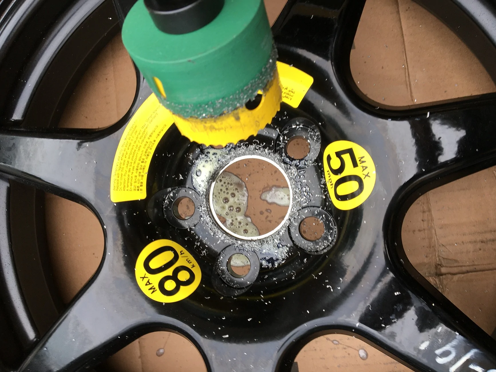

To clarify, here's all that's required for the DIY option to enlarge the Korean SUV spare tire options that will fit Brembo equipped Mustangs, one hole saw to pilot on the existing hole diameter and the cutting hole saw to match the mustang pilot diameter. Tolerancing is spot on plus the flanged lug nuts (Toyota) that are also required for the Korean wheels will insure proper piloting if you're really sloppy with your hole cutting. If you don't have access plentiful junk yards, there's always on-line resources.
Spare Tire 19x4 Alloy Complete With Jack Kit OEM 15 16 17 Kia K900

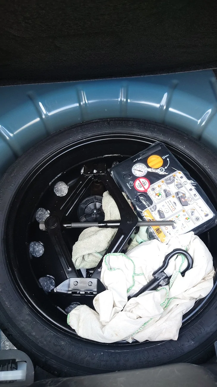

The wheel has arrived and Rachel has not charged me for the privilege.
And here it is installed with the jack and some disposable overalls. Hopefully I will never need it.
I have even managed to fit the air pump in there.

That's awesome. Gonna pull the trigger and hope I dont get unlucky with customs.
Have you actually tried it on the vehicle?
