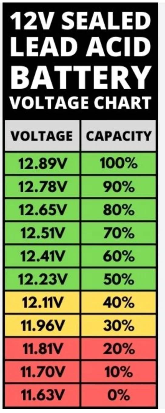

My wife and I went for a nice summer drive,and drove just over one hundred miles . Last night on ford app it had a warning in deep sleep mode. I find that odd after driving that far with no issues . This morning I went to the garage she started right up no problem. The voltage gauge showed 14.5 v running , I turned it off and with it not running it showed 12.5 voltage! I got my voltage meter it also showed 12.5 v my car is a 2021 gt convertible with just over 5000 miles .Is the battery going bad ? Is a battery covered under the 3/36 warranty? I have read that the battery are not very good! What would you do? Is the car safe to drive reliabley

When did you check battery voltage with a meter? Immediately after shutting it off? If so you were reading "surface voltage" which is not a true indication of battery condition. Next time turn the lights on for 19 seconds or so then check the voltage. Then compare it to the attached chart.
Also, with the car running you're not reading battery voltage but the alternator/charge/system voltage.
To get a better idea of battery condition any major chain auto parts store will load test it for free.
And finally, of course the car is safe. The absolute worst that could happen is the battery could completely fail while out. But that's extremely unlikely without it displaying much more severe symptoms first.
In any case a AAA membership and/or a small jump pack in the trunk is almost always a good idea.
