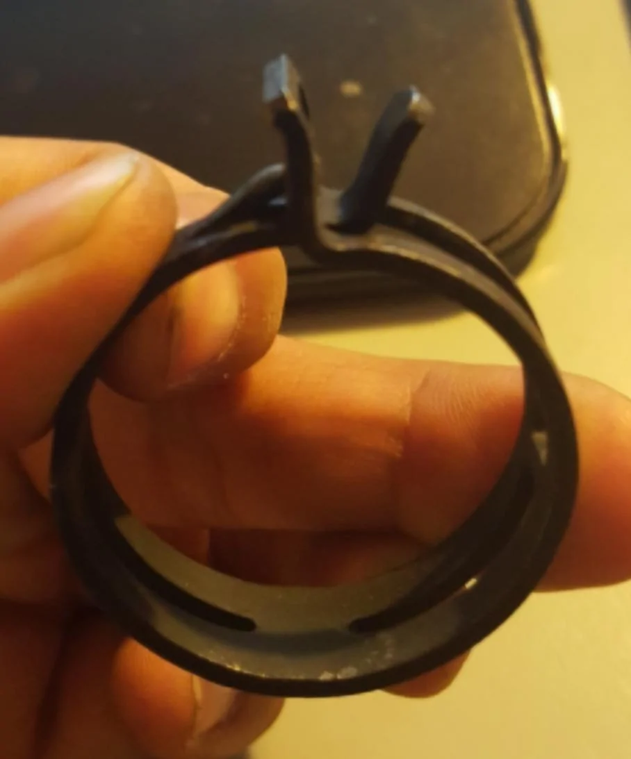

The clamp has no tension now. Is there a special tool to put it back into place

It's locked open, push down on the little tab holding it open.

Push down with a screwdriver! That shit will pop your finger quite hard! LOL

Getting your fingernail snapped with one of those is akin to stubbing your pinky toe
