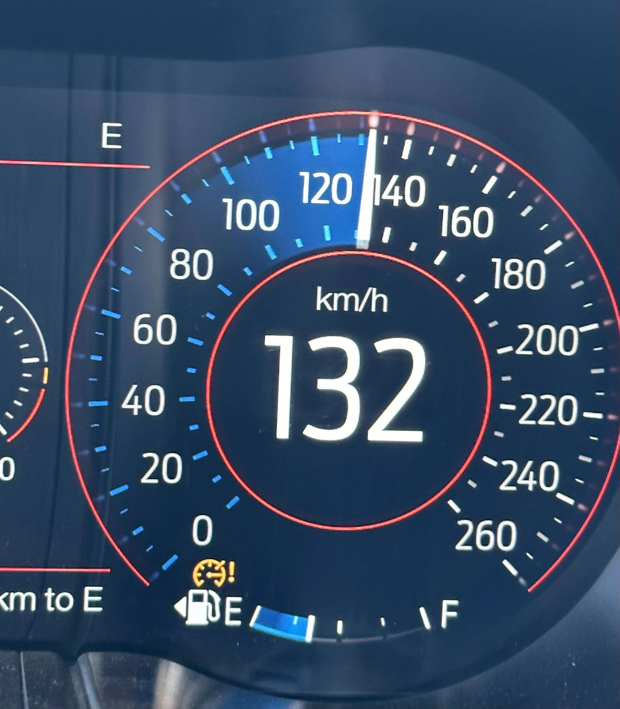

My 2021 Mustang (Middle East Version) has an overspeed warning light that comes on whenever I hit 120 km/h and it has a faint chime when it comes on. It doesn’t disappear until the speedometer reads below 120 kmh. Can I turn this setting off using forscan? If so, what should I change in it?
Here is a picture of what it looks like:
When I had a 2013 mustang back in the US, it did not have this feature and I think that even 2018+ (US version) don’t have it as well.

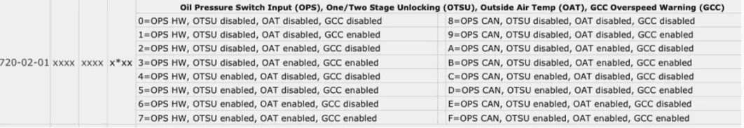

Found this on a F-150 forum :
I can't find the GCC (Gulf Cooperative Council) Overspeed feature in my Mustang Forscan code list, but the others mentionned here are at the same spot (i.e. 720-02-01 bit 0-1-2) so I guess it's worth a try !

Thanks a lot! I’ll give it a shot and see what happens.

SOLVED: Found it in IPC. Disabled it and now it’s gone. Thanks for your help.

Unfortunately I don’t have a video of it nor I could’ve found one online. But it was only a DING and it’s gone, but the overspeed light still remains on.
