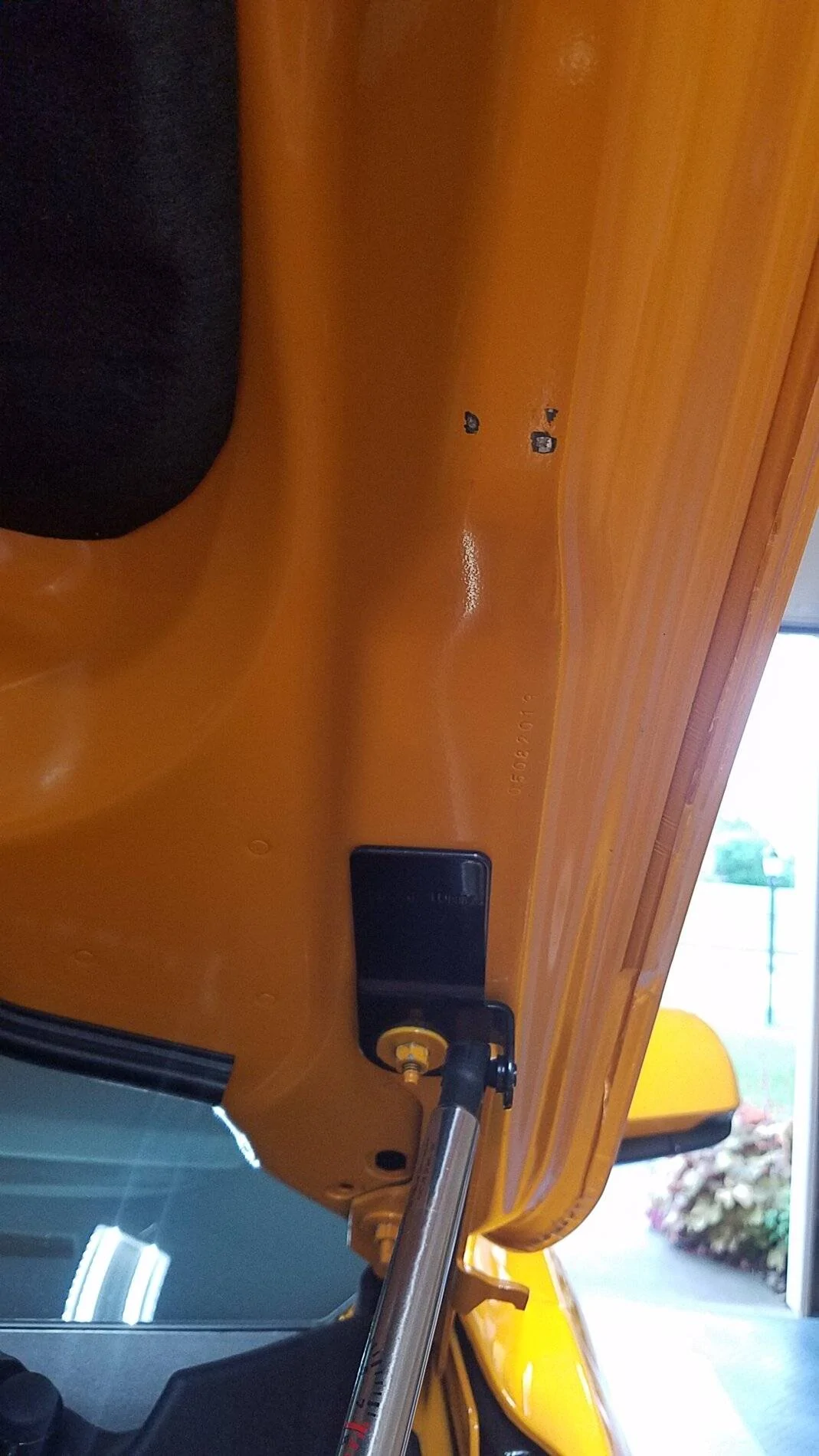

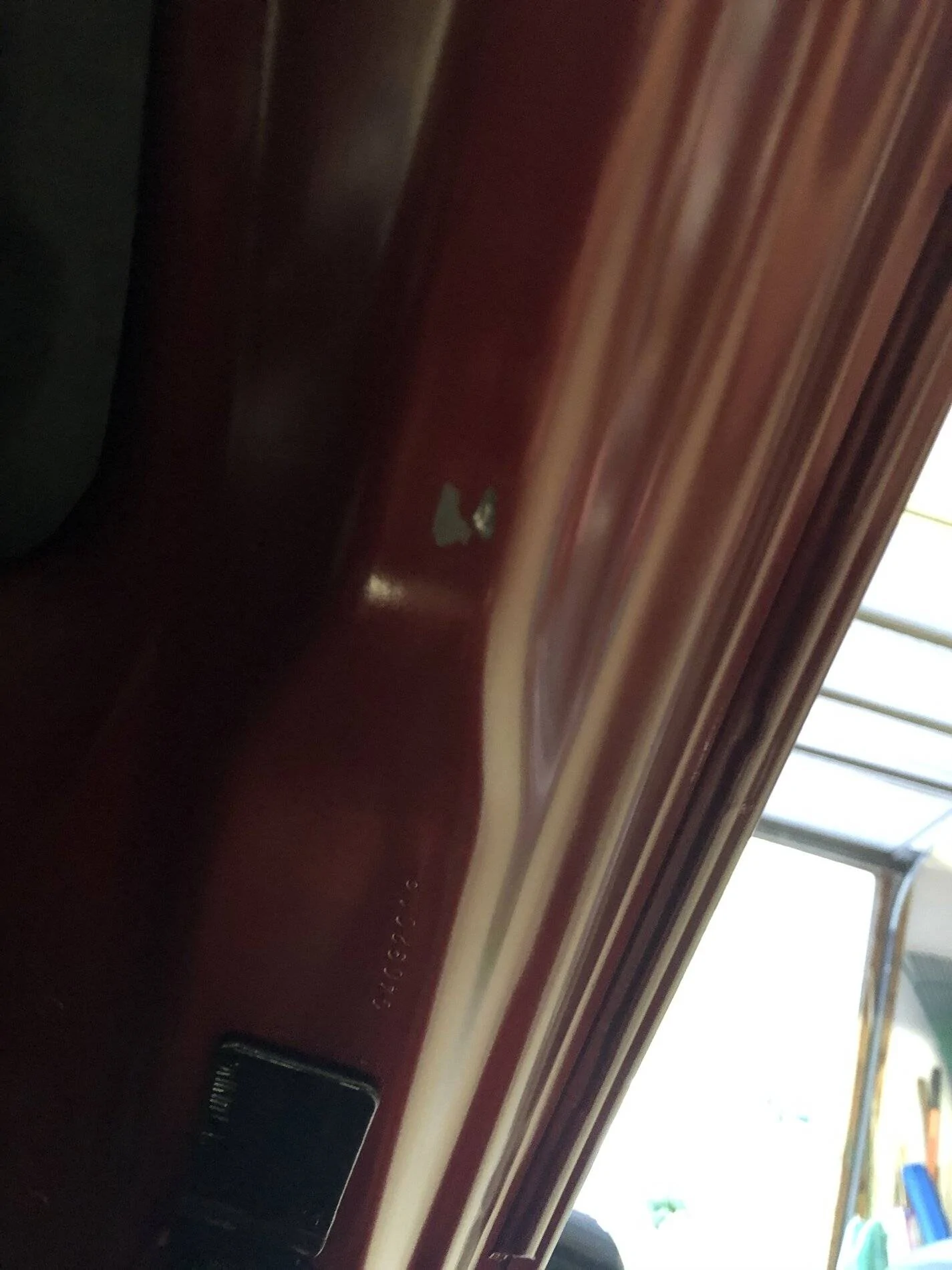

Here you see the dual rub marks on the hood, caused by the bay bracket and the strut end.

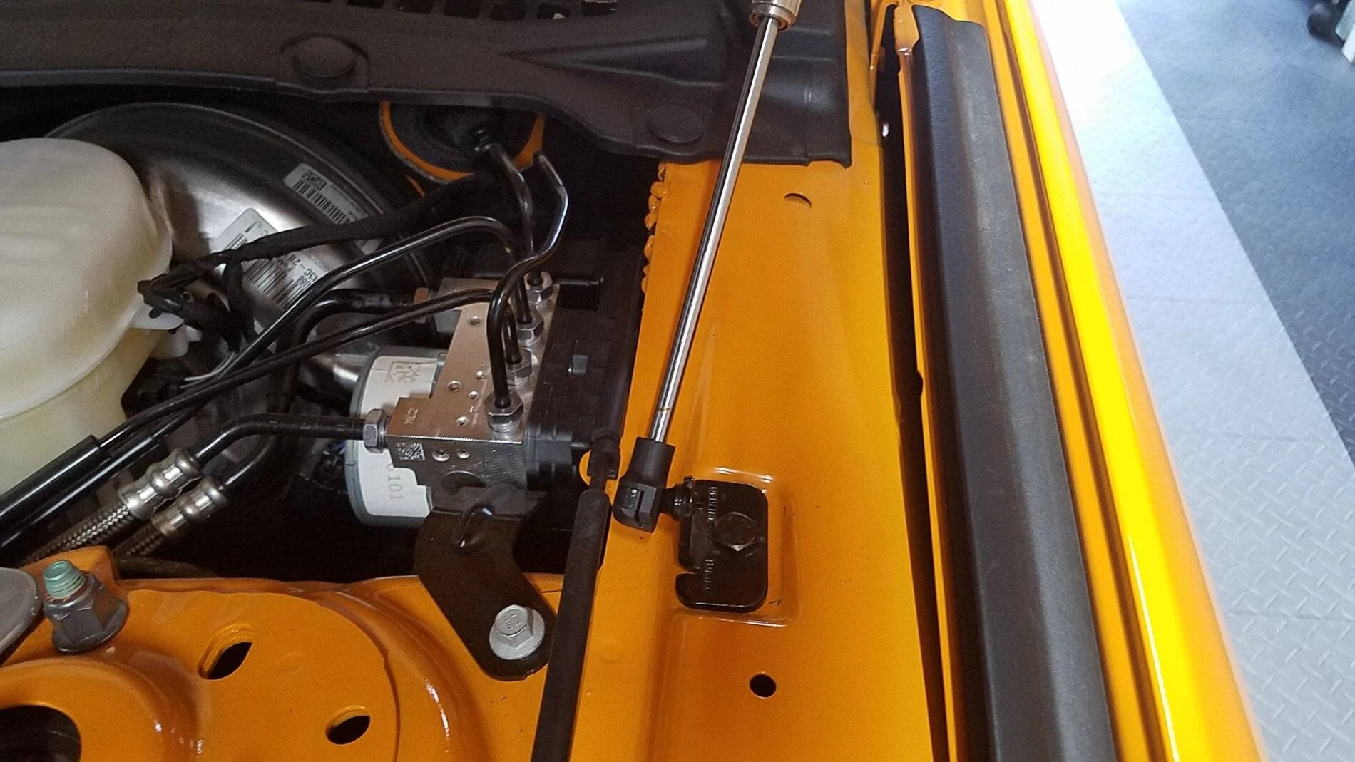

Here is the bracket rotated 180, to provide more clearance with the hood. The strut still operates fine.

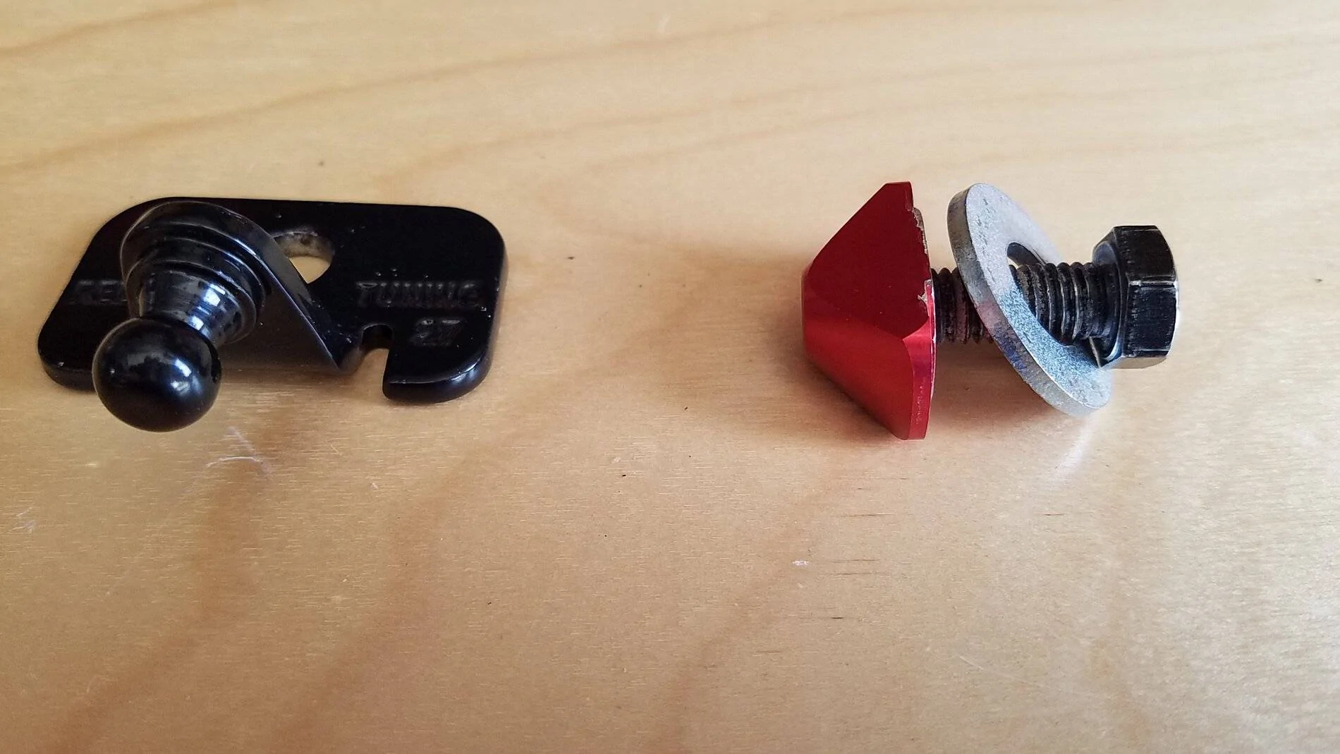

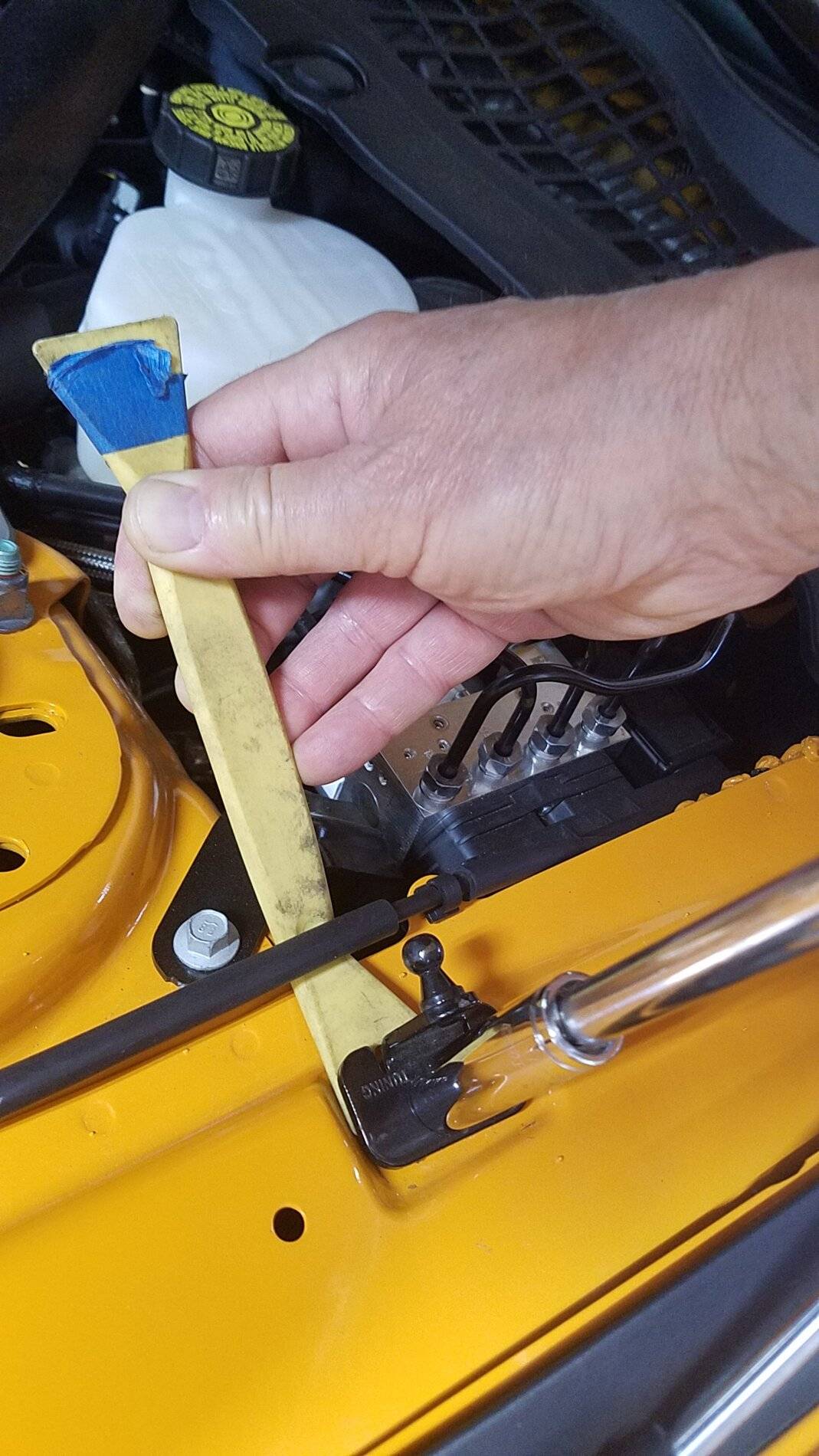

This photo just shows a technique (imperfect) used to help hold the aluminum insert up against the oval hole during loosening/tightening.

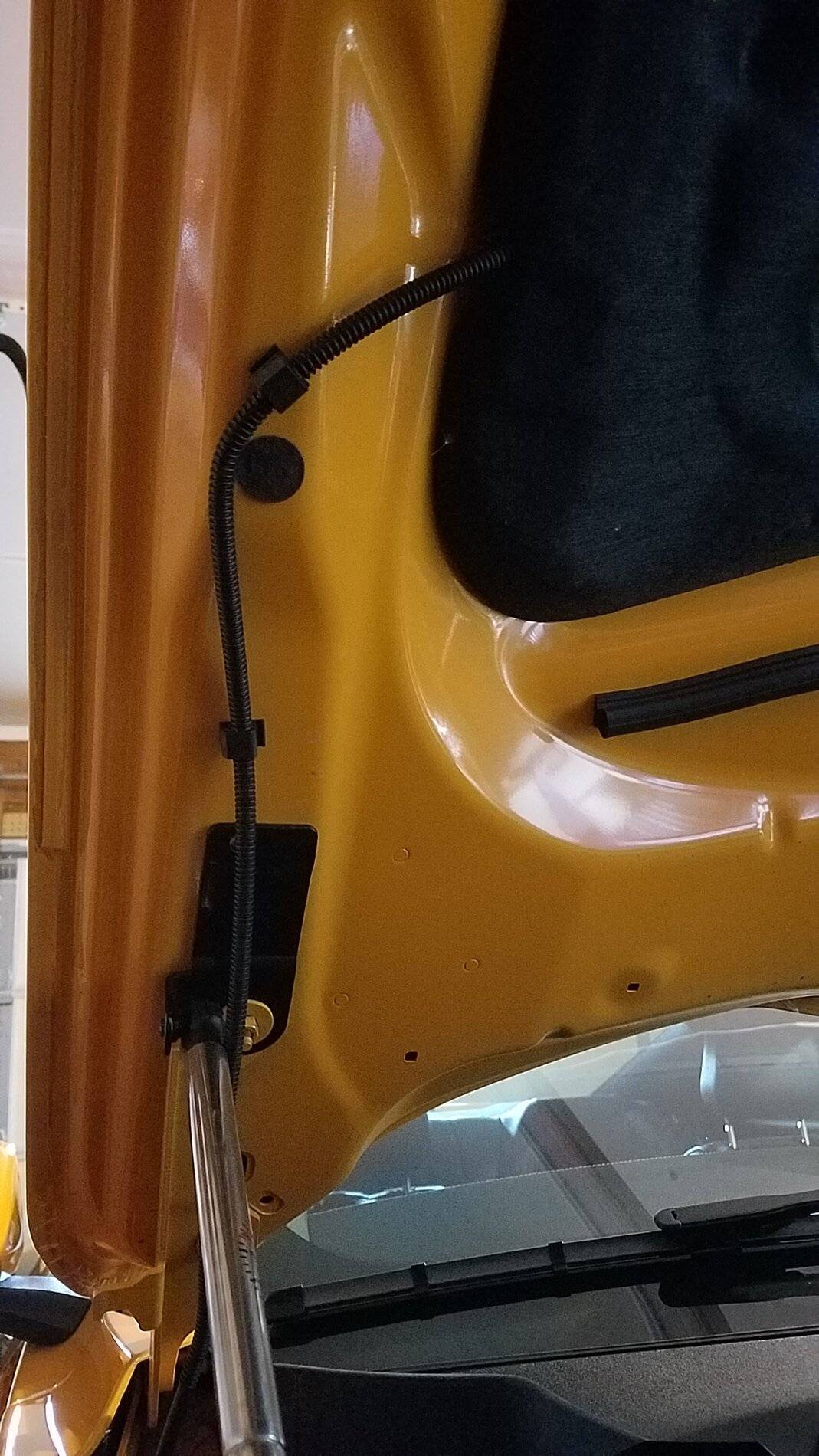

Felt pad used at passenger side. Perhaps I should have just used this at both sides, but I know that it will get rubbed through eventually and have to be replaced.

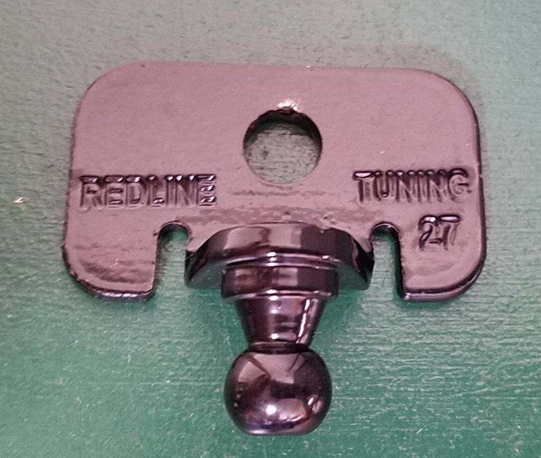

I contacted Redline. They told me that they updated the lower bracket design, and made it as short as possible for added clearance on the 2018+. The new design has "27" stamped in one corner. The ball looks to be 3mm lower.

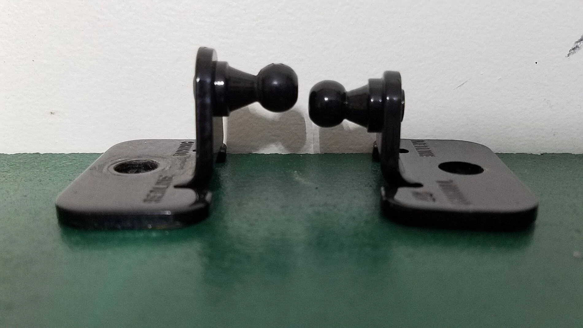

New bracket has "27" on it.
New bracket is 3mm lower.

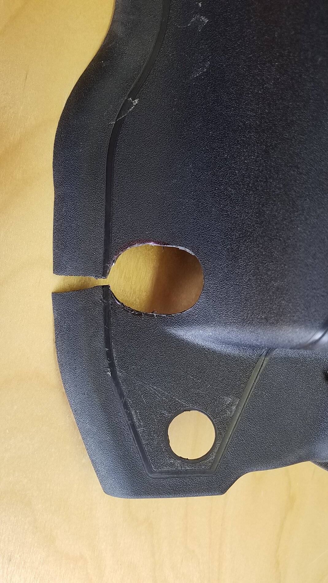

Stout washer used to flatten out the distorted oval holes in my engine bay. I just tightened down the washer and red part until bottomed. Hole was then level again.
Battery cover hole opened up for more clearance with the new lower bracket.
