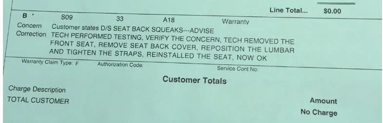

Does anyone have this issue? My Driver seat is creaking in the middle back area when your sitting or if you push on it.
I was hoping if someone fixed this it was an easy fix; hate to have the dealer pull this apart. They treat these cars like they work for Chevy.
Thanks.
