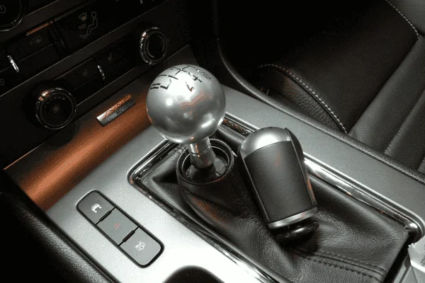

So, after I posted this I took the car for a drive to air it out (my daughter barfed in the back seat last night... 😭😭😭) and the amount of vibration with the "thumb" is almost not there versus the carbon fiber bowling ball that was on there. I didn't get a chance to let it cruise for a bit on the highway, which is where the NVH really shows itself in sixth gear, but I think a lot of it was literally the weight of the ball.
I forgot to do this before swapping knobs, but I asked my wife to compare the weights of the factory aluminum 401A knob from my '12 to the bowling ball, just to check my sanity, and the 401A knob was lighter. I remember the "thumb" being much lighter than either.
Not my picture, but the two actual Ford knobs in question.
