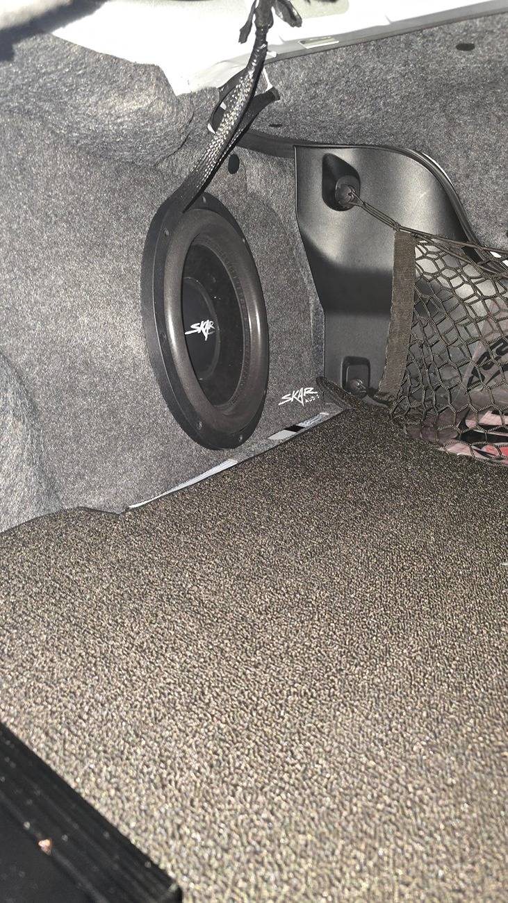

The Skar enclosure is really nice. Trying to mount it to the existing holes is pretty difficult. There are no holes in the bottom. Just the push pin hole on top.

Sounds incredible, I'd say its 2 to 3x more powerful then the oem sub and significantly better sounding.
Thanks for the pics and feedback!
I notice the enclosure doesnt match the OE enclosure's footprint, leaving a bit of bare metal floor exposed. That's nitpicking though, easy enough to remedy.

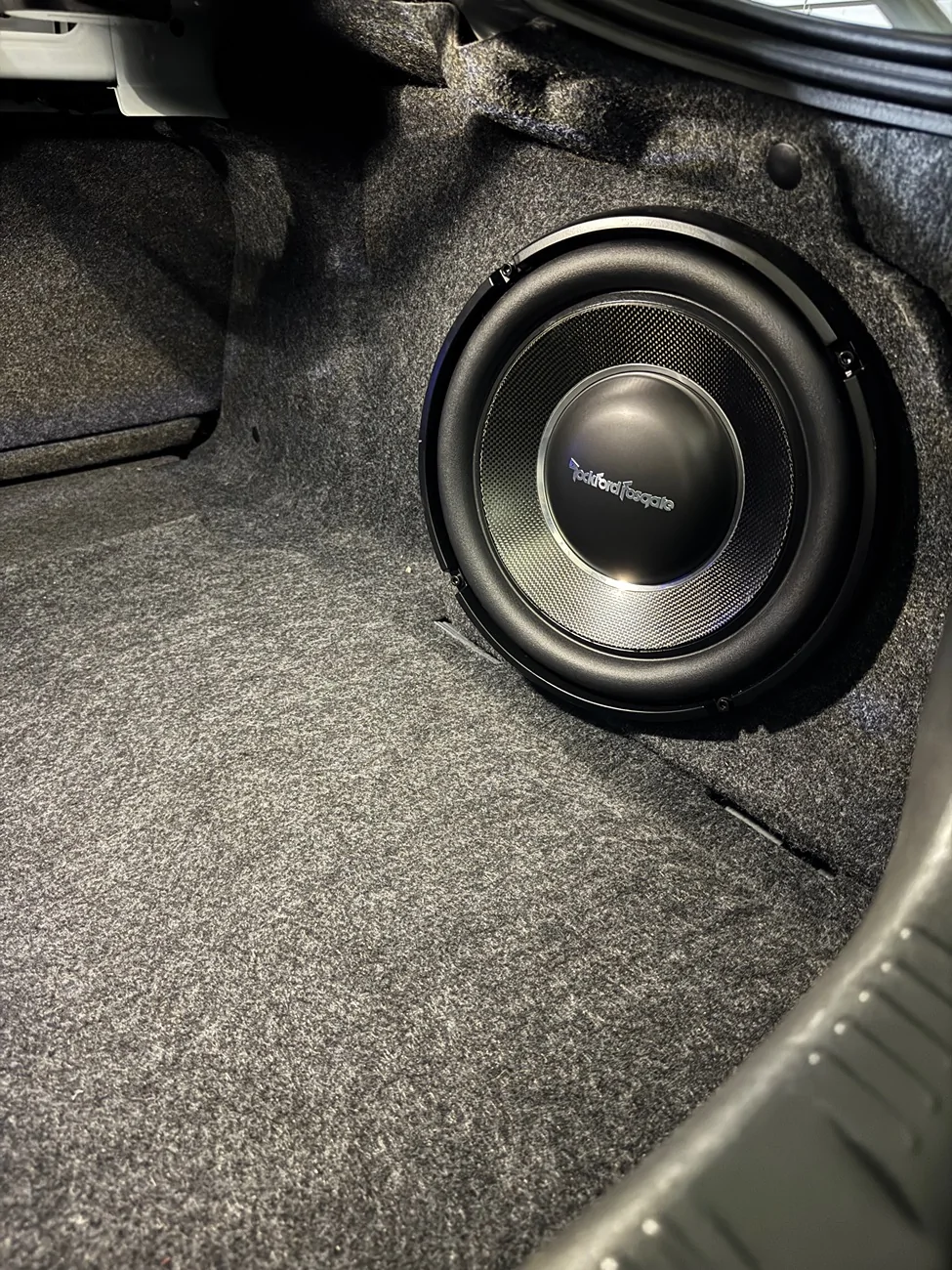

Since this thread came back up, I figured I should post an update. Ended up buying it in the unloaded version. I installed a Rockford P3 12ā€ which barely fit. I had to remove the rubber ring off of the back of the magnet and file the hole a little larger to get it to go, but I got it in there. The loaded enclosure is a snug fit and it doesn’t seem to be able to move around. It did well, looks like it belongs there, and sounds good. I think it’s a great option for the price. I wasn’t looking for massive bass, so if that’s your priority, there’s probably better options for you. A bigger 12 tha would handle huge power most likely wouldn’t fit. Overall, I’m happy with it.

Sorry, that’s what I meant- how is it with the Rockford in it? Does the volume match the recommendation from Rockford? Seeing as you had to slightly modify to get it to fit, I thought it might not be the best driver for the enclosure, but the actual performance will be the final say.

I forget what the recommended enclosure volume was for that woofer, but the enclose volume was within the recommended range. It was the physical size and depth of the magnet that was the issue with the fit.
I’m happy with the sound. It is pretty tight and accurate, but has good low end extension. With the cabin gain, there is plenty of energy down to 20hz with minimal eq needed. I am driving it with an Arc Audio 5 channel amp, so the single sub channel is 500W. I am also using an Arc Audio. DSP for tuning, but again, the sub didn’t need much in the way of correction.
