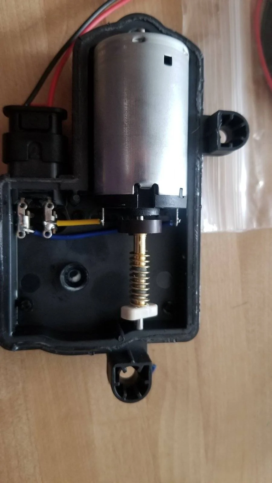

The First thing I did was crack the motors open to figure out what was inside, it's basically a microcontroller communicating on a LIN network similar to can bus but only 1 wire. There was no way i was going to crack this code. I also wasn't about to pay $300 for a wireless on off remote that the volkswagen guys have (which is compatible with the stock valves)
So I made the valves dumb valves. Gutted the boards and soldered wires directly from the motor to the pins. I opened them up with a sharp exacto knife, it takes a while but it will work and give you the cleanest job, I used some super glue to hold the halves back together. Then used some high temp silicone sealant. I'm not too worried about moisture since it is just a simple DC motor in there now

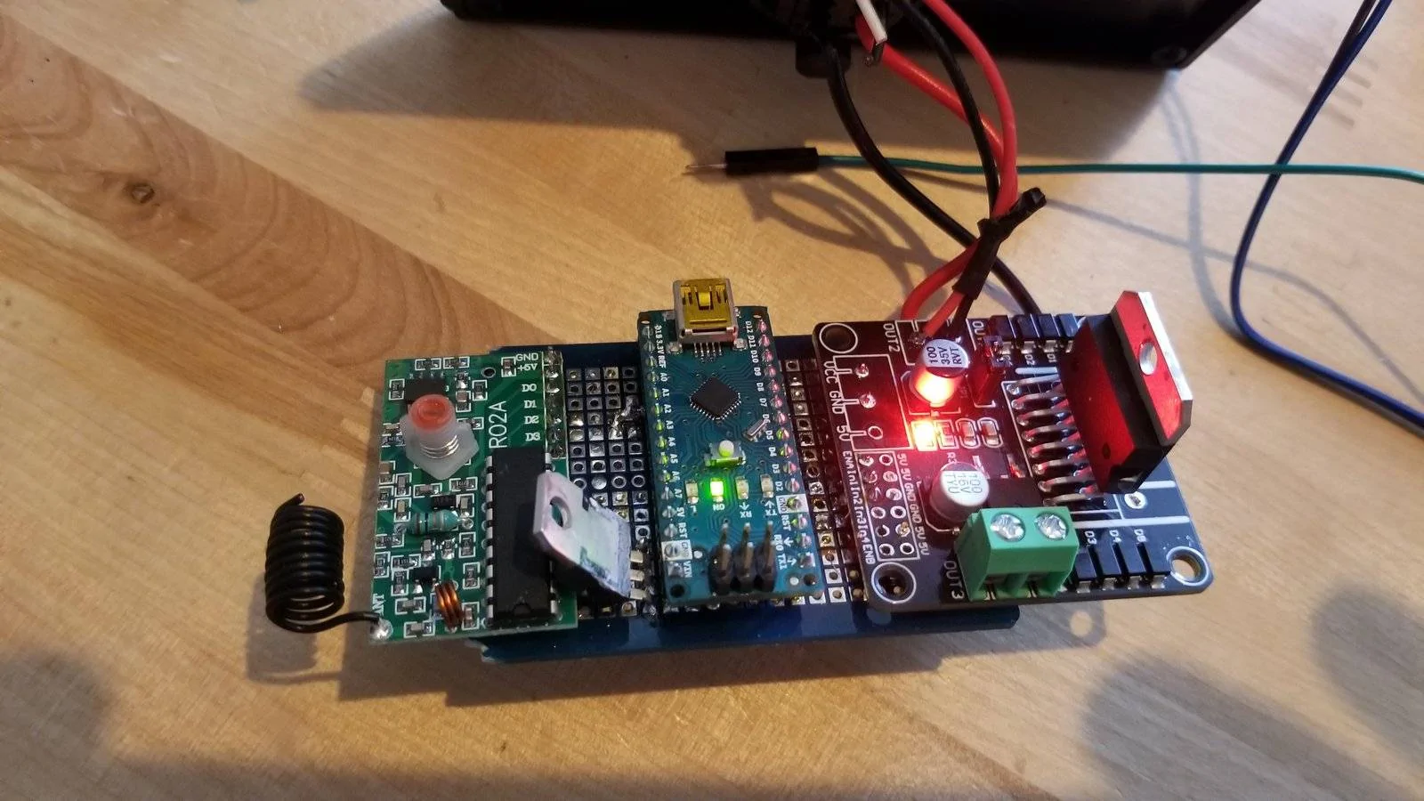

Next step make a prototype controller.
Parts list:
Arduino Nano - https://www.banggood.com/Geekcreit-...d-p-940937.html?rmmds=search&cur_warehouse=CN
L298N H bridge( Likely over kill) - https://www.banggood.com/Wholesale-...rd-p-42826.html?rmmds=search&cur_warehouse=CN
315MHZ M4 receiver - https://www.adafruit.com/product/1096
Single button Fob - https://www.adafruit.com/product/1392
LM7805 5V Linear regulator
MX150 Female 8 position connector - Digikey
MX150 Male panel mount 8 position connector - digikey
and a generic bread board to put them together.

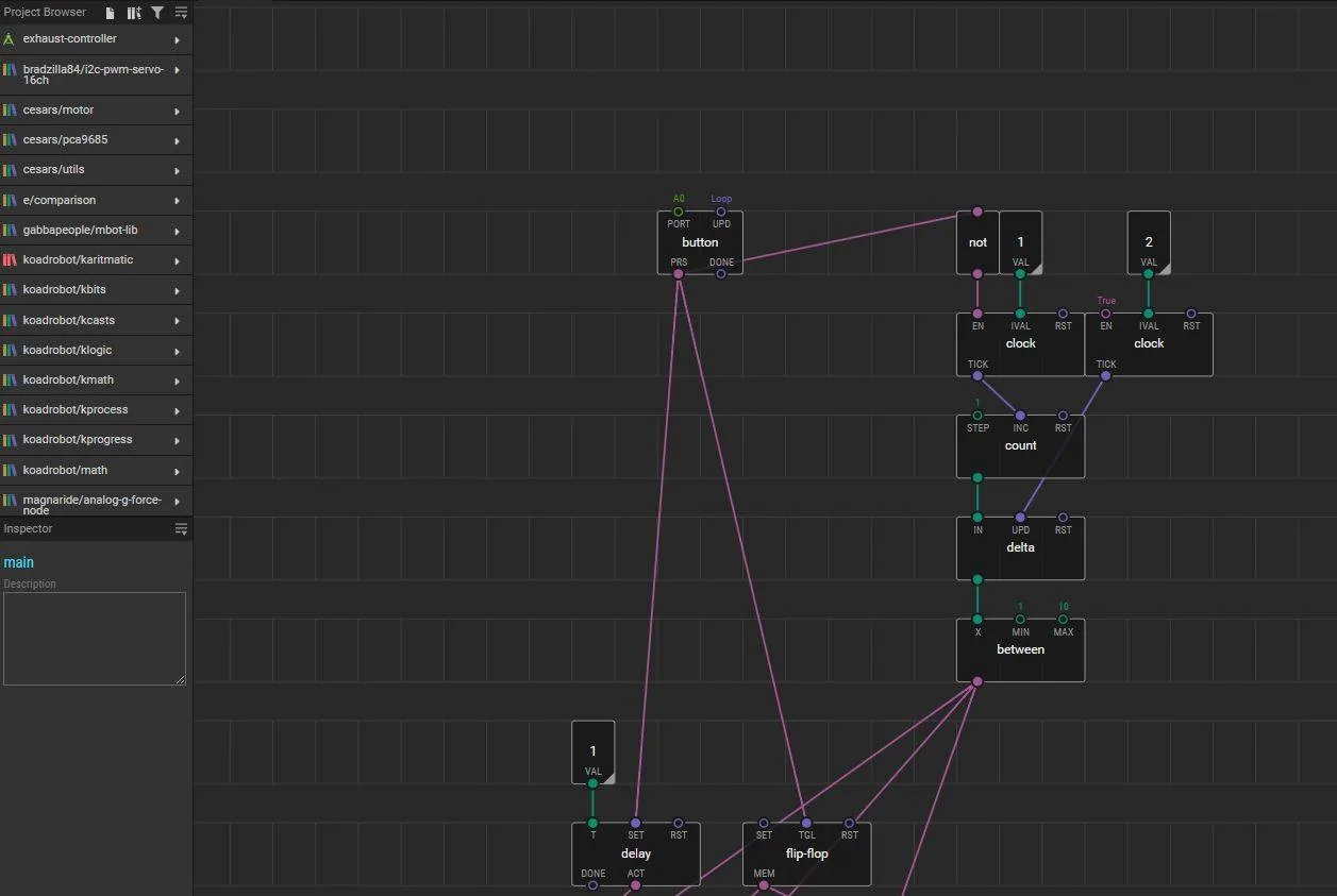

Added a wee bit of code using a program called XOD the valves are opened with a 40% duty cycle and 1 second to open, a 40% duty cycle prevents the valves from snapping open and closed potentially damaging the spring that attaches to the valve. website - https://xod.io/

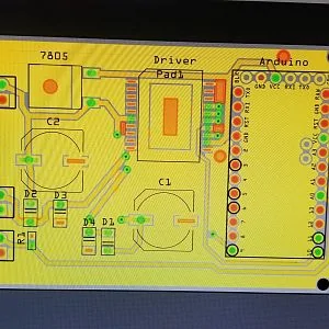

Now that I know all these components work together and the code works I have designed a PCB that will let me mount everything into a smaller frame and even smaller box. new PCB will allow Throttle to open it during Wot and possibly add a 2 button remote to have a 50% open version but i don't think it will be consistent due to no position tracking

the button has 2 functions currently press quickly will cycle the valves open or closed. holding the button will allow you to find "home" when you put them on for the first time.
Also every time the car powers up the valves close, which is nice for those 5am starts going to work.

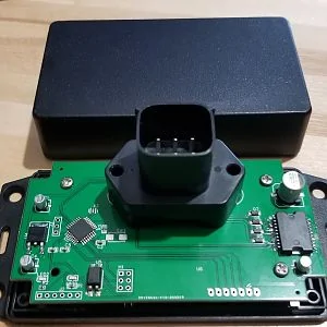

And the Final Version!!
Super excited about this, I created the PCB from scratch and here is the final version.
Designed to fit into a generic off the shelf case with a Sealed molex connector I could mount this thing under the car since it is completely water sealed.
I also added my Throttle input into this board! I can now have it open the exhaust anytime I am Full throttle. I am beyond hyped over this.
I do have 4 extra controllers and would sell them for very little money, 1 board has 95% of the components on it the other 3 would have to be built as in solder the components on.
If there is any interest i'll put a kit together for this.
