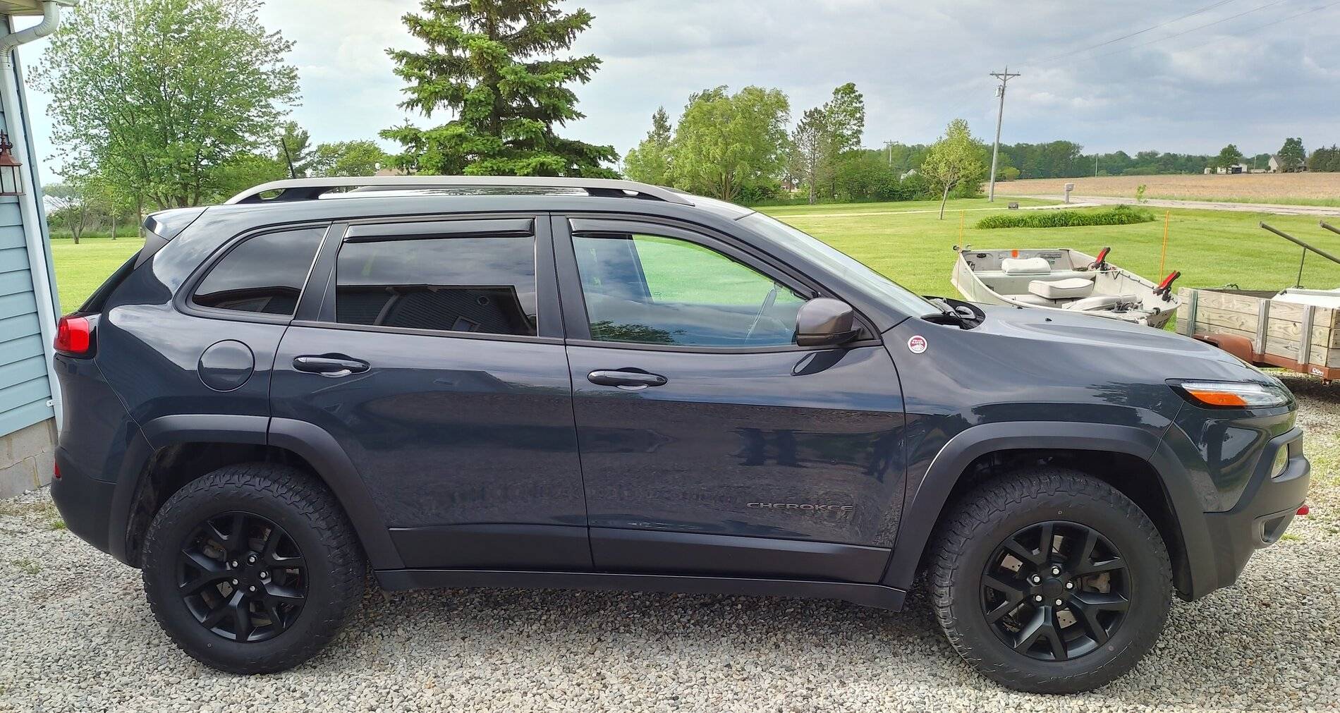

Spent some time Sunday detailing the wife's Jeep Cherokee Trailhawk. It's 5 years old and the plastic didn't look bad but wanted to try Car Guy's Plastic Restorer. The plastic looks new again. It was faded more than I would have ever thought. I'm also liking this Turtle Wax Hybrid. Anyone have a reasonable suggestion for tire dressing?

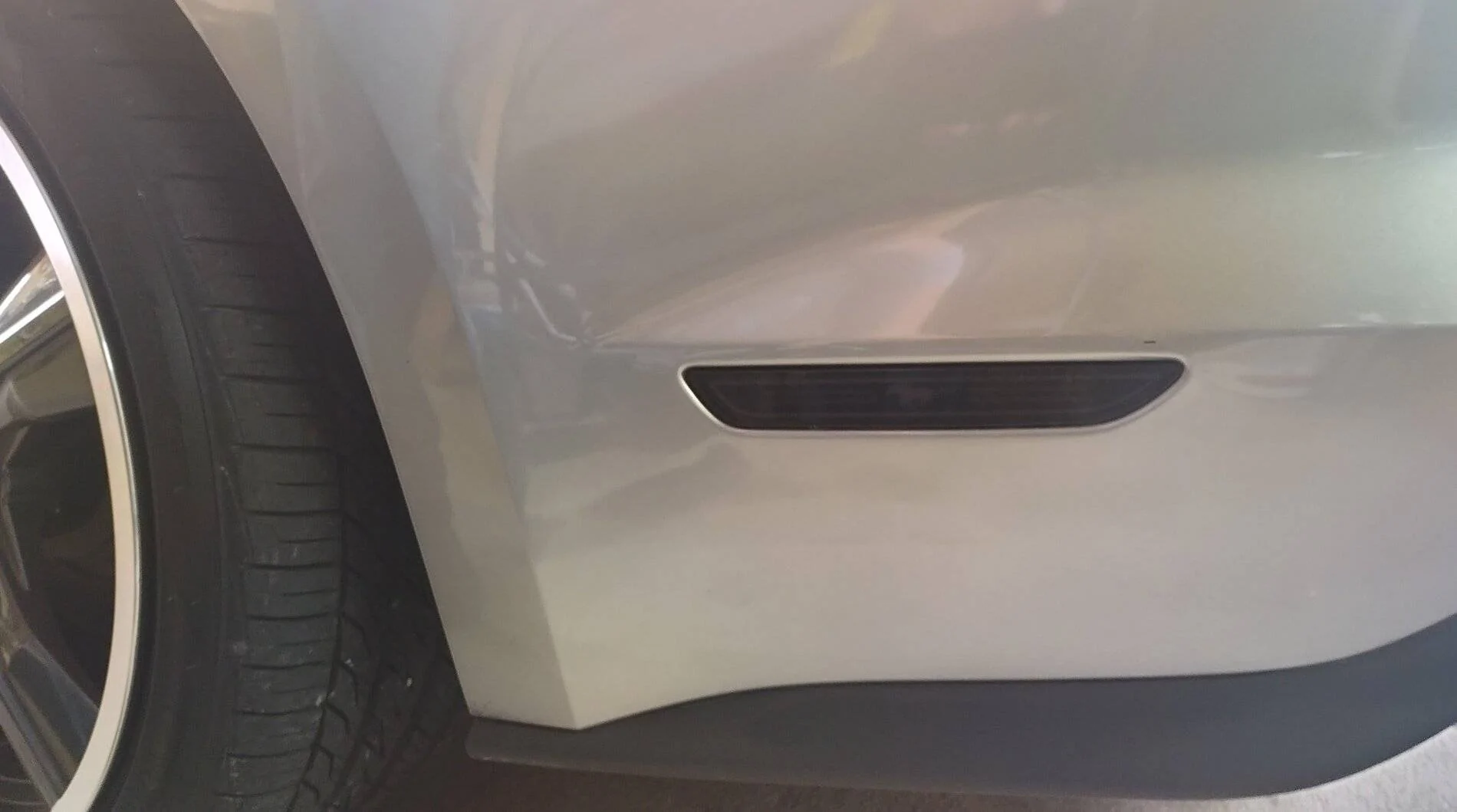

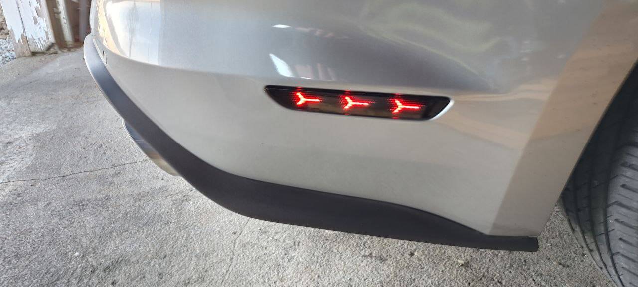

The rear marker lights arrived. They seem really well made. Ford barely left enough wire to get them in and out. I felt like I was pulling the wires to tight just to get the hooks in.

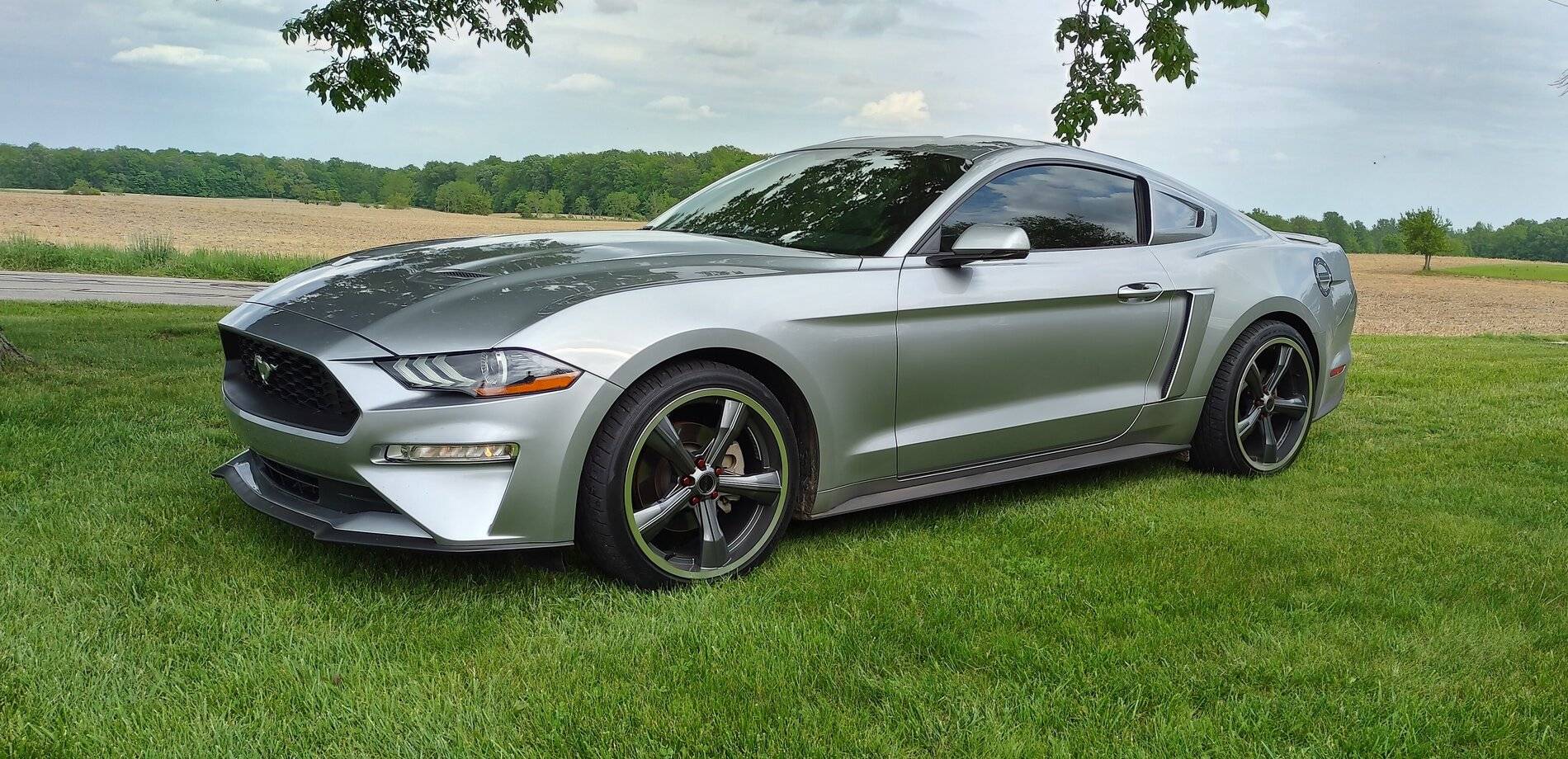

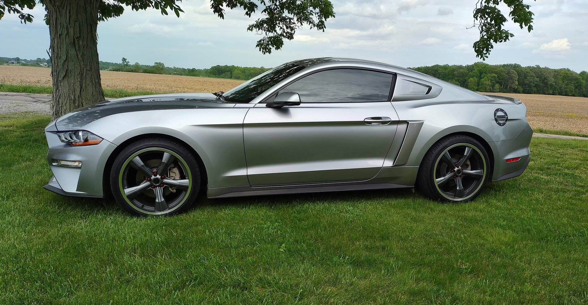

I'm now debating internally if I want to do some charcoal rally stripes that I think could tie in with the wheels. I just don't know yet.
And just because my car likes attention. Always looking like, take a picture of me.

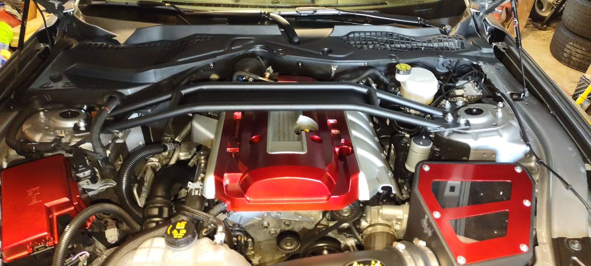

I went with the SR Performance strut tower brace and installed that the other day. I have a couple details before the car show in a couple weeks. I plan on having a good time and meeting some other car enthusiasts in my area.

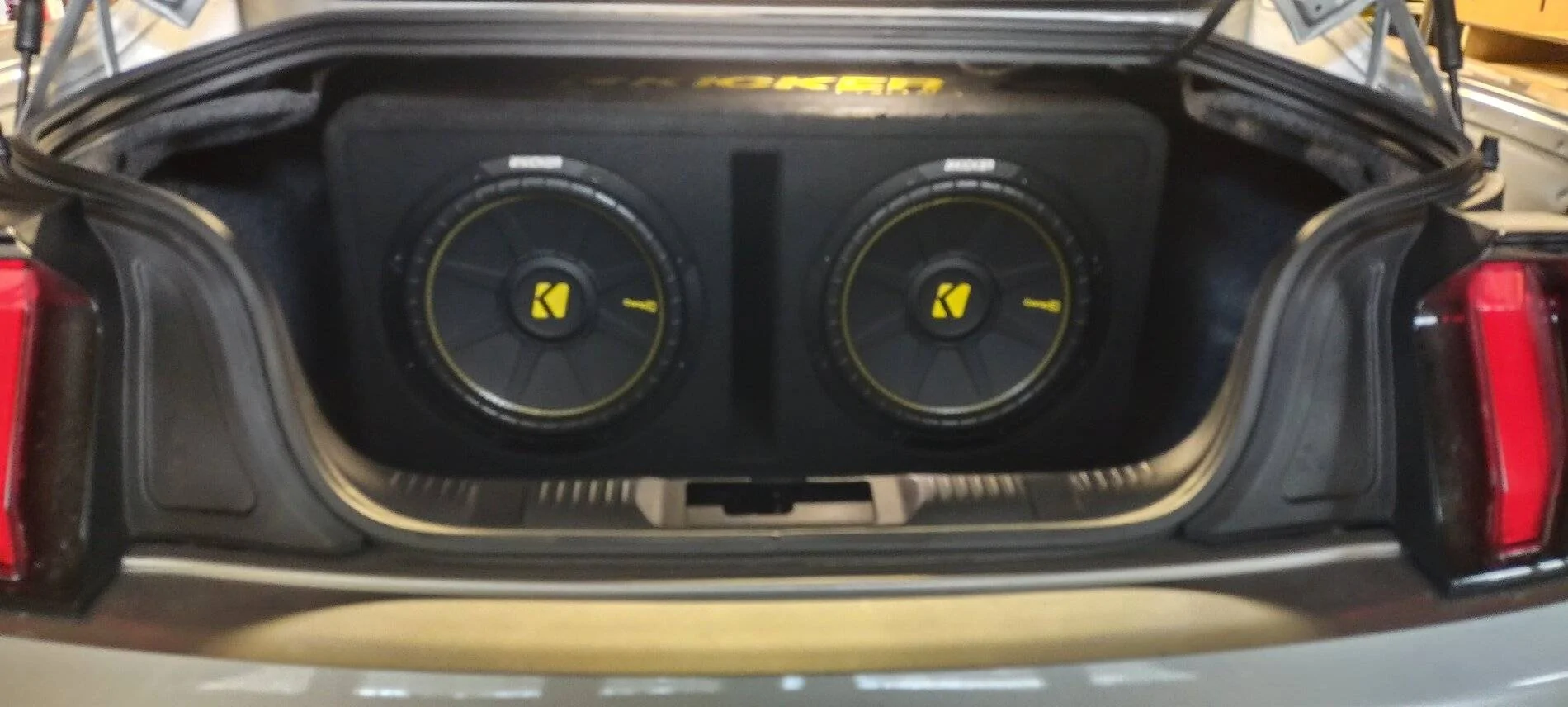

Stuffed two 12" Kicker subs in the trunk with 800w Harmony amp. Was an Amazon package. Didn't really know what to expect from the amp as it's small is size. It pushes the subs just fine. It was a tight fit to say the least.

I had to replace the pony marker lights in the rear. They melted. So unfortunate as they looked great when I put them on. I'll post pics of the new ones later.

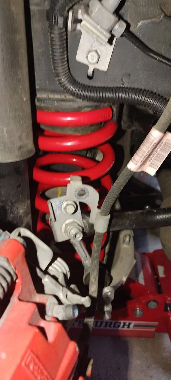

I'm stuck waiting on a better spring compressor to finish the front. I did get the rear springs in. Went better than I expected reading some horror stories.
The tool I bought it similar to what you can rent at auto parts stores. The difference is this one had the adjustment bolt on the end away from the strut plat and threads the middle hook. So the adjustment bolt doesn't touch the strut brace.

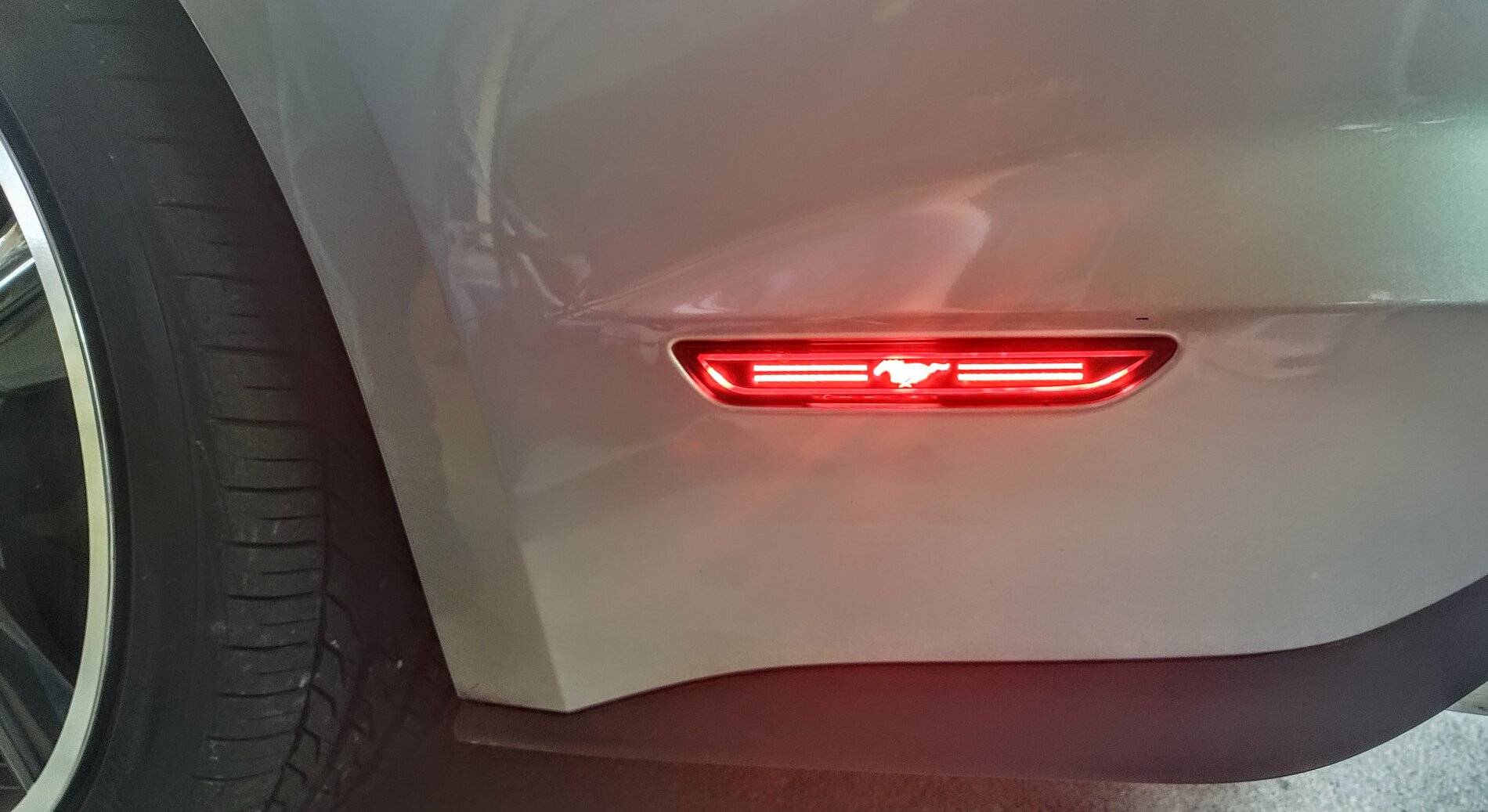

As mentioned before, here are my new rear marker lights. Still disappointed the pony ones melted.

The spring compressor showed up today and I finished the BMR springs. Now I know why everyone was taking their struts and springs in to be changed. But this tool is nice and I'm sure I'll use them again. For $60 I'm happy I can change springs on difficult struts now. I'll post some picks when it's settle and the weather is nicer. But here's a picture of the spring compressor tool.

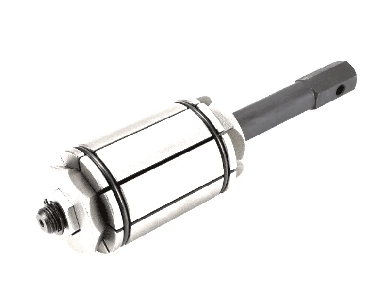

I had an issue with fitting the pipe ends (on a Roush catback) together after I took the exhaust off. The clamps and the heat cycles warp/pinch the ends in a way that made it hard to assemble during the reinstall. A pipe expander made it so much easier to install the second time. I highly recommend getting one of these if you think you'll be removing and reinstalling part of your exhaust.
pipe expander

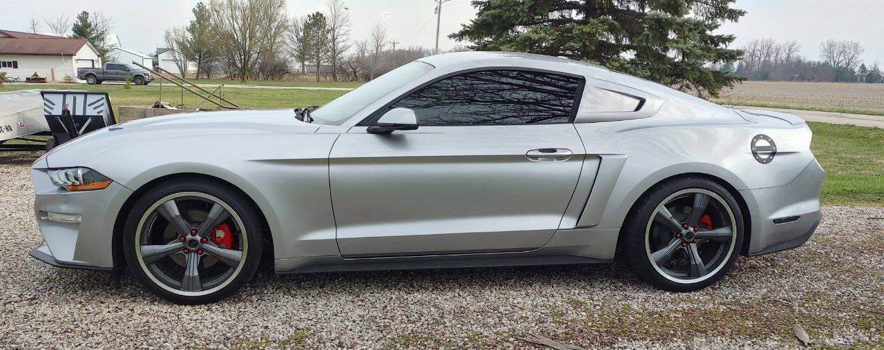

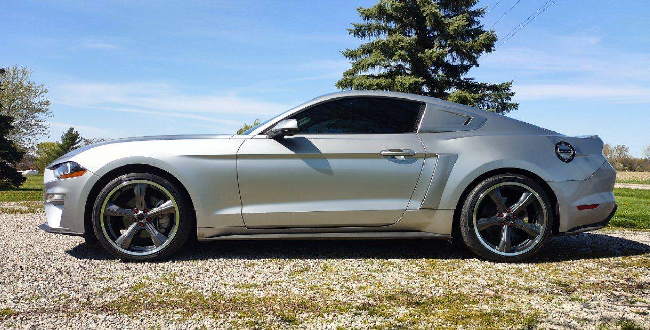

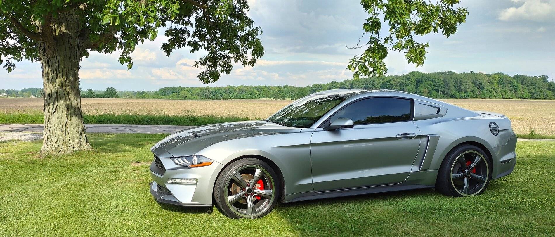

So a before and after the BMR Performance Lowering Springs. This was the day after. I'm hoping the front settles a little more. I feel like it nearly has any rake. Hard to tell in my uneven gravel driveway, lol. I hear it can take 500 to 1,000 miles for the front to settle. I was expecting to have more rake with the front supposed to drop 1.2" and the rear only 1/2". I feel like the front dropped maybe 1/2". I should have measure before.
Before:
After:
