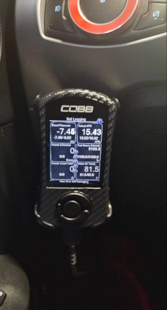

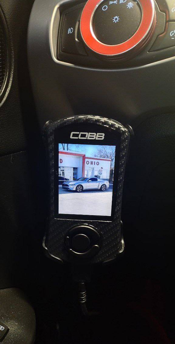

Last night I installed my Cobb Accessport V3. Install was super easy as everyone says. Running Stage 1 91 Octane until I run this tank empty, then I'll go 93 octane. I'm planning on ordering a larder intercooler next so I can run stage 2.
I did get the P018C code but no CEL. So I'm looking to replace the low pressure fuel sensor. A couple pics. I had to load my car in for the splash screen. I need a better pic when the weather breaks. I also carbon fiber wrapped one of the face plates.

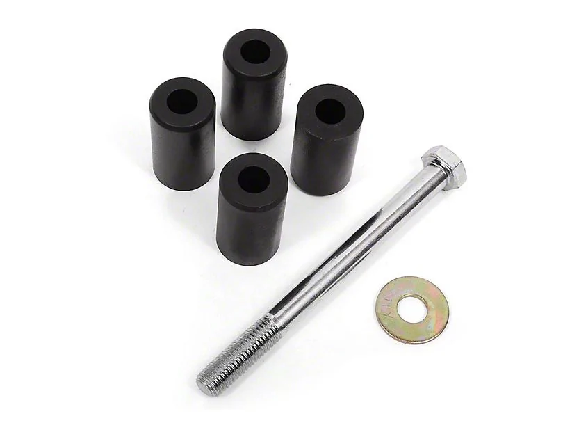

Got me to thinking about the rear. I dropped the whole rear-end (cradle) as the videos show. Remembering how the body bolts went back in, There's a lot of slop for the sleeves the body bolts go through. I started thinking they weren't self centering. So I measured the wheels to the front of the fender behind the doors. The passenger side is just over 3/4" forward than the driver's side.
A little research I found out they sell alignment bushings. They fill the sleeves the bolts go through. Ensuring the bolts are centered in the sleeve they go in. I ordered a set but I don't like my alignment is that far off. I haven't had it aligned yet as I'm waiting for the front to settle a little. Going to try and center it a little better today. The bushings say it could be 2 to 3 weeks, hope not. Hope this helps if you plan on swapping springs soon.

That’s a good mod to do. I have the Steeda version on mine.
I don't see any other way to get the rear square without them.
I just squared the wheels to the body. That appears to be a little off the other way. Much better than it was though. I'll wait and see what the alignment bushings do to it. Then go get an alignment.

I remember reading somewhere that some cars may have to omit a couple of the alignment dowels, in order to square up the IRS cradle. That means one dowel diagonally from another to get square. I‘ve had mine in for almost 2 years now and everything is square. I wish I could direct you to where I read that information, but I stumbled across it while looking for something else.
