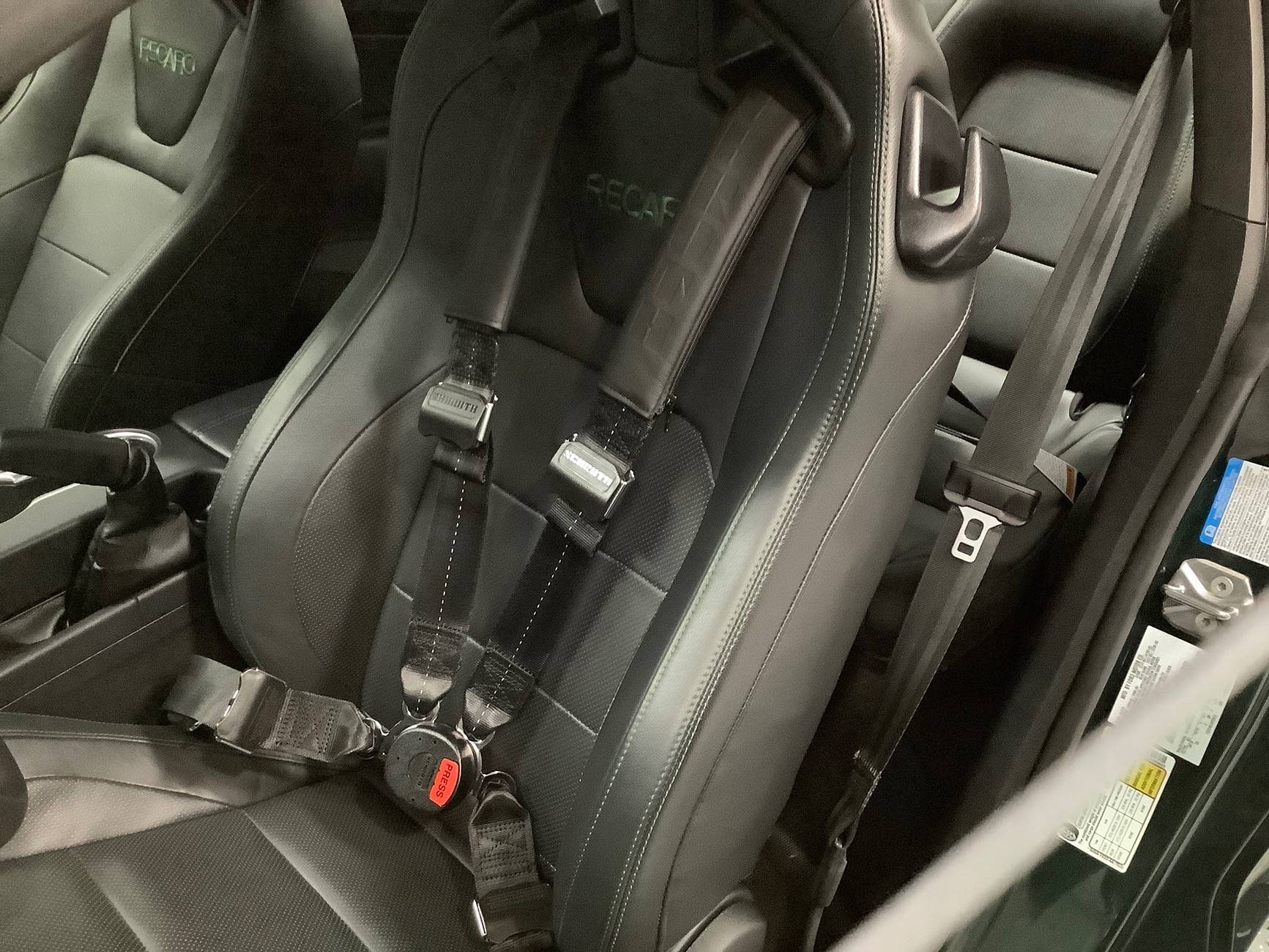

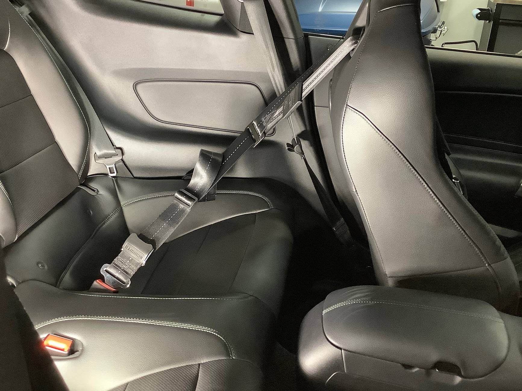

I get what you’re saying there l, but it seems to me that to do what you’re asking would put the seatbelt in an awkward spot (like just inside of the left shoulder) which might make it uncomfortable for you because it might rest against the side of your neck.

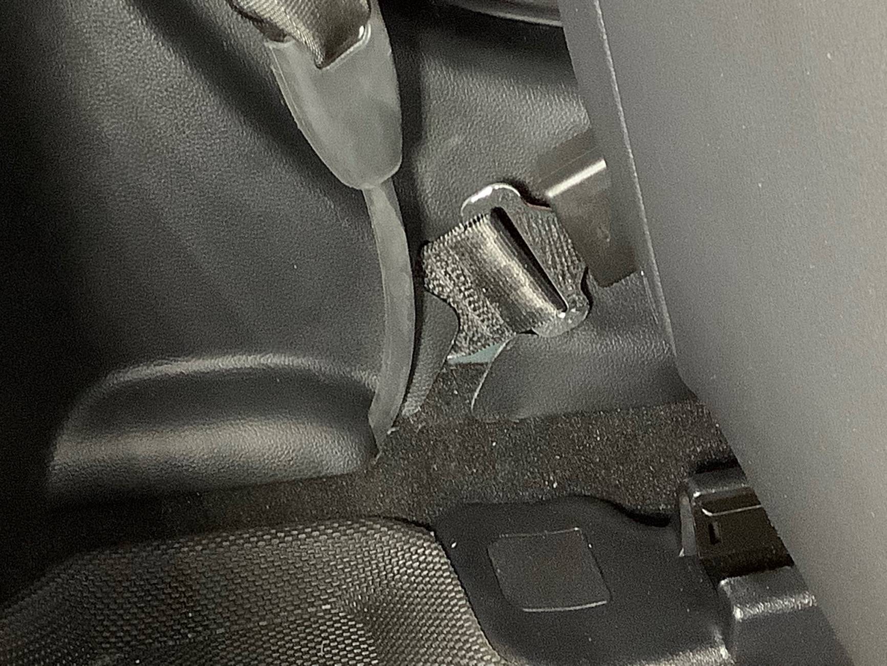

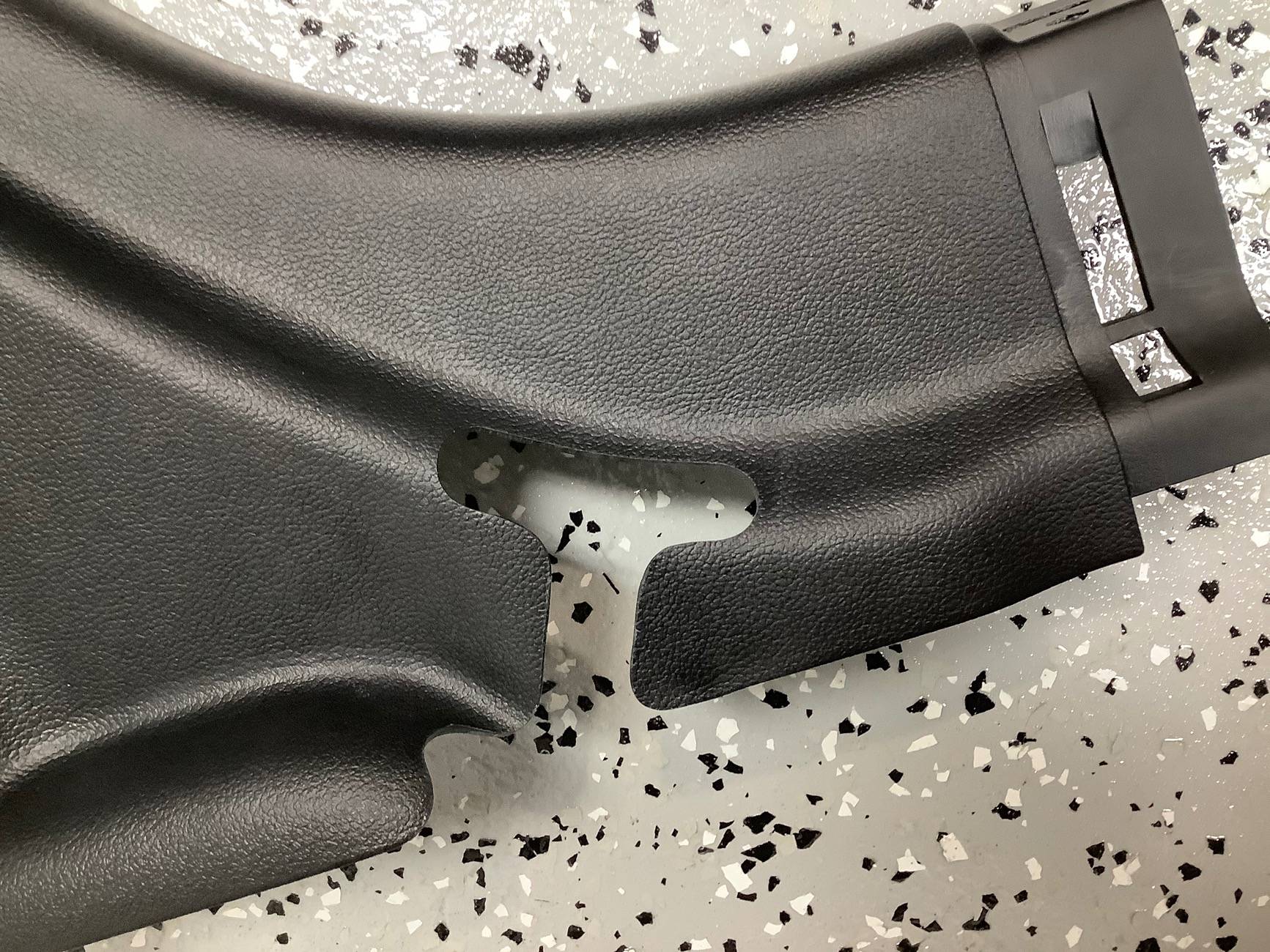

I think the Schroth quick fit pro harness is the better way to go. I put one in mine on the driver’s side, but left the factory belt in place, in case I decided I want to use it. I haven’t felt the need to go back to it though. The Schroth is expensive, but a very nice harness. I knew my wife wouldn’t want to wear one and for that reason, I just did the driver’s seat. If you do go this route, some trim panel modification may be necessary.

Thank you! There’s no such thing as a silly question IMO. You asked a question in search of an answer. Heck, you even made me look into it a bit and ai see there is talk out there about using the factory 3 point harness with race seats with harness openings. Apparently, there are some seats that may be able to accommodate this, but I stopped looking at that point.
With your cage, you can do the wrap around style harness or the quick fit pro and still retain the factory belt in case you need it. I’m not sure if there is a big difference in price between the two, but at the very least, the wrap around would not require you to modify trim panels.
I wanted to leave my factory belt in place, in case I encountered a problem with the latch or cam-lock, I would still have a backup belt in place.
