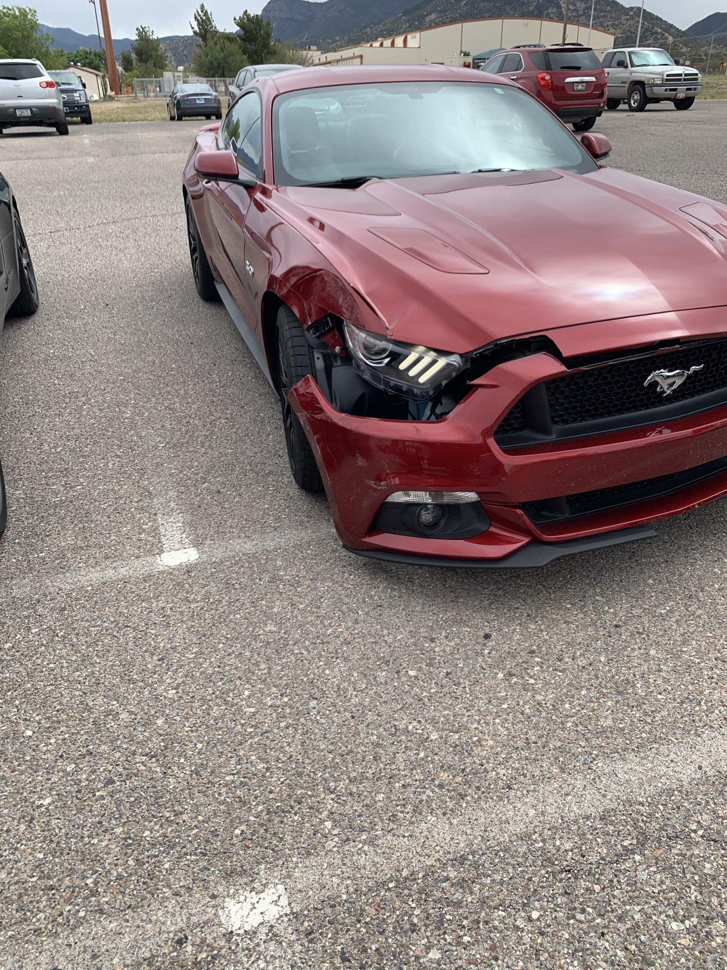

Got sideswiped yesterday.. how bad do you think this is?

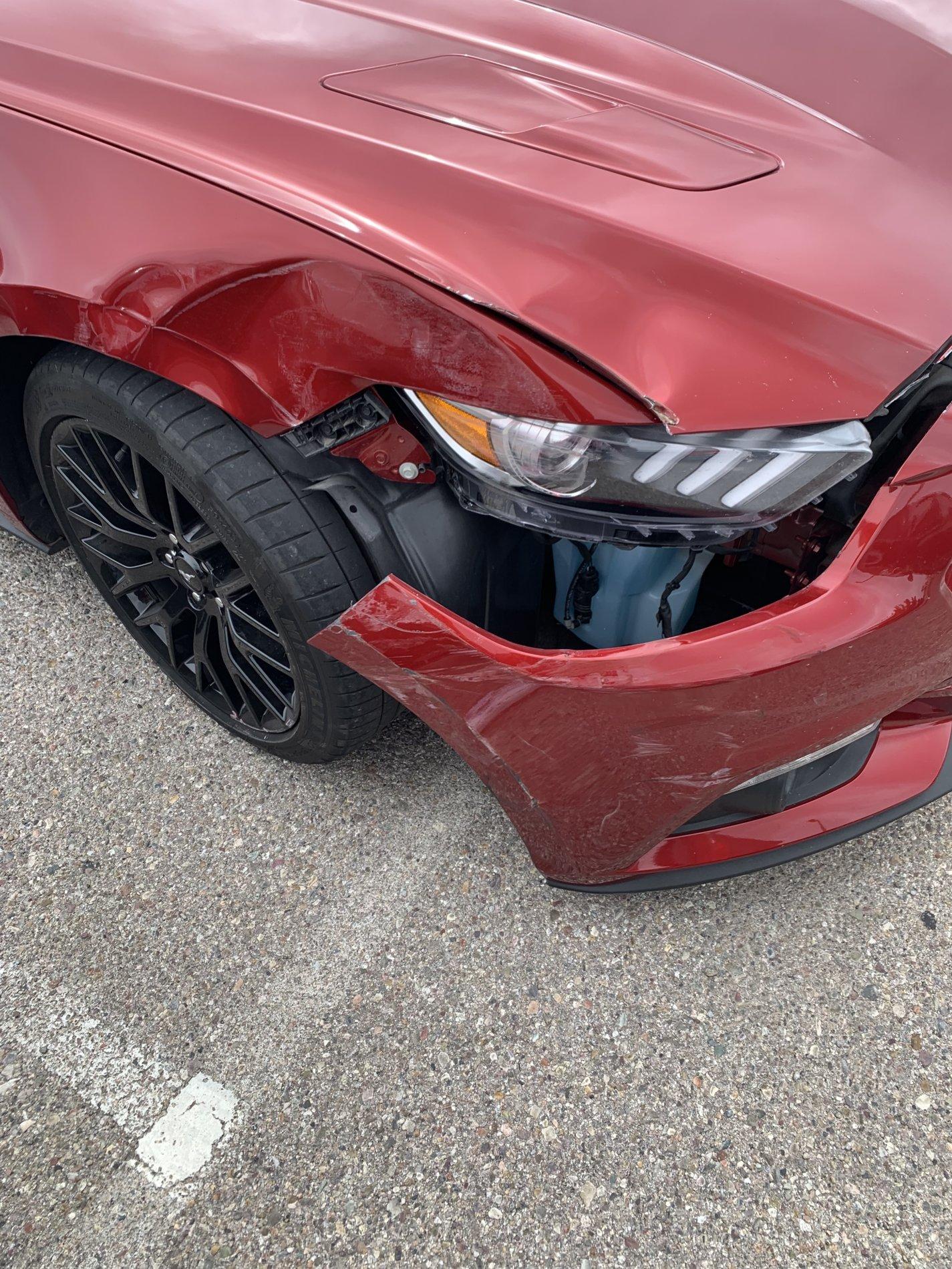

My opinion is worth what you paid for it: get an expert to inspect carefully for front suspension/frame damage. What I see simply looks cosmetic, but could be concealing something worse.

New head light: $1,300
New bumper cover: $1,000
New fender: $1,500
Labor: $???
My guess: $5,000

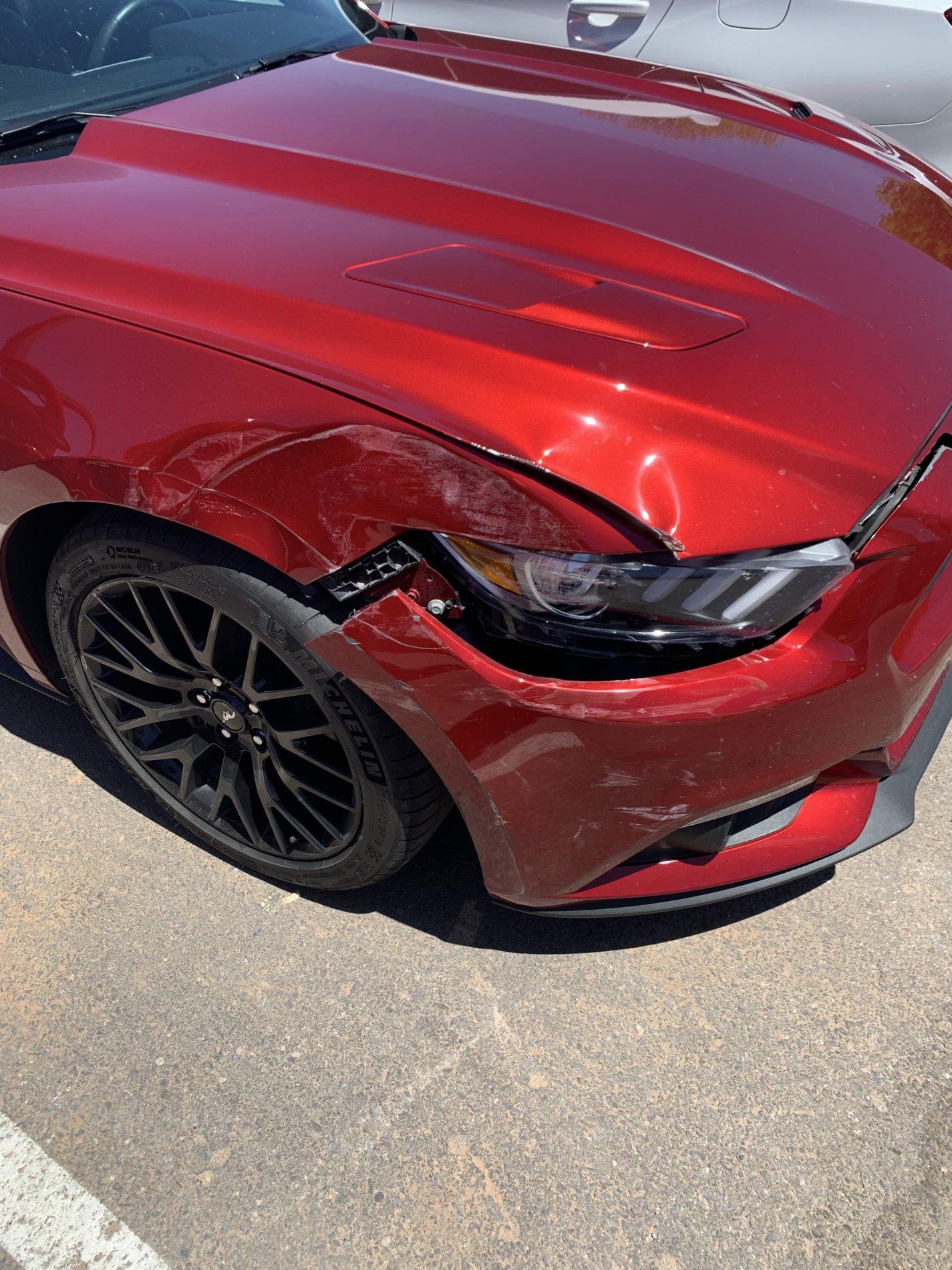

Hood looks damaged as well
Diminished value claim? As you won’t have a clean car fax report assuming you were not at fault

I'm thinking the hood can be straightened.

Make sure they blend the left fender if they replace the hood. Will definitely be blending the front door. I would say assumeing damage isn't pushed into the apron probably around 4.5 to 5k. I would not hesitate to have it repaired through insurance at it has the potential get exponentially more expensive.

about 3500 tops if you dont have oem parts on your insurance. your going to get aftermarket or used .. my buddy got hit it needed a door, rocker, and quarter panel to get fixed,plus labor and paint it came out to 5100
would be a time for a gt350 front bumper conversion for sure ,and if they cant fix that hood, id get a nice cowl hood or sweet aftermarket one to take its place , but seeing you have a 17 theres used parts all over that the insurance company will most likely make the body shop get

Fender, hood, headlight and fascia at minimum. That estimate will be higher than you may think

Many places are not blending body panels any longer. When my hood was replaced due to the cancer, the Ford dealership came out with a special camera from Axalta, took several pictures right up against the paint, and the computer mixes everything. It's a dead match for my fenders and front bumper.
OP, I'd say you're in for $5-6000, assuming there's no damage to the radiator, AC, or anything else in the nose. I'd make sure they take a good look at the suspension components, frame rails, etc.
