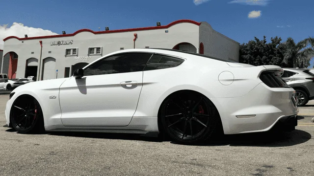

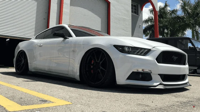

Thanks to all tha praise given by D4rk_hrs and Jmeo, I just had my 3P system installed. I totally copied Jmeo's setup as I use my Stang for work and constantly have tools as well as parts stored back there. Big thanks to them for making up my mind about AirLift.
