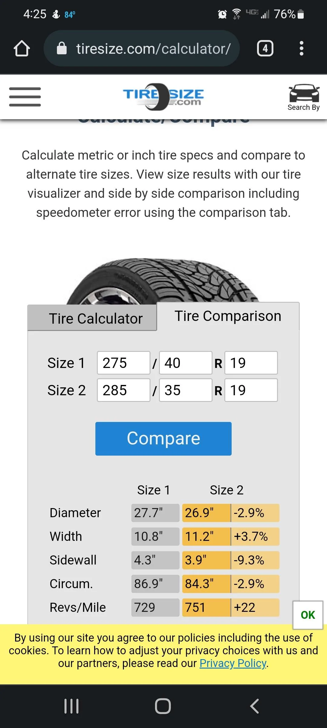

Gotcha, what's your new set up? I'm planning on going 19x10 squared but can't decide if I should go with 275/40 to fill the wheel gap a bit more or 285/35... both specs seem to be the favorites.

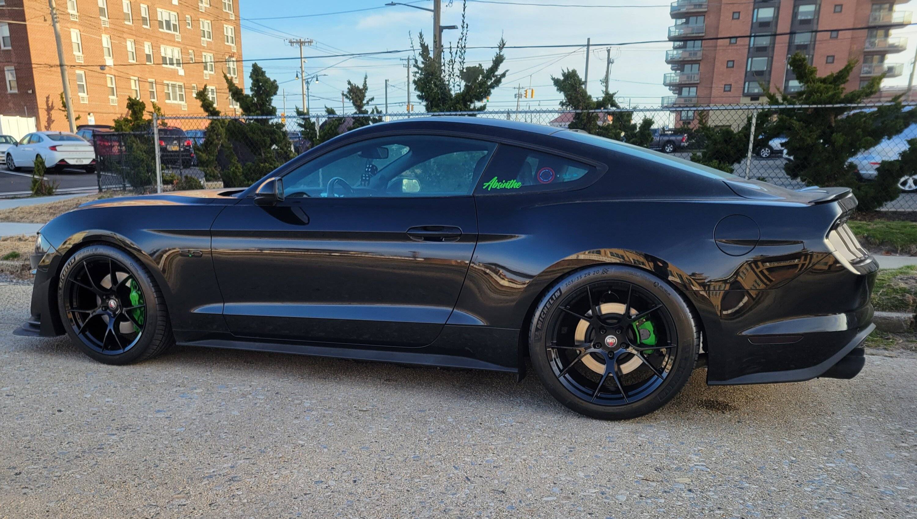

Running project 6grs, 20x10 up front on 275/35/20s... 20x11 rears on 305/35/20s. Still on the steeda progressives; no spacers - offset is tailor-made for a Mustang. No rubbing, no issues.
Here are the comparisons between those tires sizes. (Love that calculator) ... My rears are 28.4 inches tall
Thanks man! Your set up looks great. Was your speedometer thrown off at all?

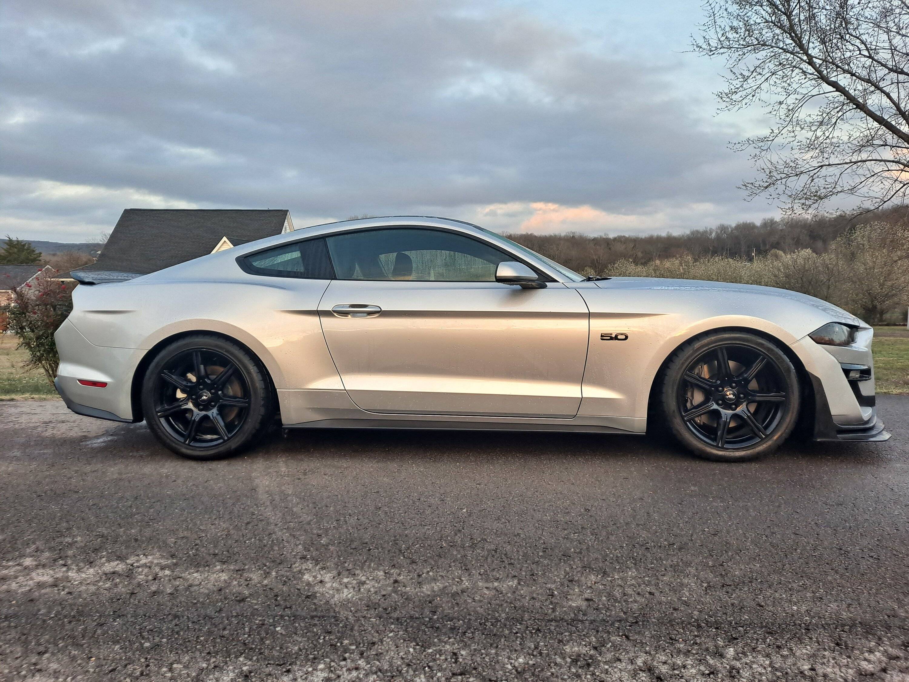

This is lowered with 25mm spacers.

Oo that looks pretty darn good. Is it dead flush all around without any poke?
It's spot on flush.. I used the cj pony parts Accelatech lowering springs and their wheel spacers .
I have an SCT Rev-x handheld.
Just went into special functions and changed the tire diameter. Easy peasy..
Did the same thing when I changed to a 4.09 rear gear.
Super easy
