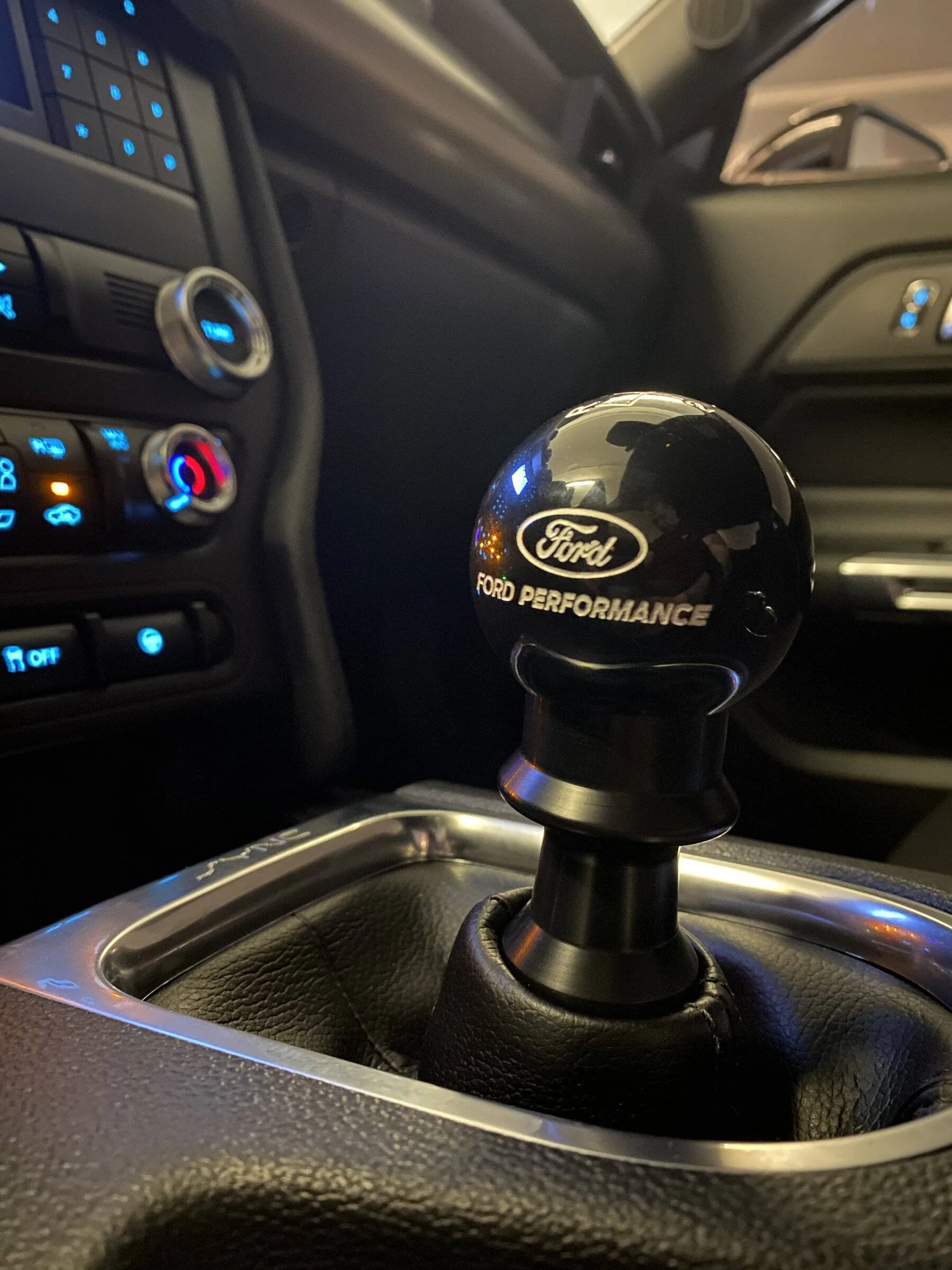

I did the Steeda reverse collar while I had it all apart too.
The Steeda black collar changes the looks completely; that's one of my favourite modifications. Too bad it's not made of metal, but I guess delrin is the next best thing.
Did you manage to fit the rubber boot over the Tri-Ax top plate, and to attach it to the floor exactly as it was previously? Some people report having problems with this step in post-2018 vehicles.
Any increase in NVH?
