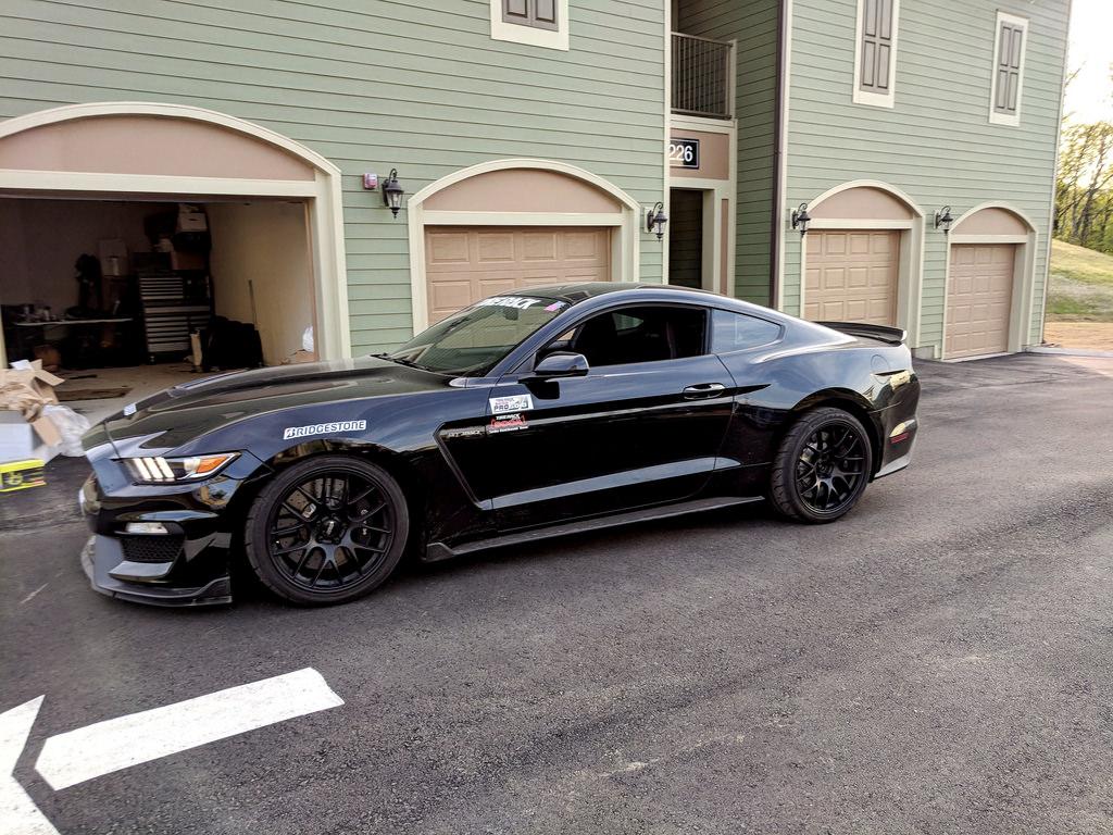

I purchased a JRZ shock setup, double adjustable remote canisters. I bought the recommended springs from the place I bought them from. They said to buy a 700 - 7" front spring and a 1400 6" rear spring. After installation everything is wonky.
The fronts are adjusted until the springs has preload and the rears are as low as possible. The picture shows how out of wack it is. The front wheel is tucked and rear is 4x4 mode. They are installed correctly.
What springs are others running on their cars?

Thats rake is ridiculous. I am running the ford performance springs others are using eibach both with good results. The eibach springs r a bit lower than the FP springs. Send those springs back where they came from lol.
