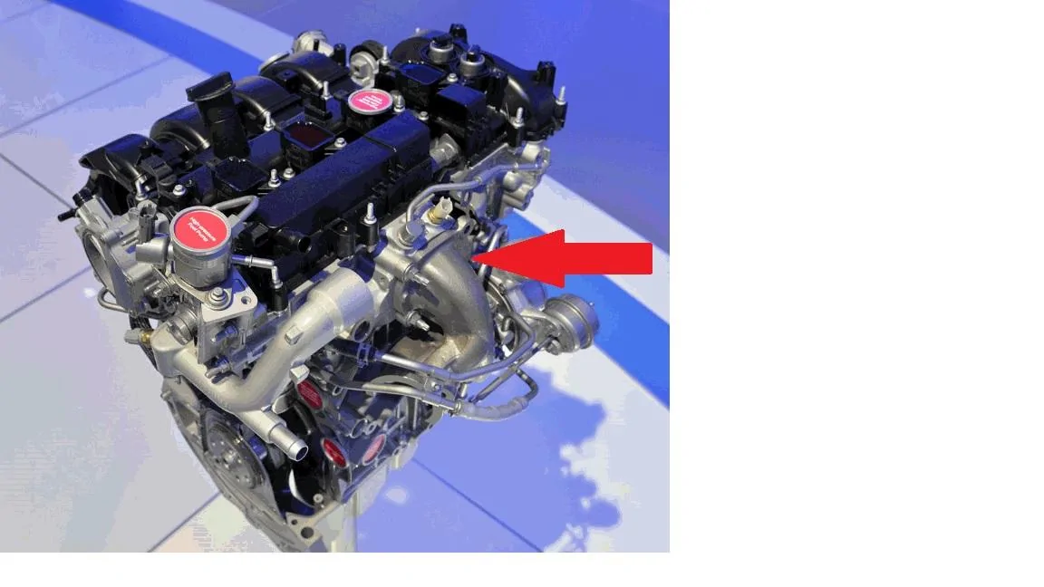

would oil leaking from this side of the engine be a symptom?
