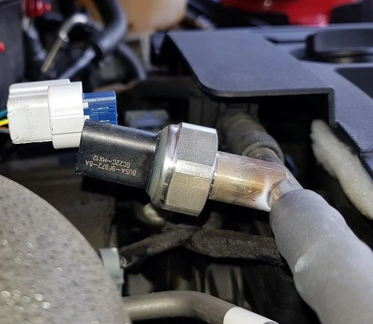

My car is a 2017 PP EcoBoost. As shown on the picture below, my sensor part # is BU5A-9F972-BA. Is this the old or the new version? According to this thread the BA in the new version and the CA the old one. But a guy on Adam's group on Facebook just told me that that the BA is the old and the CA the new version. So now I am confused :shrug:
I will do the test described by Adam just in case, but I think I will be proactive and order the part, just in case.

^ [MENTION=13694]Juben[/MENTION] I need to know that too, if you have the answer ;)
That looks like the old sensor. I wasn't having issues but swapped it out anyways since they are around $20 on eBay.
My brand new sensor says -CA at the end. Package says -B but on the actual sensor it's CA. My old one was BA.
