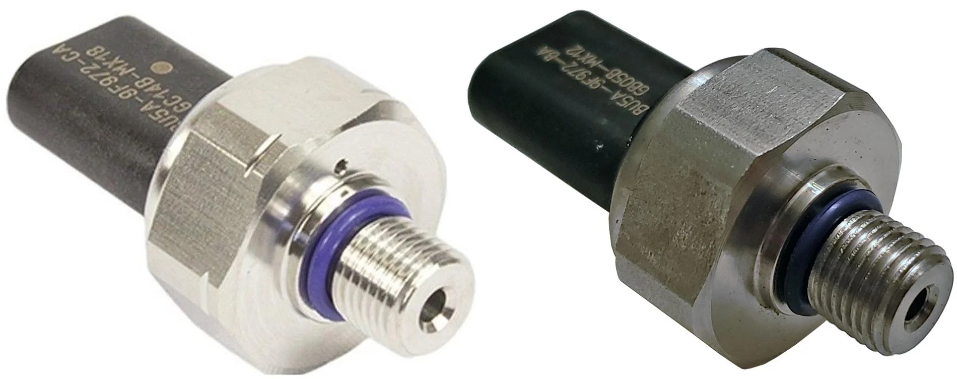

My car is a 2017 PP EcoBoost. As shown on the picture below, my sensor part # is BU5A-9F972-BA. Is this the old or the new version? According to this thread the BA in the new version and the CA the old one. But a guy on Adam's group on Facebook just told me that that the BA is the old and the CA the new version. So now I am confused :shrug:
I will do the test described by Adam just in case, but I think I will be proactive and order the part, just in case.
I can also confirm that my 2017 has the same -BA part number.

According to [MENTION=13694]Juben[/MENTION] the part number on the sensor itself is an engineering part number and not the actual part number. Apparently you can’t tell by this number if the sensor is the new or the old one. We should look for the correct part number on the packaging.
However, we discussed this on FB and the best way to find out if the sensor works fine is to do the test suggested by Adam. If the readings on the Accessport indicate an issue, then I would simply order the part with the BU5Z-9F972-B on the packaging.

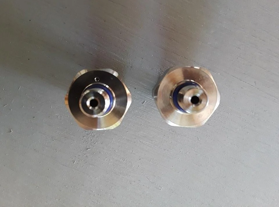

Just a heads up, my original 2016 -BA sensor differs from the -CA sensor I received in physical design where the -CA has a pin-hole on the bottom of the head.
Any pics to show the differences or at least the design sheet?

Found this picture on a FB post. I can confirm that the left one's the new design that ends with -CA.
This is true. Mine had the pin hole as well. Didn't really think anything of it. Been working fine

On the redesign, what is the function of the visible “pinhole” in the sensor body?
