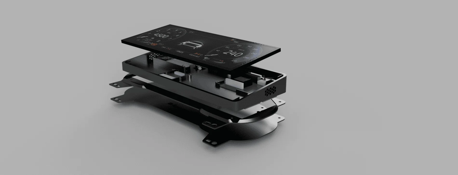

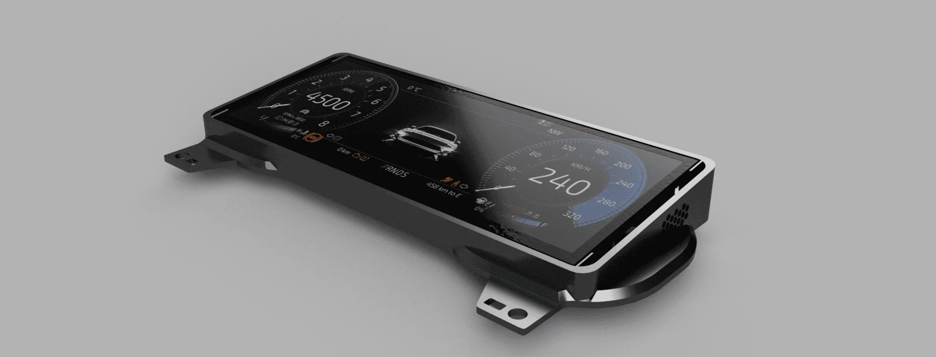

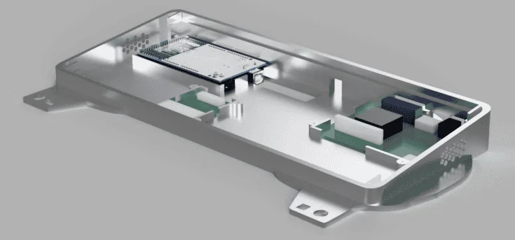

Hi everyone,
I've been programming my own digital speedometer myself for some time.
The speedometer reads all information out of the OBD2 socket, that works very well, now I have the problem that I do not know all specific PIDs from FORD, here I will post a list of required OBD2 PIDs, I would be very happy if you can help me with the project and I could share the project with you.
LIST OF REQUIRED PIDs: (NAME - PID - Conversion)
[OBD2 PID] - Speed - pid = 010D - conversion = A
[OBD2 PID] - RPM - pid = 010C - conversion = ((A * 256) + B) / 4
[OBD2 PID] - Fuel - pid = 012F - conversion = 100 * A / 255
[FORD PID] - Fuel - pid = 22F42F - conversion = A * 0.39216
[OBD2 PID] - Coolant Temperature - pid = 0105 - conversion = A - 40
[OBD2 PID] - Ambient Temperature - pid = 0146 - conversion = A - 40
[OBD2 PID] - Air Fuel Ration - pid = ????
[OBD2 PID] - Cylinder Head Temperature - pid = ????
[FORD PID] - Engine Oil Pressure - pid = 22F45C - conversion = A - 40 (!!!NOT TESTED!!!)
[OBD2 PID] - Inlet Air Temperature - pid = 010F - conversion = A - 40 (!!!NOT TESTED!!!)
[FORD PID] - Trans Oil Temp - pid = 221E1C - conversion = ((A * 256) + B) / 16 (!!!NOT TESTED!!!)
[OBD2 PID] - Vaccum/Boost - pid = ????
BAT[OBD2 PID] - Battery (PCM) - pid = 0142 - conversion = ((A * 256) + B) / 1000
BAT[OBD2 PID] - Battery (Direct from OBD2 Adapter) - pid = FF1238 - conversion = A
[FORD PID] - Shift Gear - pid = 221E23 - conversion = A
[FORD PID] - Current Gear - pid = 221E12 - conversion = A
[OBD2 PID] - ABS Status - pid = ????
[OBD2 PID] - Hand Break Status - pid = ???
[OBD2 PID] - Tire/Break Status -- pid = ???
[OBD2 PID] - Seat belt - pid = ???
[OBD2 PID] - Airbag Status - pid = ???
[OBD2 PID] - ESP Status - pid = ???
[OBD2 PID] - ESP OFF Status - pid = ???
[OBD2 PID] - Left Turn - pid = ????
[OBD2 PID] - Right Turn - pid = ???
[OBD2 PID] - Parking Light - pid = ????
[OBD2 PID] - Hight Beam Light - pid = ????
[OBD2 PID] - Fog Light Front - pid = ????
[OBD2 PID] - Fog Light Rear - pid = ????
[OBD2 PID] - Driver Door Status - pid = ????
[OBD2 PID] - Passenger Door Status - pid = ????
[OBD2 PID] - Engine Hood Status - pid = ????
[OBD2 PID] - Trunk Door Status - pid = ????
[FORD PID] - Front Left Tire Pressure - pid = 222813 - conversion = ((((256 * A) + B) / 3 + 22 / 3) * 0.145) / 14.504
[FORD PID] - Front Right Tire Pressure - pid = 222814 - conversion = ((((256 * A) + B) / 3 + 22 / 3) * 0.145) / 14.504
[FORD PID] - Rear Left Tire Pressure - pid = 222815 - conversion = ((((256 * A) + B) / 3 + 22 / 3) * 0.145) / 14.504
[FORD PID] - Rear Right Tire Pressure - pid = 222816 - conversion = ((((256 * A) + B) / 3 + 22 / 3) * 0.145) / 14.504
if you can think of important PIDs, I'll be happy to enter them here.
(I will keep the list up to date here in the forum with the corresponding PIDs)
PICTURES:

So you’re building a replica digital cluster of the Ford counterpart?
That’s wild - and definitely keep this post updated with your progression!!

its neat, really neat actually. but, will it be as responsive as oem? they are high end manufacturing, and makes things cheap, but quite efficient.
I felt like watching the video, there was a delay or just wasn't as smooth. could you upgrade the horsepower on the processor in that if you wanted? or just copy the programming into another version of it. boom, toss a beefy little processor in it

pretty cool, have you thought about making a HUD version ? Save taking apart the dash to fit it / use it ?
