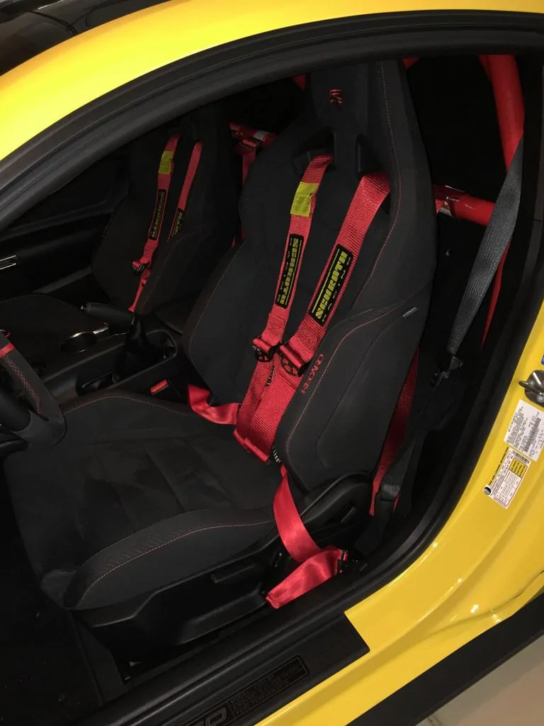

Schroth Quickfit/Quickfit Pro fits the GT350 and doesn't require a roll bar.

I am curious if anyone has installed the harness below and has any comments to make on it.
http://www.americanmuscle.com/schroth-quickfit-pro-black-0516.html
I have these installed then on my 2017 GT350 and they work great! Had to make a slight modification given they changed the stock 3 point seat belt setup for 2017. These pop right in for a 2015-2016 GT350.
I have long used the Quickfit Pro for street BMW's and Audi's that have been used for track day events. Snap them in for a track day event and when it is over pop them out and use the stock 3 point harness for daily driving. Great belts.

Sorry to resurrect an older thread, but I'm thinking of purchasing the Quickfit Pro for my '17 GT350 and am curious about the slight modification you mentioned. What needs to be modified on the '17 cars?
I have these installed in my 2017 GT350, and they are great for HPDE. The modification is that you need to twist the rear anchor bracket 90 degrees for it to bolt in properly. I also needed to slightly clearance the plastic trim by the lap belt anchor to get an appropriate angle for the Schroth male end that bolts to the factory tensioner bolt. Total install time was ~1 hour for both sides.
