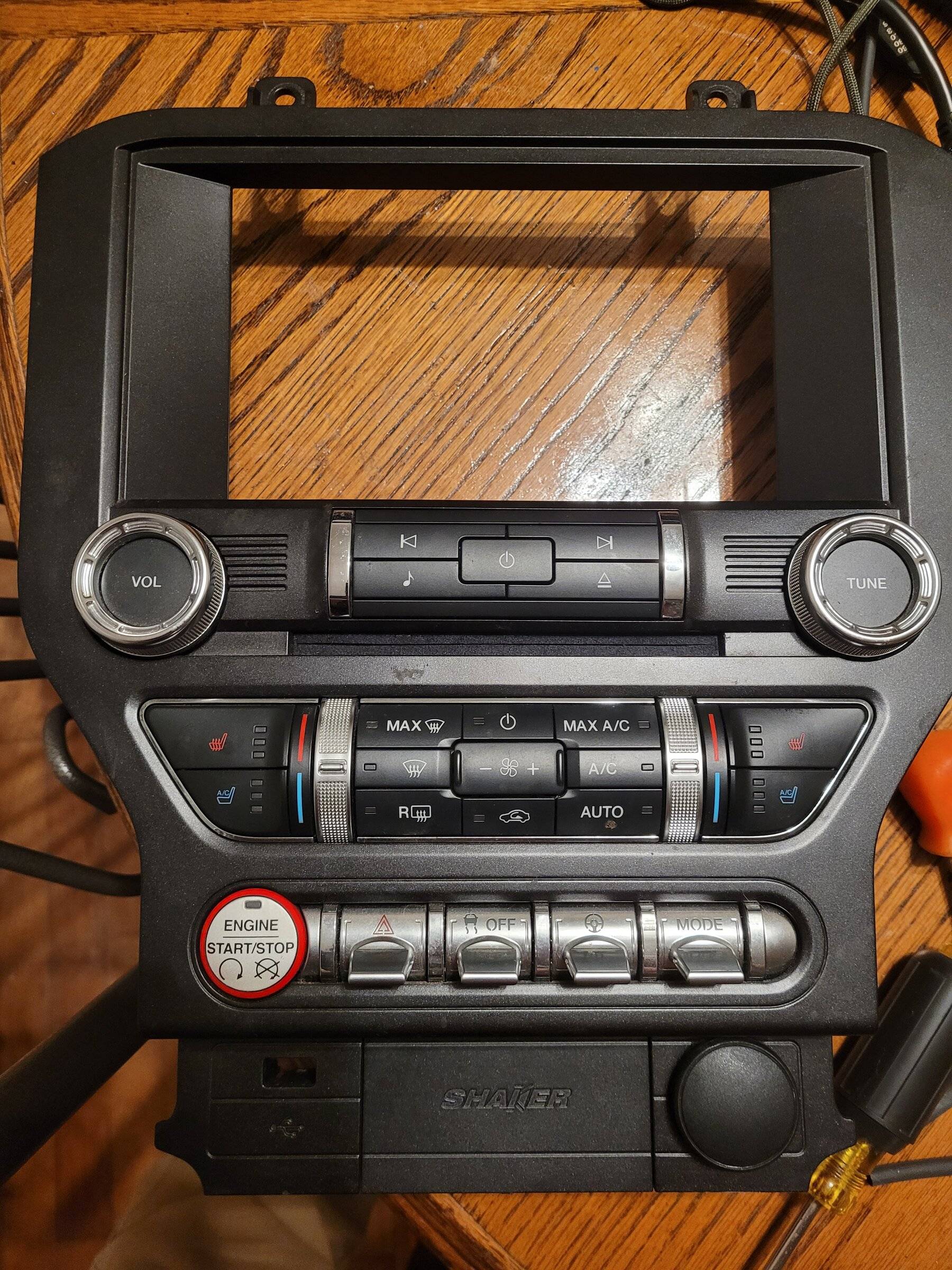

Angrey, unfortunately the bezel isn't out of a GT350. They have more of a bronze coloring on the switches. Check with Tom about this, make sure you ask him about this as the GT350 stuff complicates some stuff.
Yeah, he said as much. I knew the finish of the buttons and such was different, but I didn't think the entire bezel/frame wouldn't work.

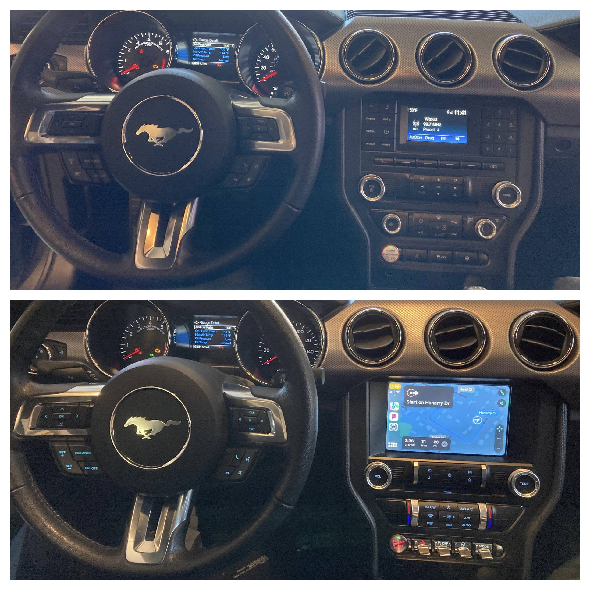

I ended up biting the bullet and simply paying to upgrade to the factory screen and sync3+.
