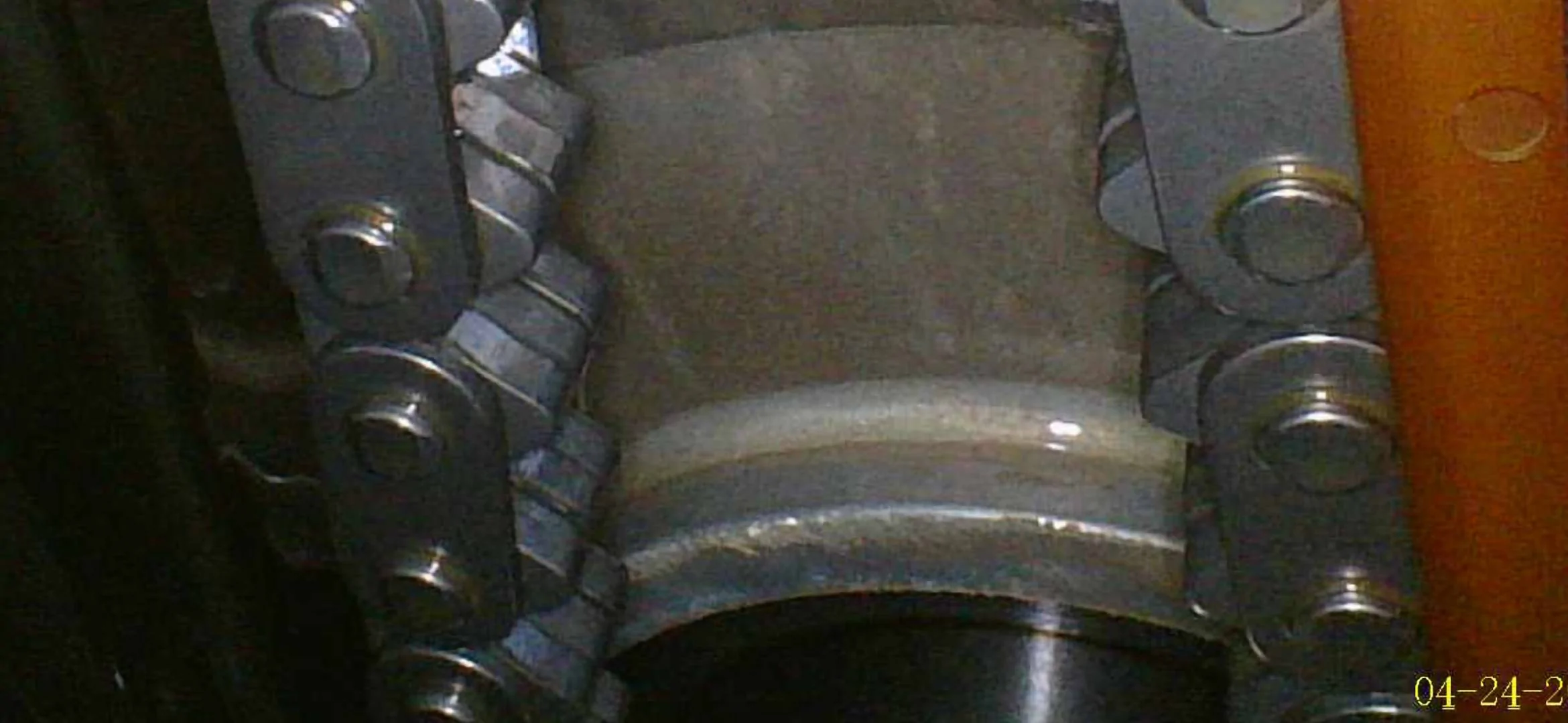

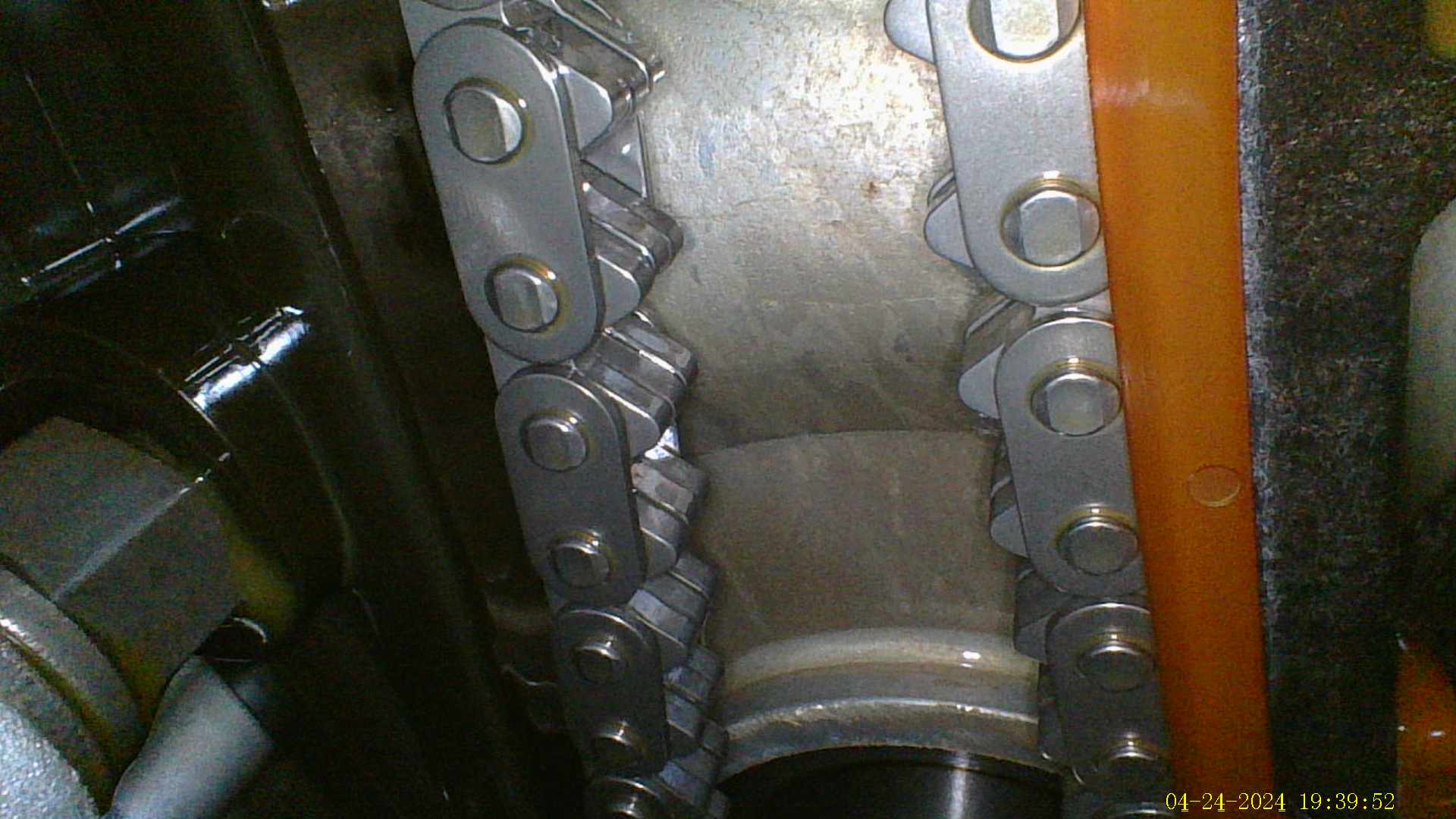

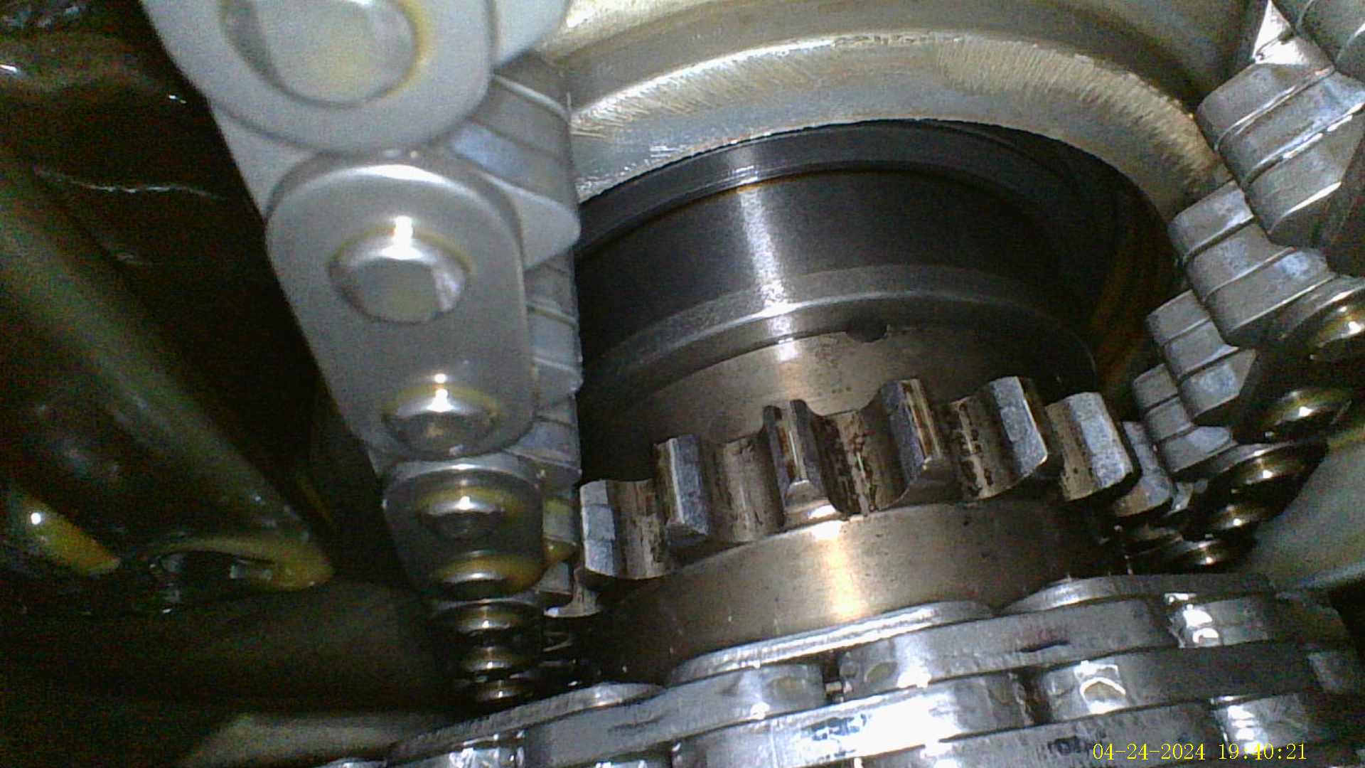

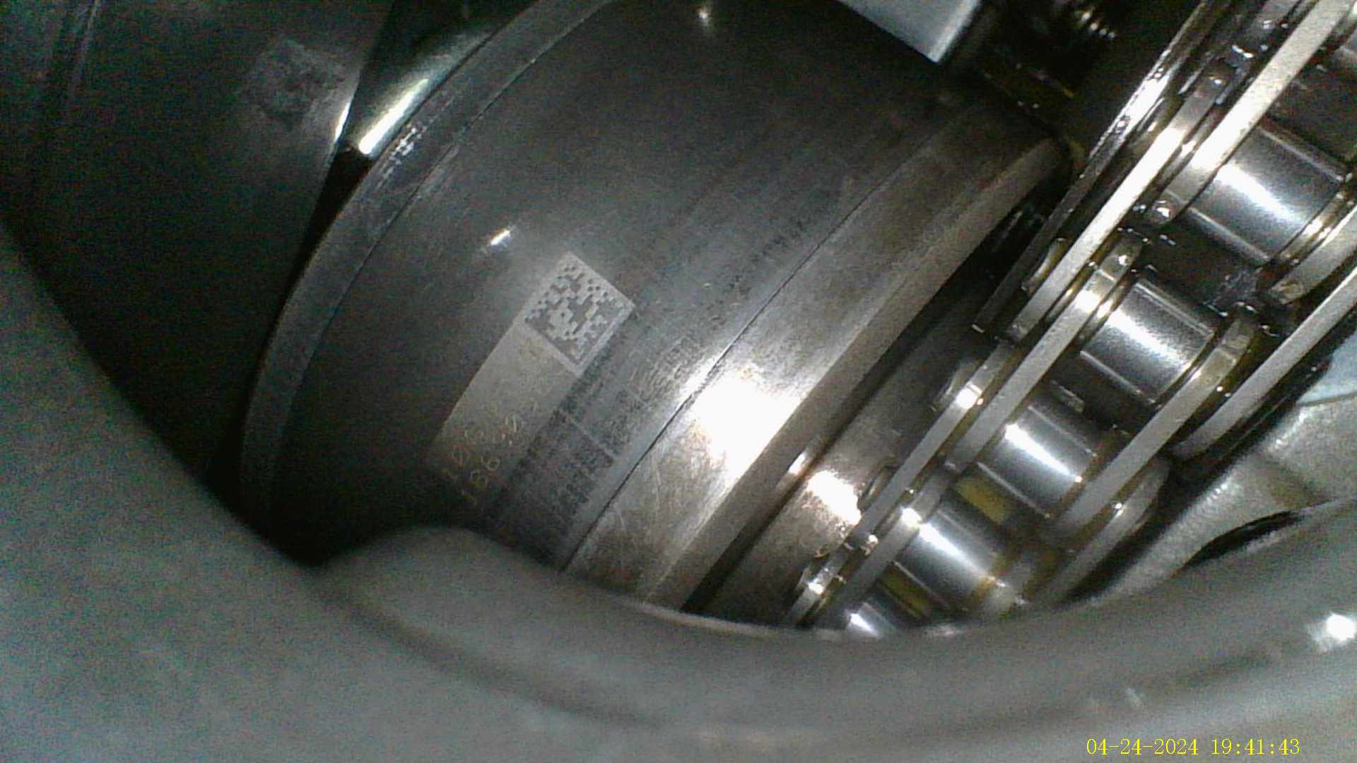

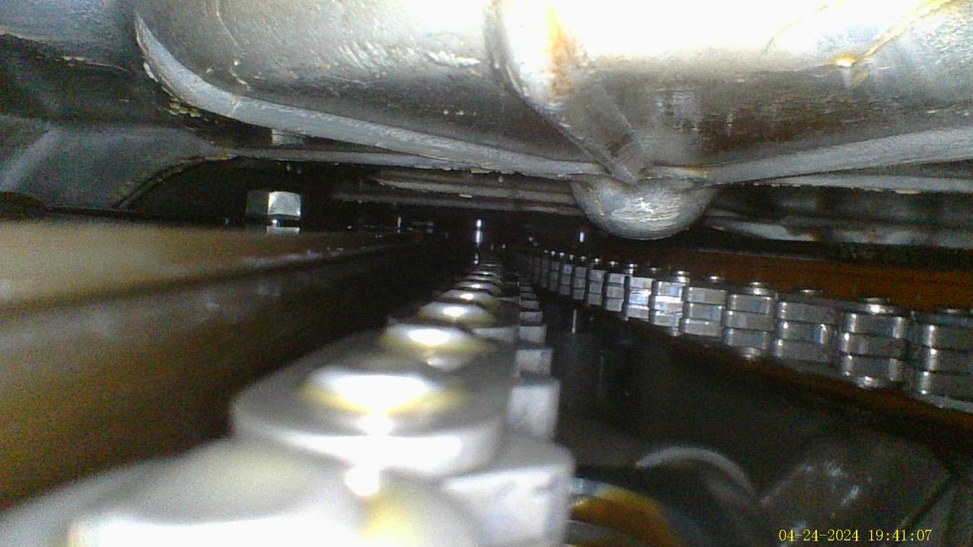

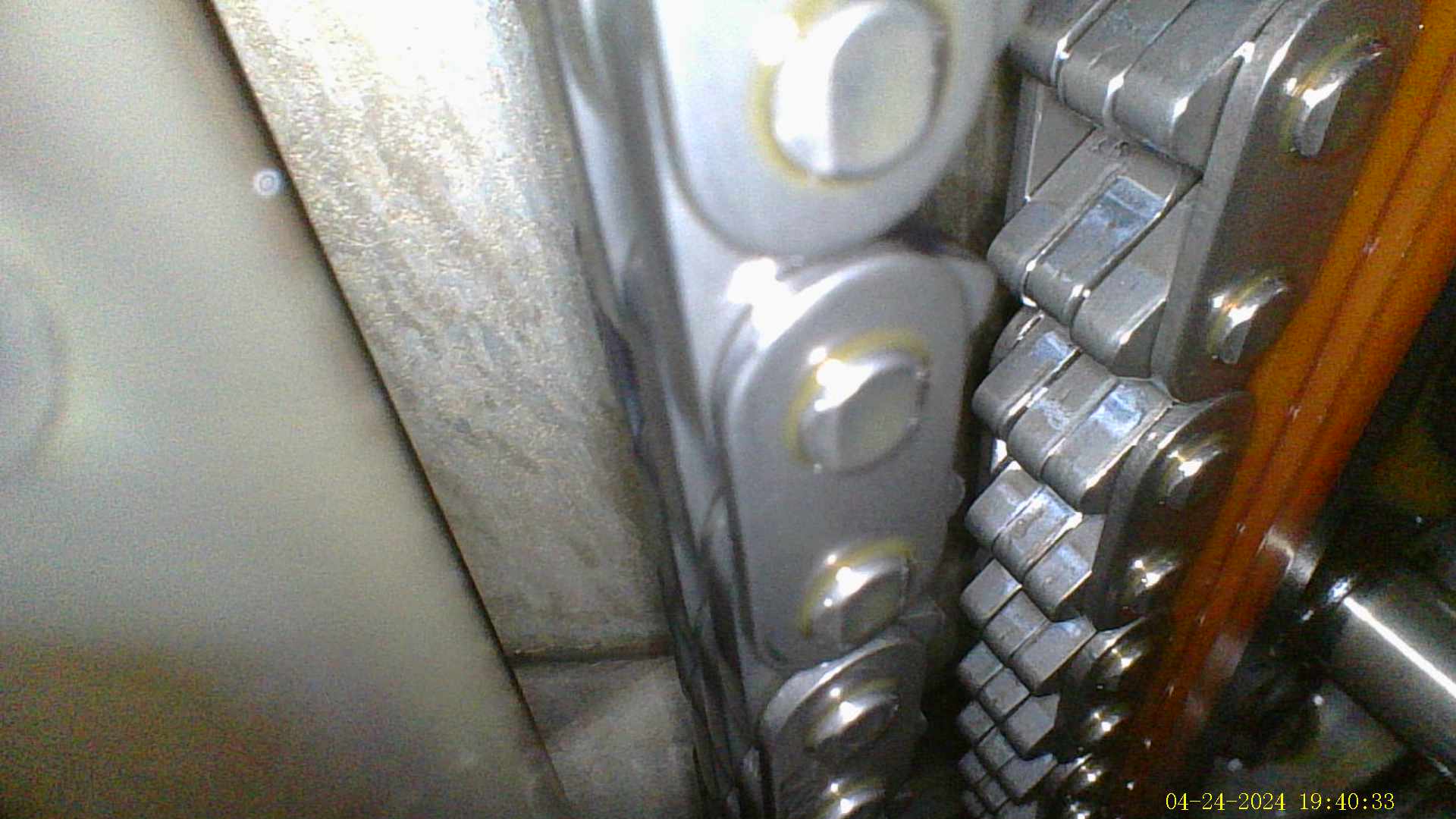

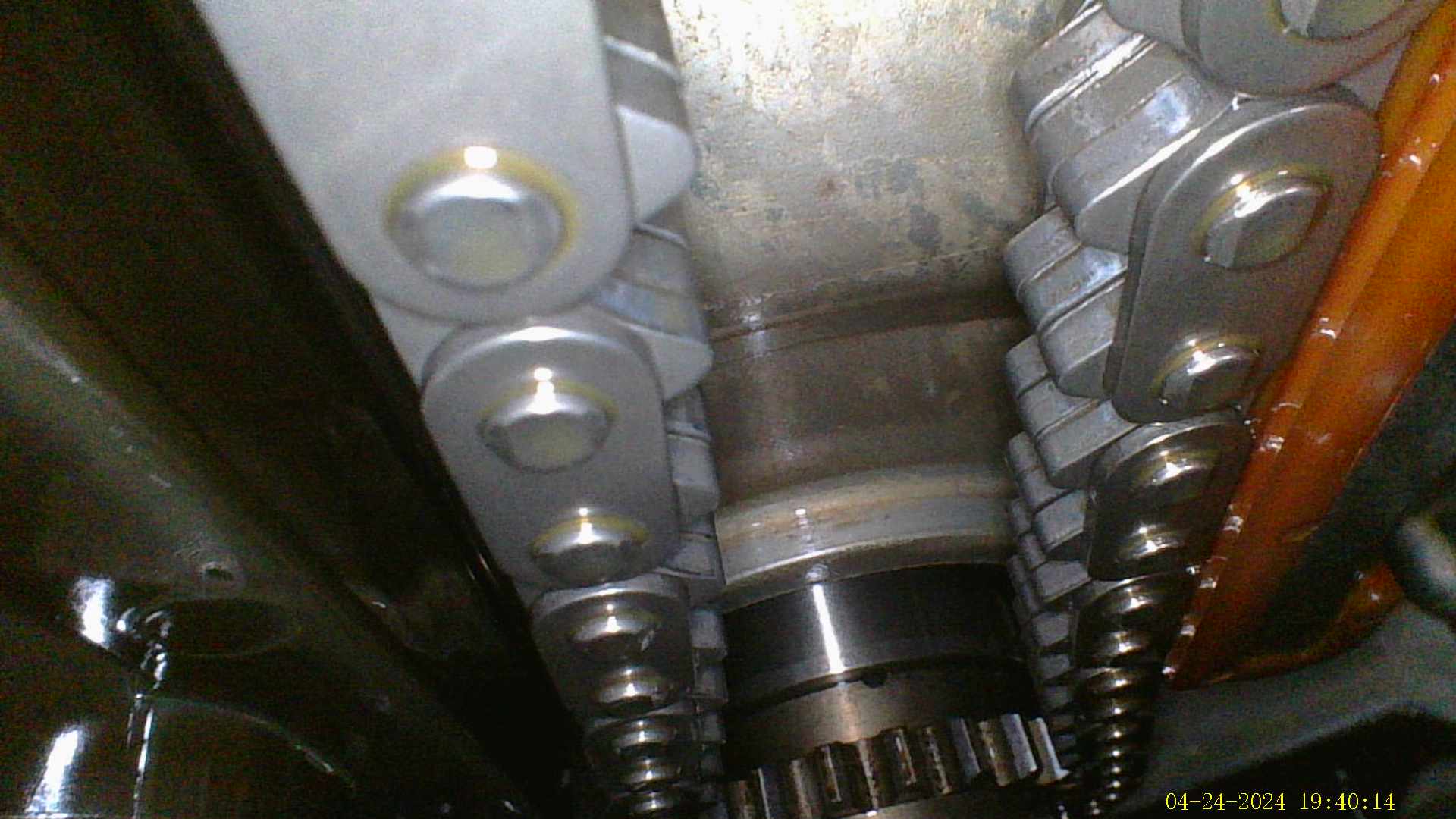

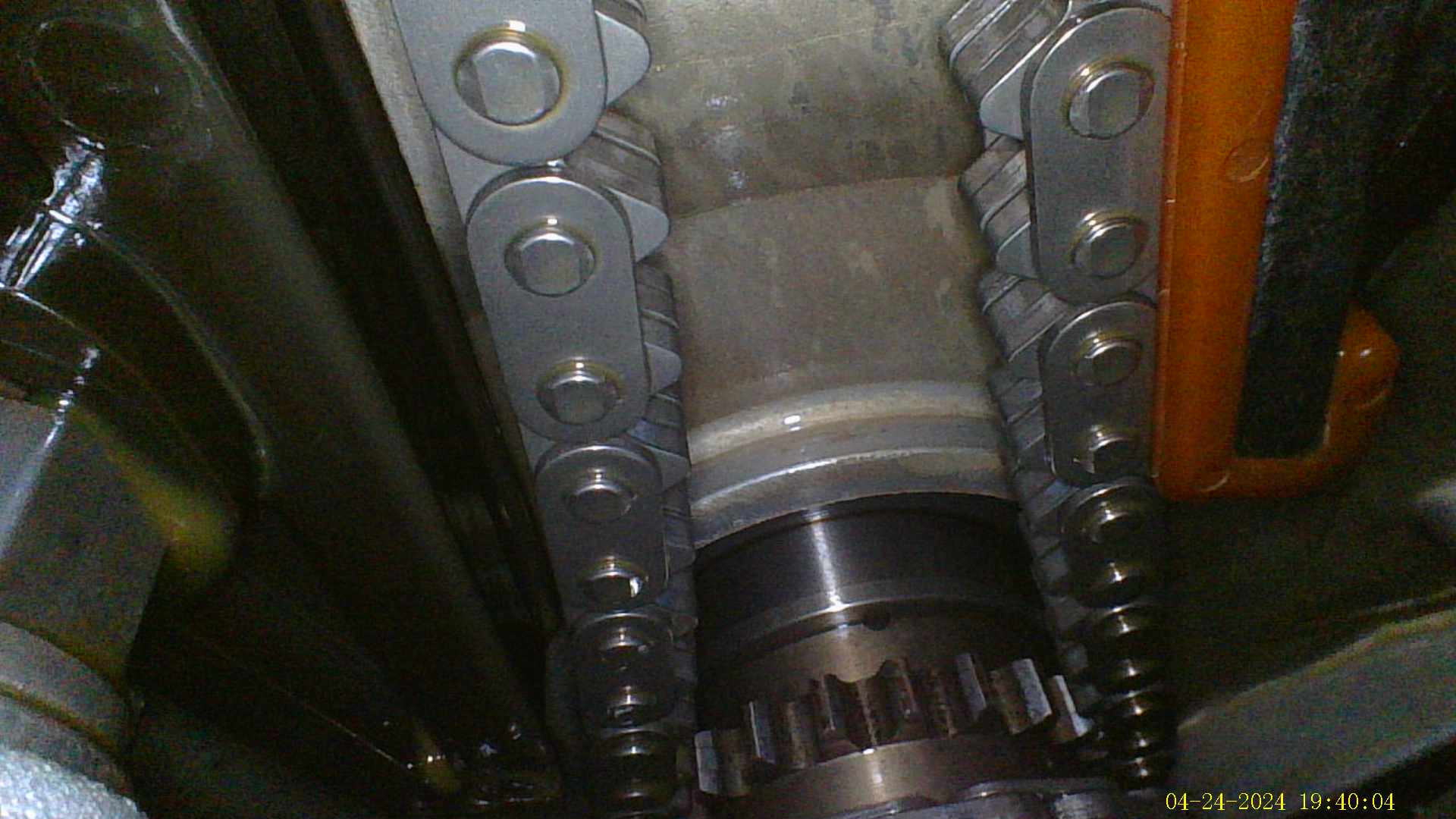

I'm not good with the timing components. But I send my inspection camera down thru my oil fill spout. I did notice something. By the crank sprocket it looks like one of the chains is rubbing against something. I took some pics if something does look off could someone with knowledge let me know. Thanks

This is the camera I have. I like it because you can go down into a cylinder and slide a lever and the tip will swivel back up to look at valves.

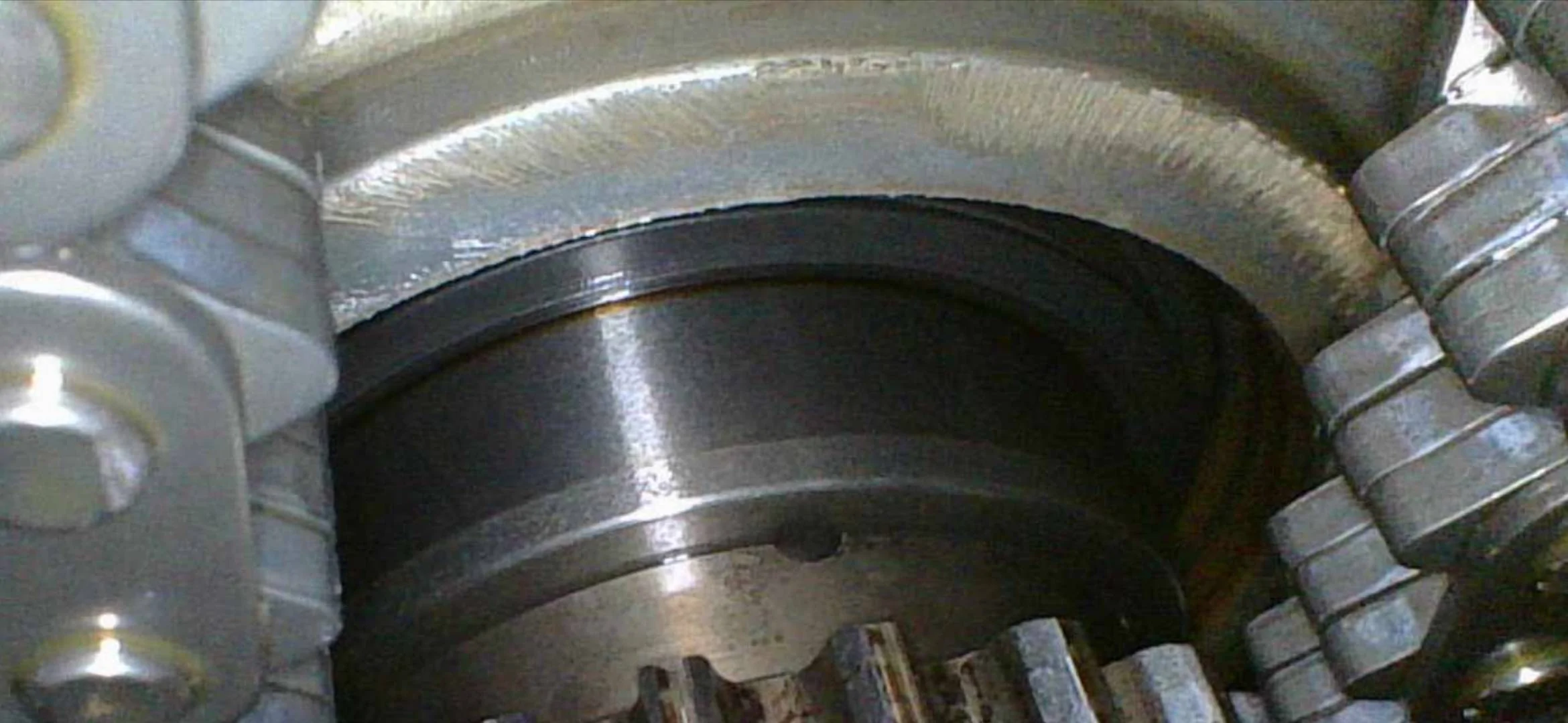

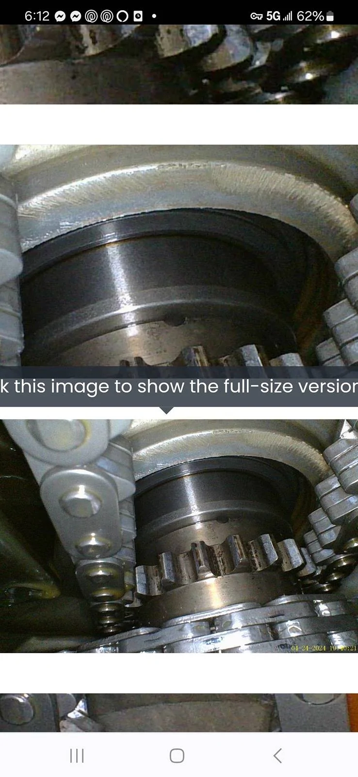

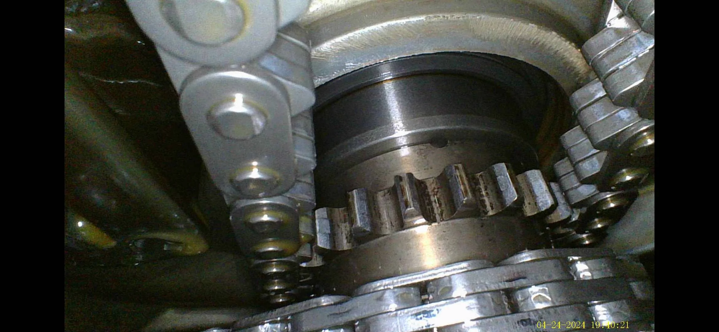

These are the Pics I'm worried about. Looks like the chain is rubbing against the oil pump cover?

What you are looking at is the back side of the timing cover. Those marks are not from the chain, you're fine.
