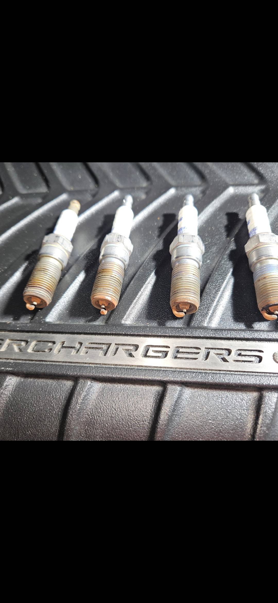

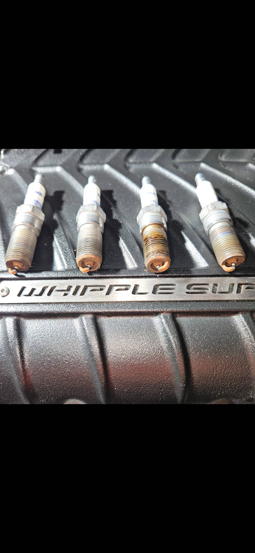

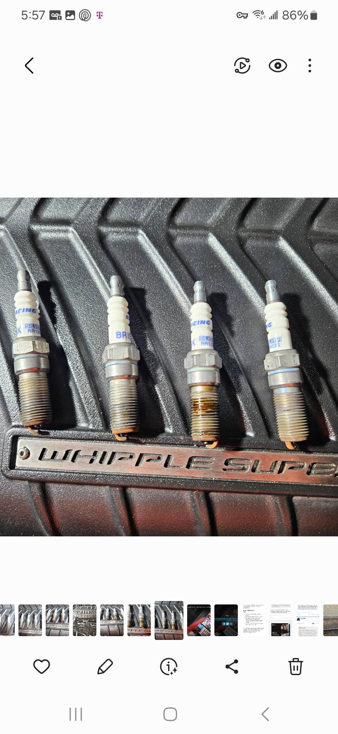

I pulled the plugs tonight on my whippled 2017. About 8k miles on the plugs. Noticed cylinder 7 had oil on threads only. And cylinder 4 had a tip on top of plug that was darker then others. I did a compression test all cylinders maxed out my tester at 200psi. Leakdown coming this week. Found this on cylinder 7. Do you think it could be valve guide seals. Seemed like aluttle blue smoke on cold start only. And anything to worry about on the cylinder walls? Thanks for any help.

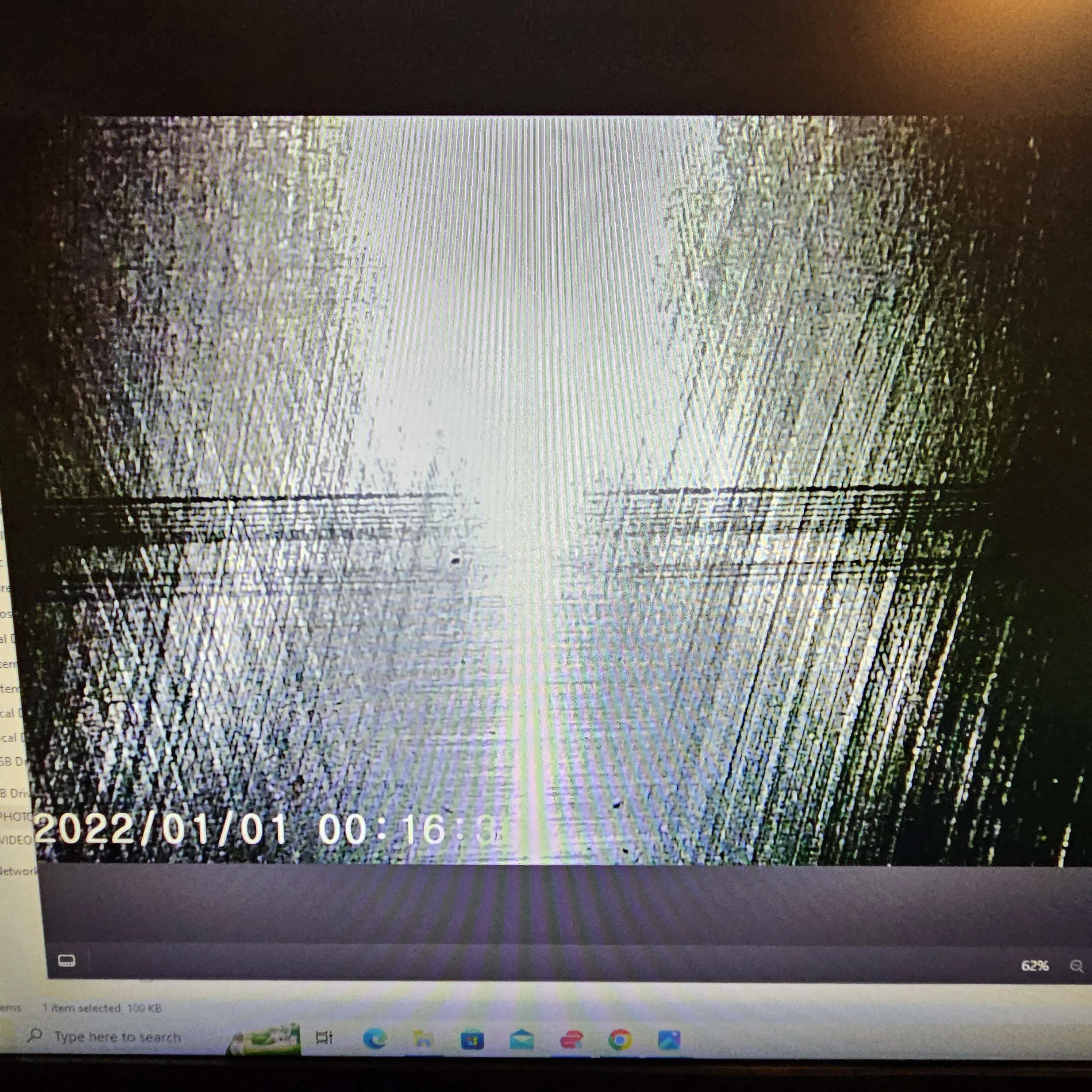

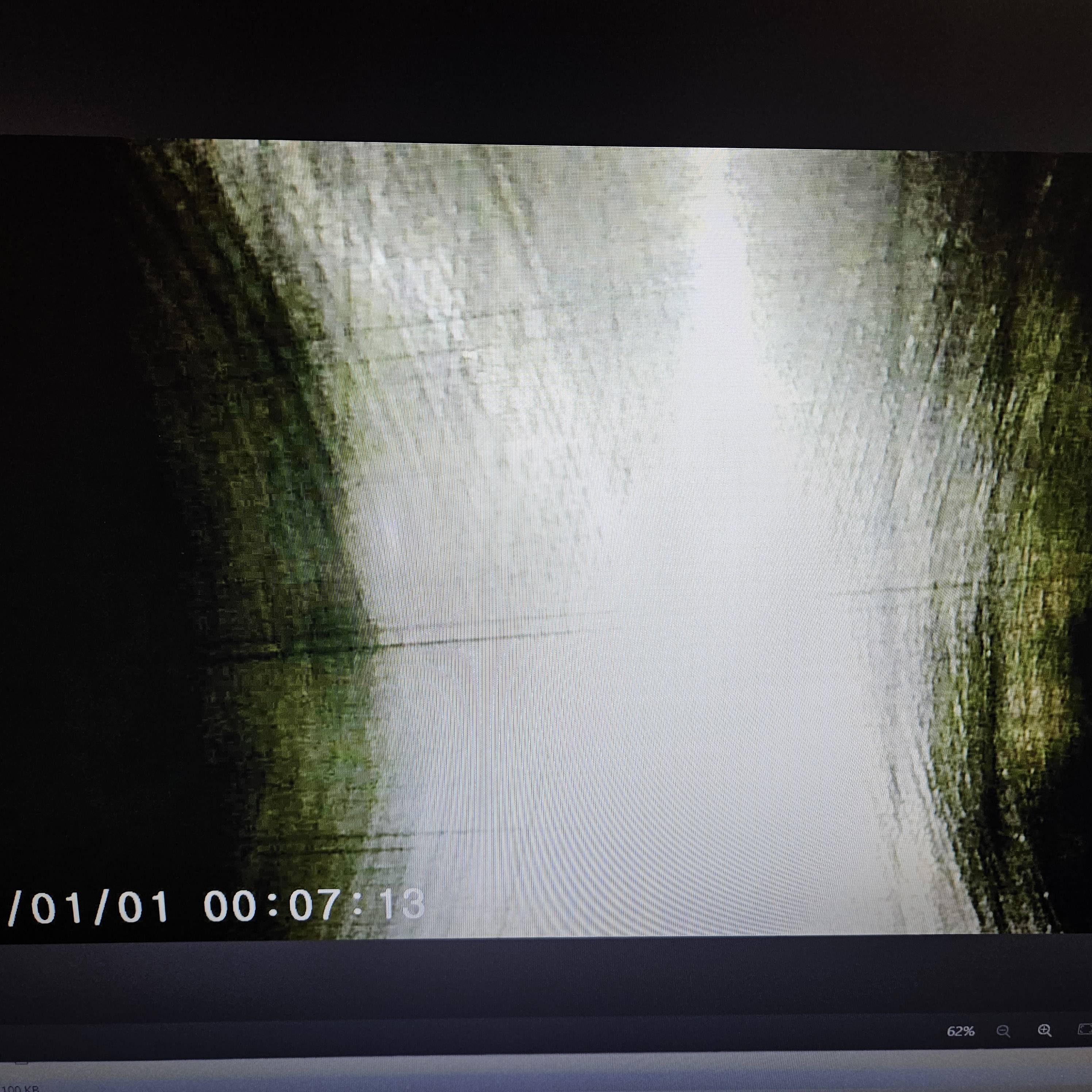

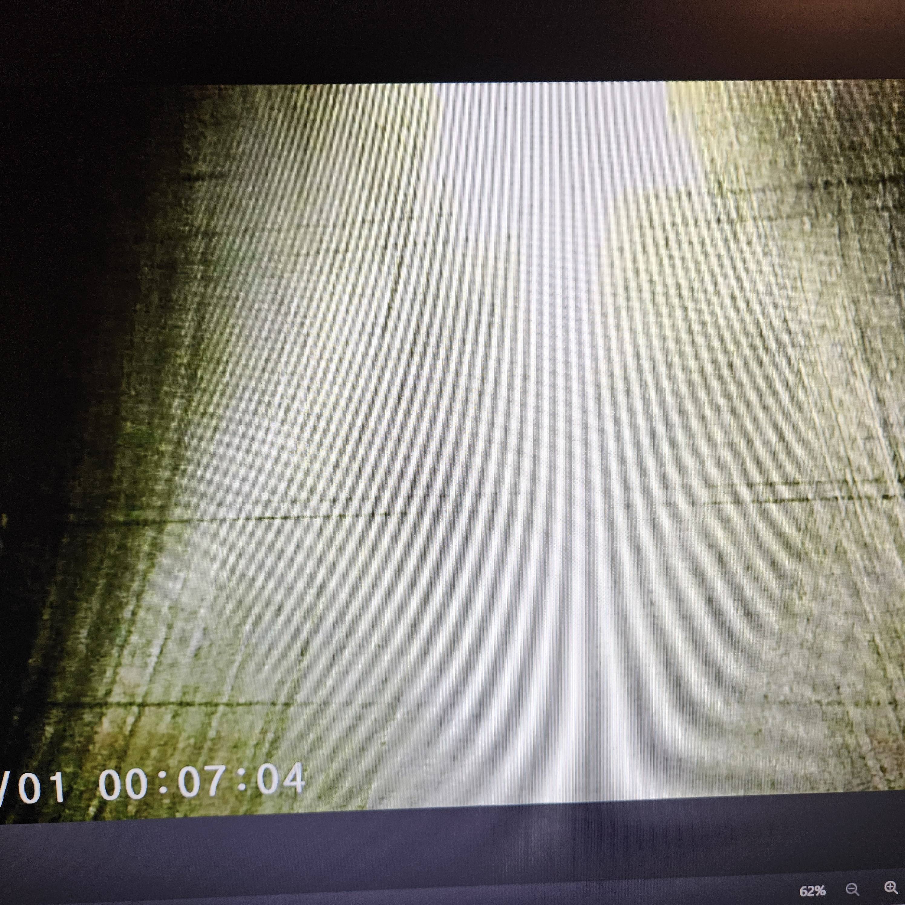

What scared me alittle more was the cylinder wall on number 3 and 4. How worried should I be about this?

GEN2 correct ?

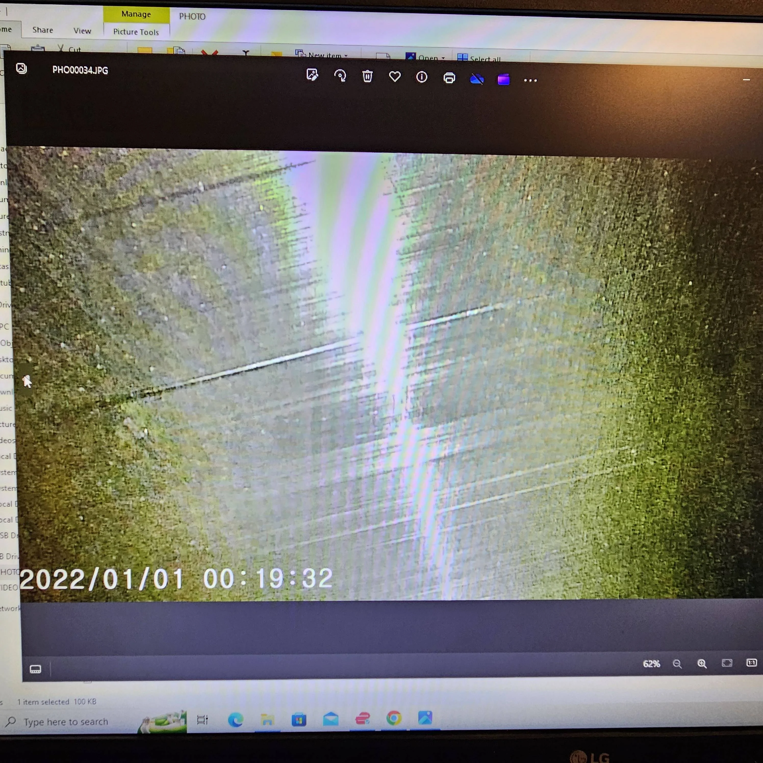

Cylinders look good,
LED borescopes make things look worse than they are. Add magnification and things can start looking sketchy when they’re not.
Yes gen 2. 60k miles. 35k on boost
I feel alittle better. That one scratch worries me alittle like it's down pretty deep in the middle vertically but doesn't go all the way up or down. I parked car for winter and was gonna do all new timing and opg and support and other mods. Just wasn't sure if I should pull to rebuild or just send it. Car seems to run good.

Yeah man those borescopes can highlight the most minor surface imperfections and turn nothing into an OMG moment.
Next thing you know the heads are pulled off and the naked eye inspection takes a peek then the finger nail surface scratch test is done only to find the borescope fooled the viewer.

Hello; I see what you are concerned about in the image. like others have said likely not too much scoring. The cross hatch is still good.

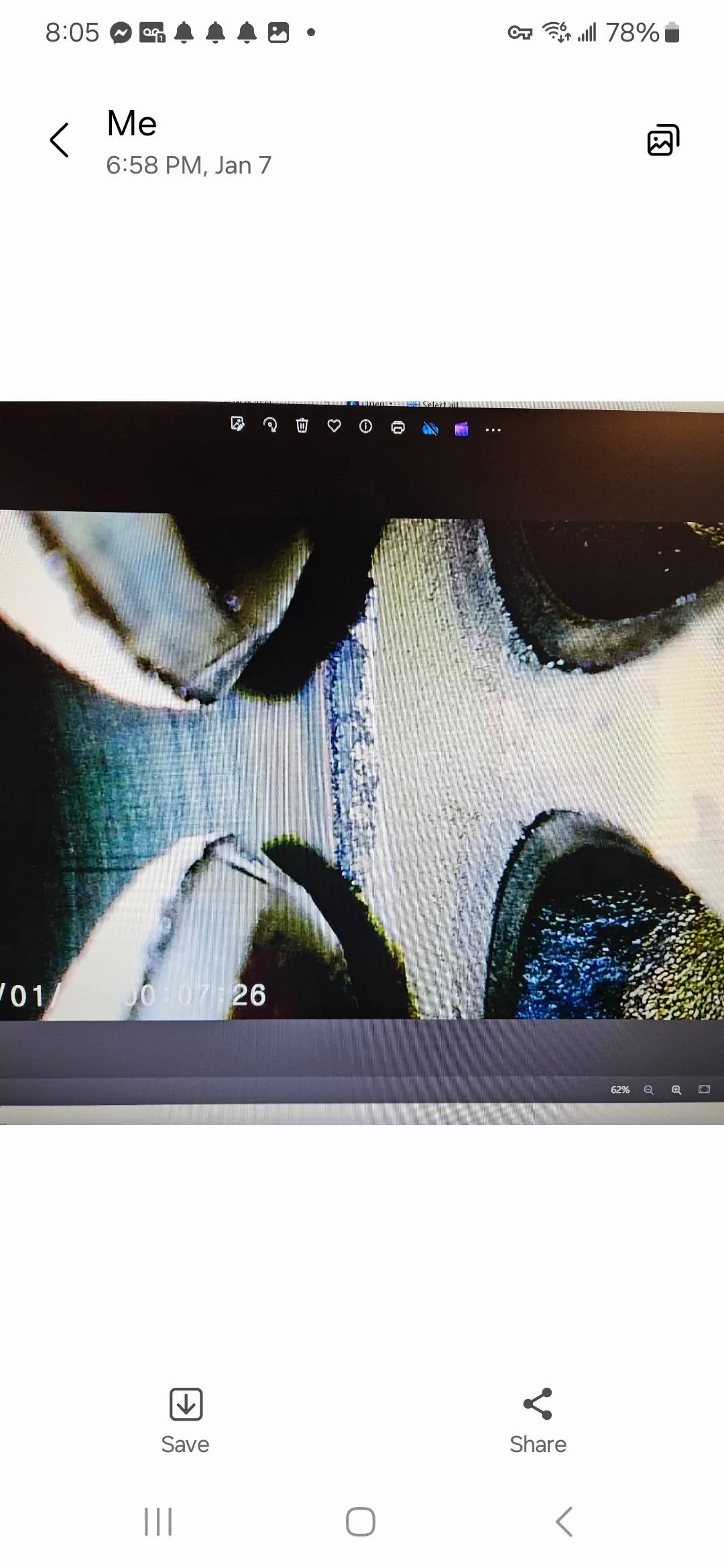

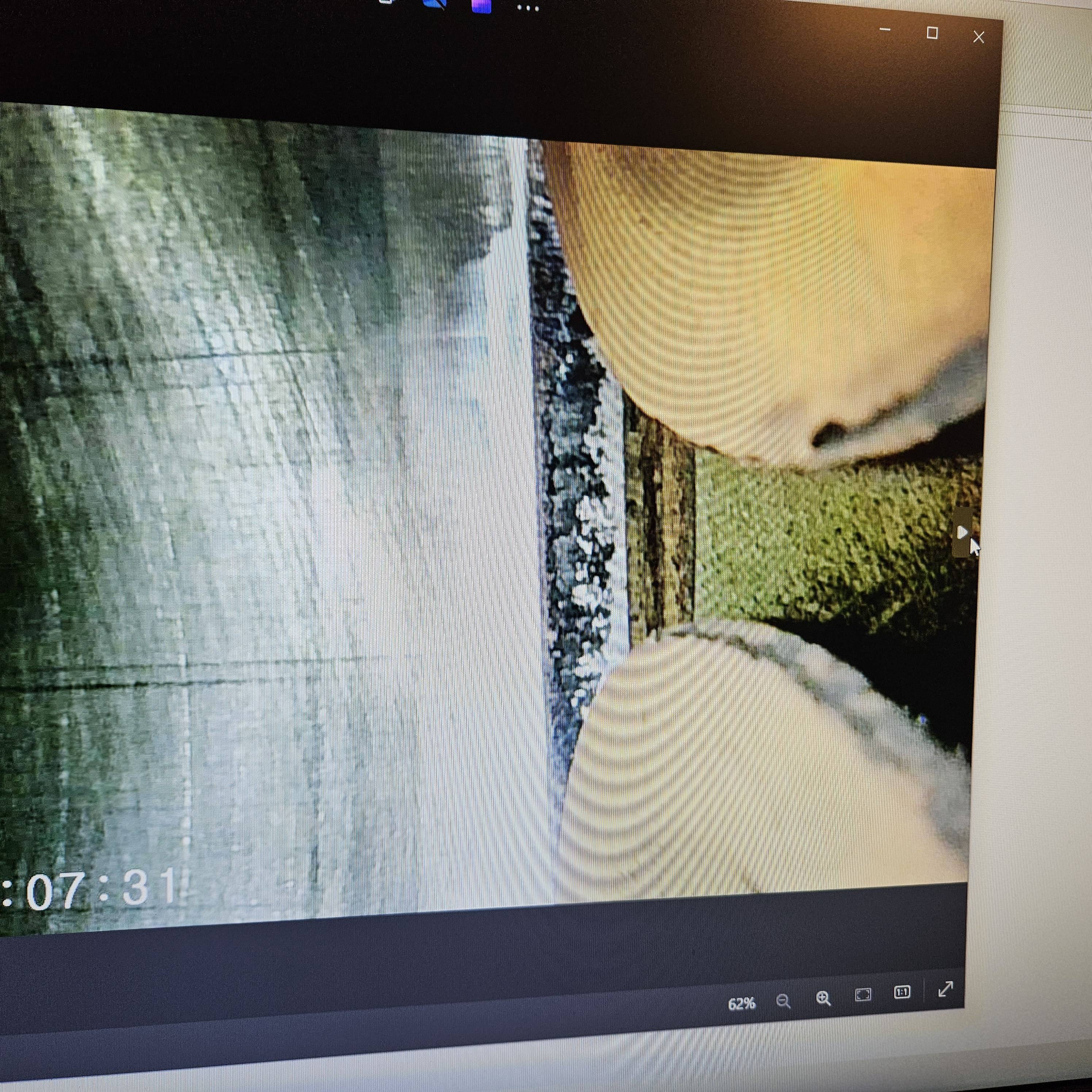

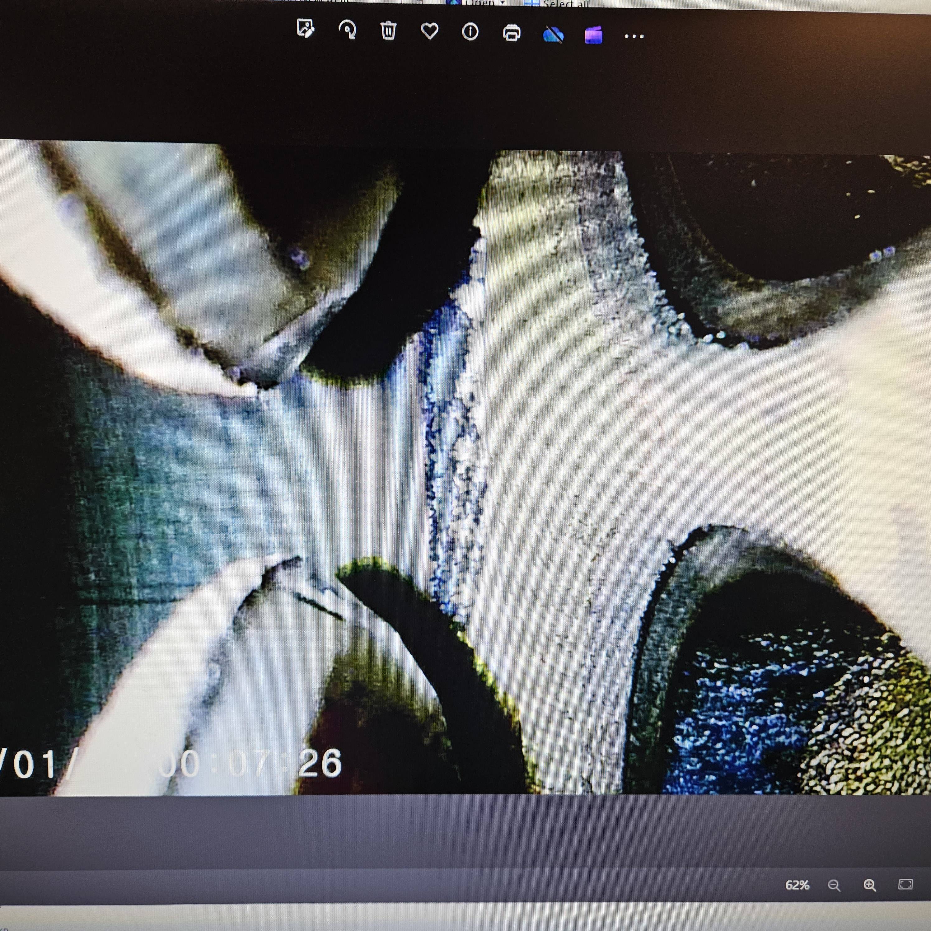

Last thing I noticed is this set of valves, seems like there knife edging. But I'm kinda thinking of just not even tearing into it over the winter and just drive it and build a forged shortblock over the summer while I'm enjoying the car for one more season

Same thing, that borescopes high powered LED is creating shadows that are being magnified.
I think there’s a bit of Boostane deposits building up.
I've seen those same black lines on my stock car, it's just carbon streaks after it flakes off the piston and gets stuck in the rings. Harmless. Everything looks pretty good.

all of that looks like a normal healthy engine to me. the lines on the bore are crosshatch if i'm lookin at that right. its good to see that. its getting stripes of vertical lines when ya should be worried lol

Hello; I would not tear down an engine based on the visual evidence shown. Especially if it is not using excess oil. I guess some 60,000 mile engines might look better but the cross hatch being intact seems good to me. Some of those miles under boost to boot.
