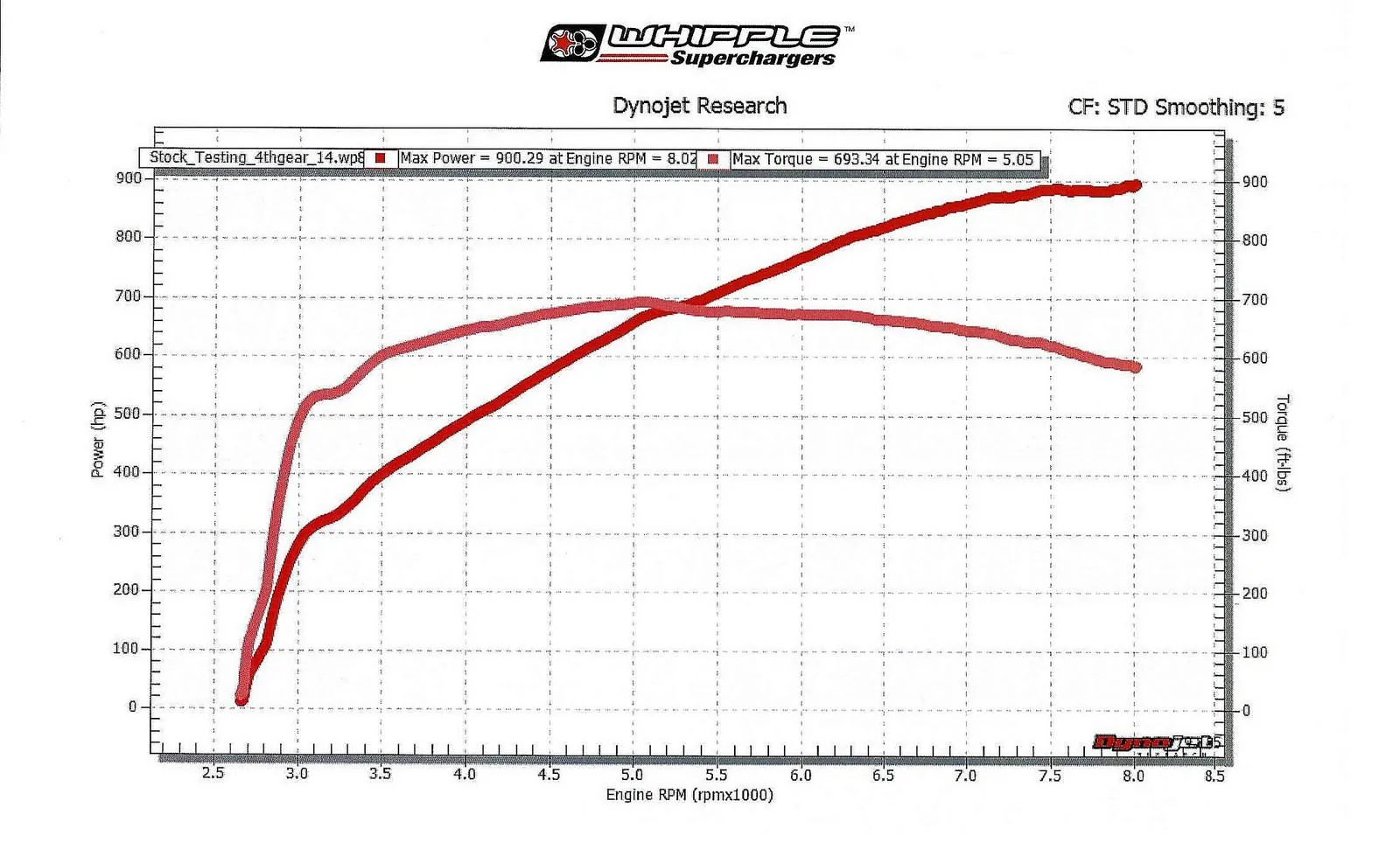

OK, here is the Dyno on my Race Tune:
Rwhp = 900.29
Max Torque = 693.34
RPM = 8000 (Engine red line is at 8400)
Pulley = 3.00"
PSI = 17lbs
Fuel = 91 octane + Boostane + MS109
https://flic.kr/p/ZbYJXC https://www.flickr.com/photos/141655656@N05/
My Daily Driver setup:
Rwhp = 825
Max Torque = 610
RPM = 8000
Pulley = 3.73"
PSI = 13-14lbs

@Will@Wipple did the install and I know he had to finesse and get creative on connecting the CJ air intake to the 150mm TB. The CJ is 140mm. We went with the GT350 block over a sleeved GT block as it will hold more power and we were able to go with larger pistons I believe. We ran the Dyno on 91 octane with a qt. Of Boostane additive and a few gallons of MS109 just for protection of knock at high RPMS. We plan on a future Dyno pull at 20 psi on C16 race gas to see what the “Beast” mode numbers will be :D

[MENTION=13339]olaosunt[/MENTION] sorry about the delay in getting back to you. The engine is holding up great and loving every minute of it. I had a top speed of 161 mph at the Shift Sector event and know I can do better. I need to get better on my launches and I'm in the process of ordering the Watson Ice Tank to help keep my IAT's down at race events. I was up at 148 IAT's at Shift Sector so I was pulling a ton of timing. Going back in February to their next event and looking to do 180-190mph.
I've only gone down to the 3.00" pulley for now which put down the 900 Rwhp and will in the near future drop down to a smaller pulley and take it up to 21psi which should put down 1000+ Rwhp.
