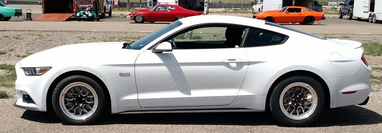

I purchased this car a little over a year ago. I purposely purchased it to boost it. The original intent was a Whipple, but then wanted to put a turbo in it, but since no kits existed at the time and none exist today that I'm interested in...Whipple it is!
I watched a local Whipple car go 140+ and that sold me. I watched it run on a Saturday and I purchased on a Tuesday. Here's what I purchased.
I started tearing the car apart the 22nd. I've been working 0-8 hours per day since taking my time. Here are a few pics http://imgur.com/a/L1mXg
Fuel system should be here Thursday. 4" Pulley should be here Thursday. I have to go out to town Sunday but ideally I can fire the car Saturday. I think I'm going to fire the car with the factory fuel system to check for leaks and what not. Then pull the blower, swap fuel systems and start the tuning process.
The crank gear and OPG weren't anywhere near as bad as I thought they'd be. I did re-time incorrectly, but was able to correct it with ease. I wouldn't hesitate to do another set having done one now.
