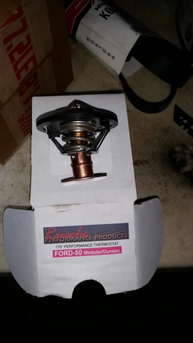

Swapped out the Evenflow 160 for the Reische 170 and can definitely see a difference in my CHT's already with it just idling.

How are peak CHT after the Reische

After Idling for about 20 min peak CHT was 207 vs 228 and Up with the Evenflow. Thats just letting it idle for a long time.

Nice. Have you checked it while driving also?

Not yet will soon though ill keep y'all updated

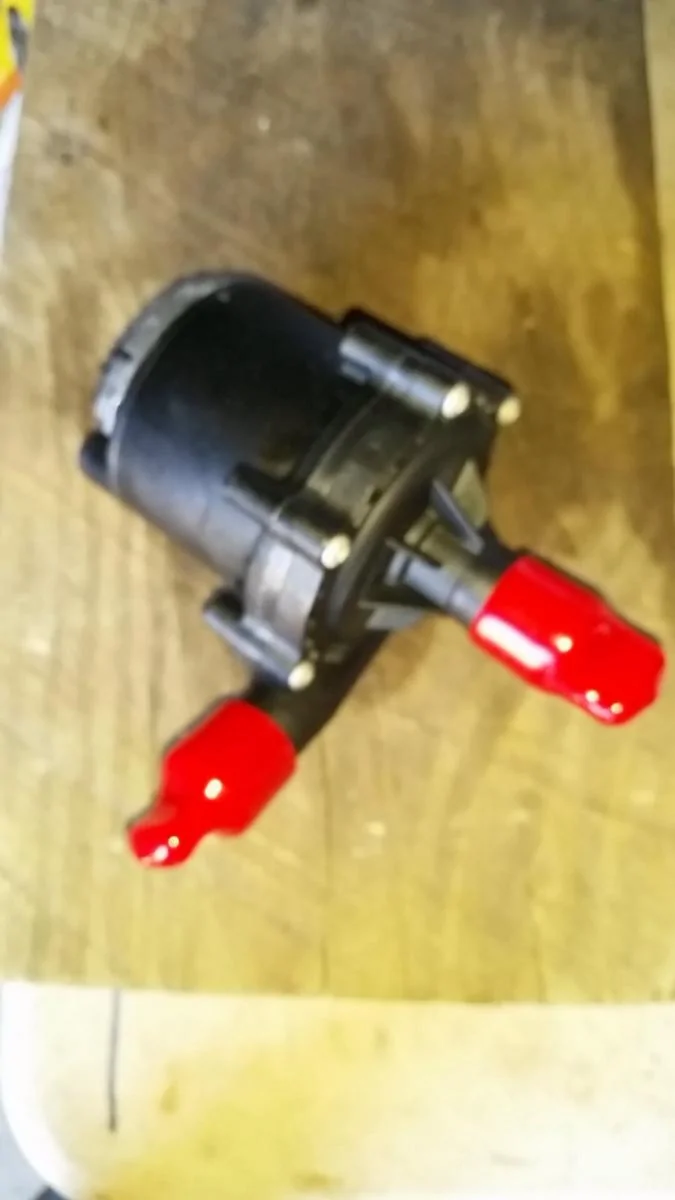

Got the upgraded Heat Exchanger Pump in today from Whipple.

This is the intercooler pump right?

Yes

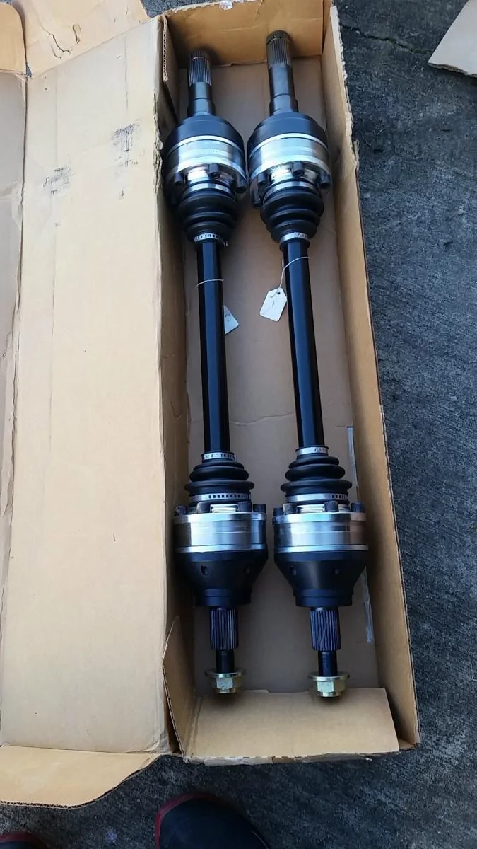

Installed the new Pump and the DSS Half Shafts today. The pump was a messy job, wish there was a better way of draining the reservoir other than removing the hoses. The half shafts was a easy job, took about 30min for each side. The old ones popped off with out having to pry them, just a couple strong tugs was all it took for mine.
