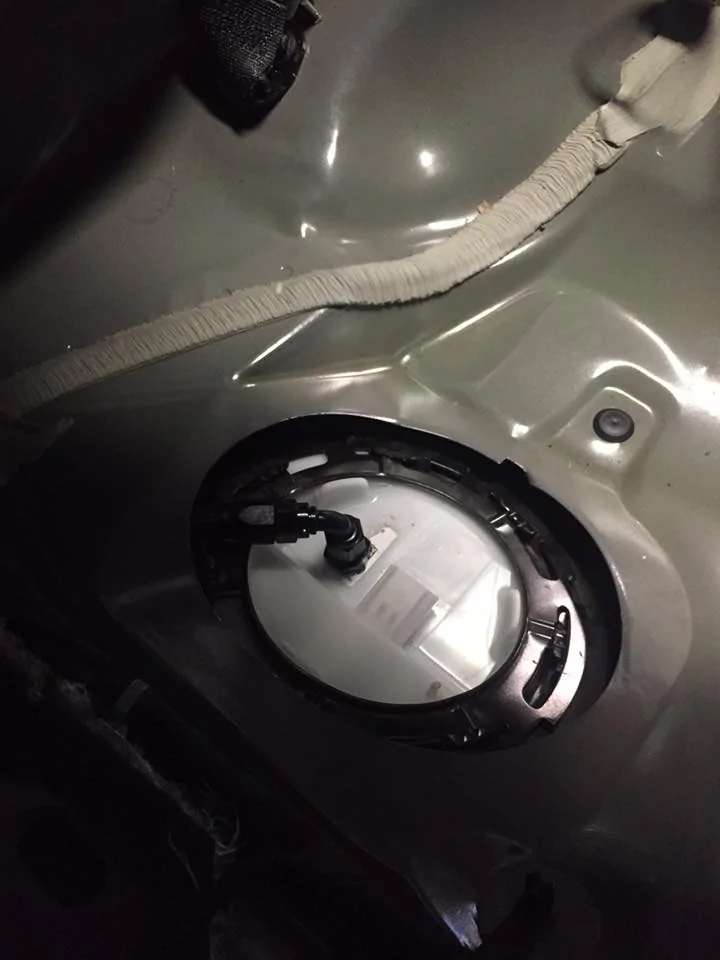

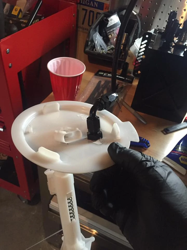

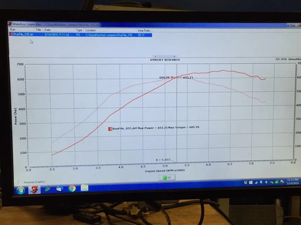

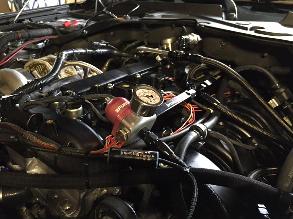

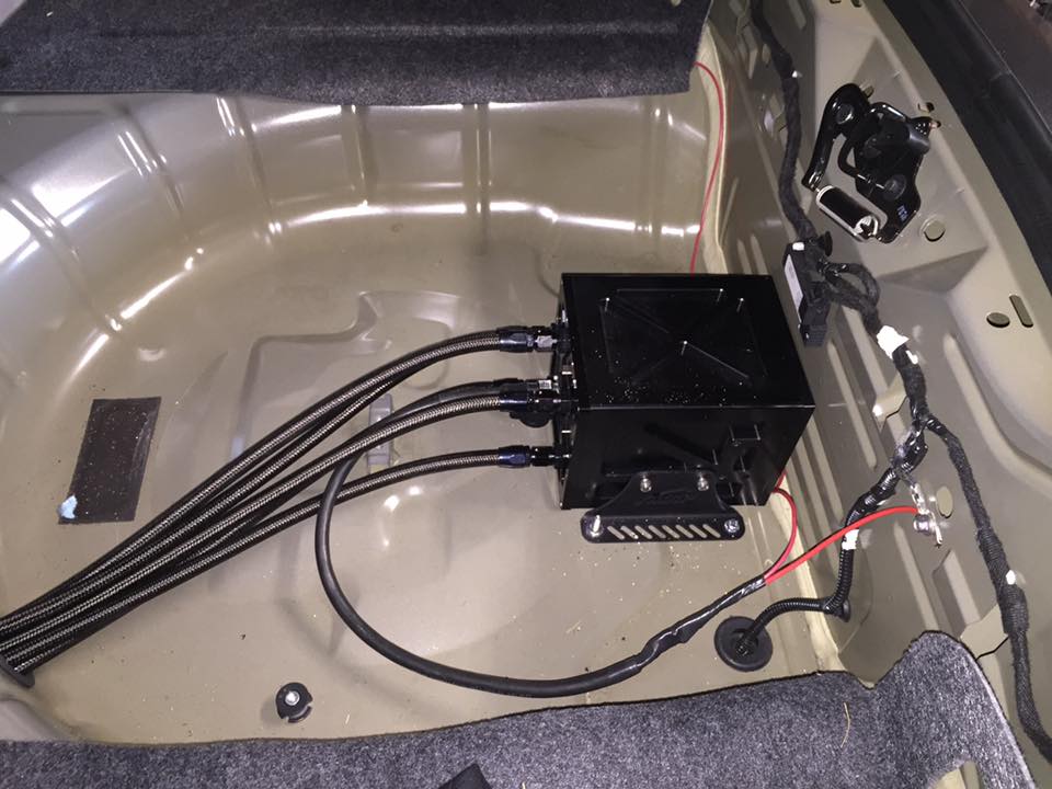

    Will update the original posts when I get some free time but wanted to drop in a few new photos and updates real quick.
    Got the new TUNE+ Mega-Sauce E85 Fuel System installed and got it back on the Dyno :) Ended up making 663whp & 605wtq on a lazy run, leaking a bit of coolant!! Seems the $12 OEM head gasket isn't liking the big power #'s over 600whp. Adam is currently working to get a custom head gasket so MAP can give the engine a little needed TLC. Then we can push this thing over 700hp! New fuel system will support 1,000hp without a problem, it's amazing to say the least. Car is so tame and quiet it's crazy!!
    **TUNE+ Mega-Sauce E85 Fuel System**
    -1 gallon surge tank
    - 1x 450lph pump feeding port injection
    - 1x 320lph feeding direct injection
    - Converted to return style system
    - TUNE+ E85 port injection system 1463501722.13256074_10205793217380210_2034880349270126119_n.jpg 13254386_10205793217820221_3425049013759769231_n.jpg 13244632_10205793517747719_6851995039308277360_n.jpg 13232970_10205793517867722_4529887520912505260_n.jpg 13221701_10205793217500213_6035672025274293472_n.jpg 13178584_10205777206859957_1797156038103133982_n.jpg

    That fuel system was going to be the death of me. LOL

    I know if we had to run another foot of that damn -6 fuel line I was going to smash my head into the ground... Still can't get over how awesome that all worked out though!! Thank You Sir!!

    Awesome numbers!!!
    How much boost are you running? Wonder how much more the 8374 has left in it?

    Believe that was on like 30-32lbs, should still have a bunch left in it :) Hopefully be finding out VERY SOON!!
