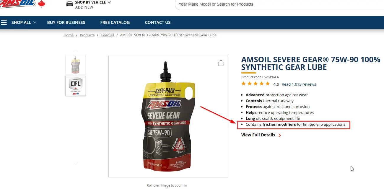

Hey guys, I just need a sanity check, but I just drained and refilled my diff with Amsoil 75W-90 (PN# SVGPK-EA) and didn't add any additional friction modifier since Amsoil states its already included in the oil. Just want to make sure there isn't any issues running this oil. For reference I have the 2017 GT with PP and 3.73 gears.
What I bought and used:
https://www.amsoil.ca/p/amsoil-seve...kZzEkdDE3NTg2ODYyMDQkajUxJGwwJGgxNDYzNTg3MjM5

elChupacoffee
elChupacoffee
Jul 25, 2024
52
51
Canada
Ken
2017 Mustang GT PP
According to the website it does, if I am understanding this correctly.
