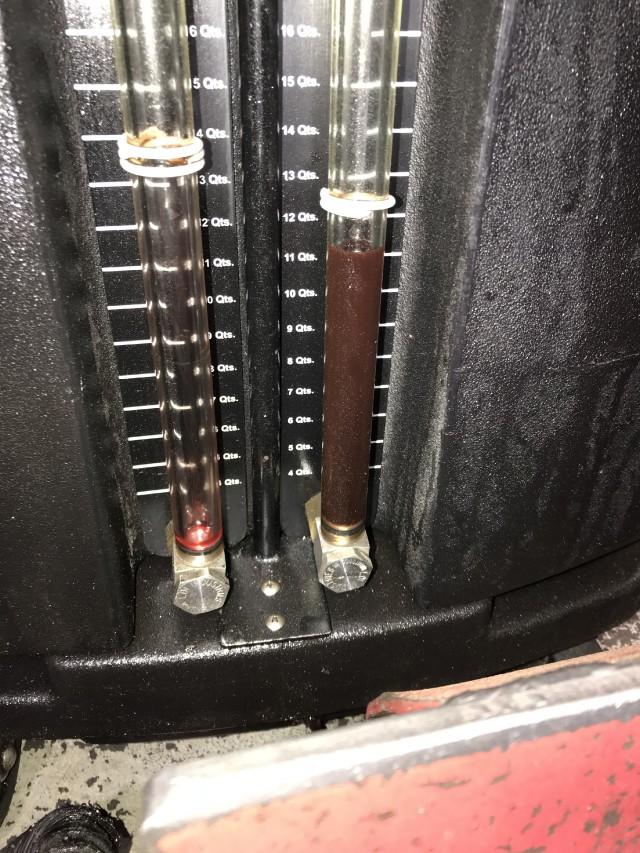

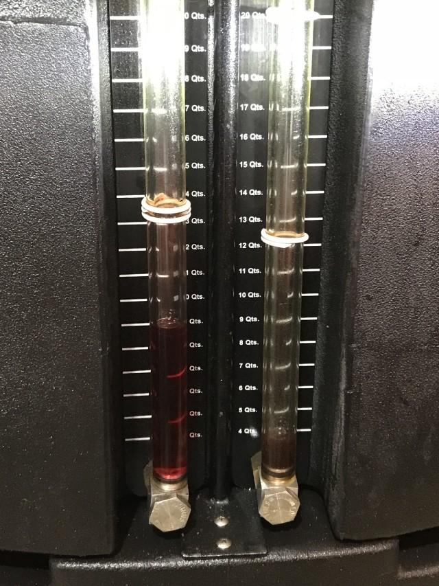

I was going to just drop the pan and swap ATF but honestly - the right way is to have Ford flush it out so it gets all 12 quarts out from the converter and the cooler and lines - so I went to Bill Utter Ford yesterday with cases of Amsoil to get it done. They've been awesome to work with both times I've been there by the way.

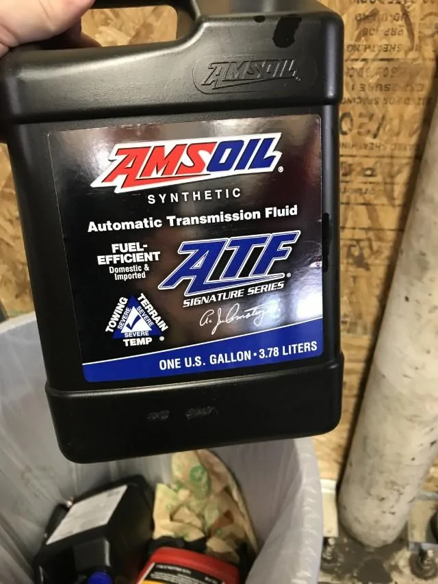

So we got it on the rack and swapped out 12 quarts of motorcraft Mercon LV to 12 quarts of Amsoil Signature Series Fuel-Efficient Synthetic Automatic Transmission Fluid (ATL). I know you can't judge much they say by the appearance of trans fluid on it's own, but at 9k miles you could tell it contained organics and had seen some work during the transmission's early miles and break in. Nothing about the fluid's appearance or odor caused me any concern. Boy does that fresh fluid going in look nice though.

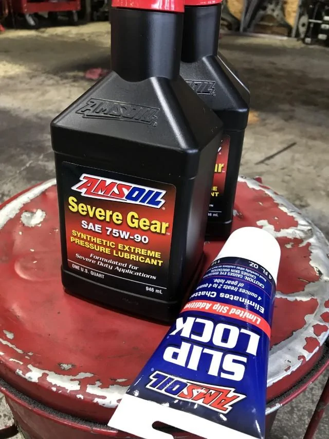

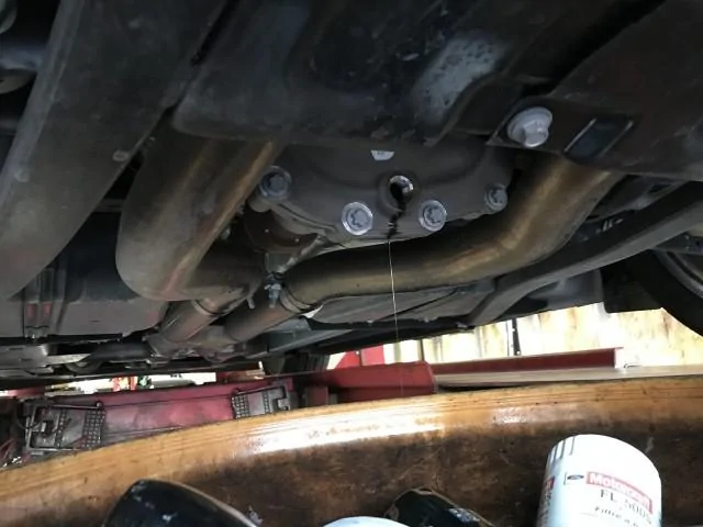

Then I had them drain the rear differential since it was on the rack anyhow and swap over to Amsoil Severe Gear 75W-90 with 4 ounces of Amsoil Slip Lock additive for the LSD. Since I had 2 full quarts I had him leave the plug out and flush a few ounces through to get any old fluid out and any debris or junk out of the rear. When it ran clear, we closed it up and topped it off and brought it back down off the lift.
