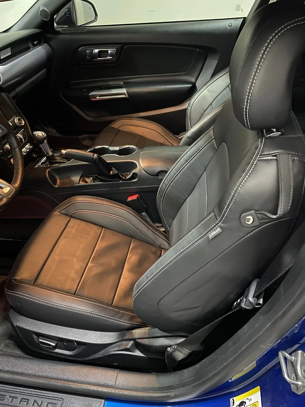

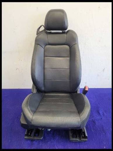

Ok, let's see if I got it right.
These are regular old GT Premium seats:
And these are the Premier seats:

That is correct. Bottom pic is part of 201/401A Premium Plus package that included nicer seating material and soft touch surfaces added to center console and door panels as well as digital instrument panel instead of mechanical gauges. Memory seats too.

Difference is between the 200a/400a premium trim level which had the “plain” bolsters, or the 201a/401a high premium trim level with the different perforation and extra seam.
The digital gauges must be an ‘18+ thing. 2015-2017 did not get those with 401A. It was just memory seats, Shaker Pro, BLIS, and special ambient lighting.
The premier trim was its own special package. I can’t remember if it was $395 or $495. I’d have to dig out my window sticker.

My '18 Ecoboost Premium convertible has the seats on the bottom with the white stitching. But the seatbelt holder/guide is like the top seat. I do not have the soft touch pads on the console. Also, FWIW, my door sill trim plate is silver with white lettering that lights up. IDK if that's an indication of trim level or not.

The illuminated door sill is listed on premium package mustangs from the brochures. The 2018+ cars got a little more stuff with the 201A/401A. And convertibles are a whole different beast.
The seatbelt holder has nothing to do with the trim level other than Coupe vs Convertible. The Coupe has the simple leather strap, the Convertible always have the plastic guides, no mater what trim level you have. From 050a all the way up to 401a.
