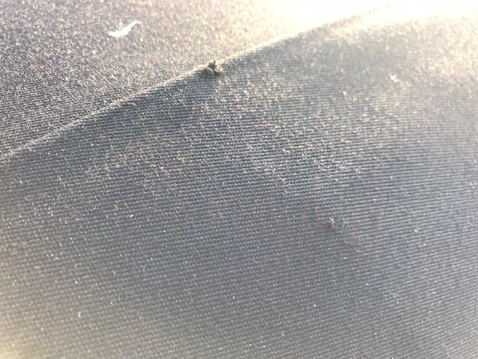

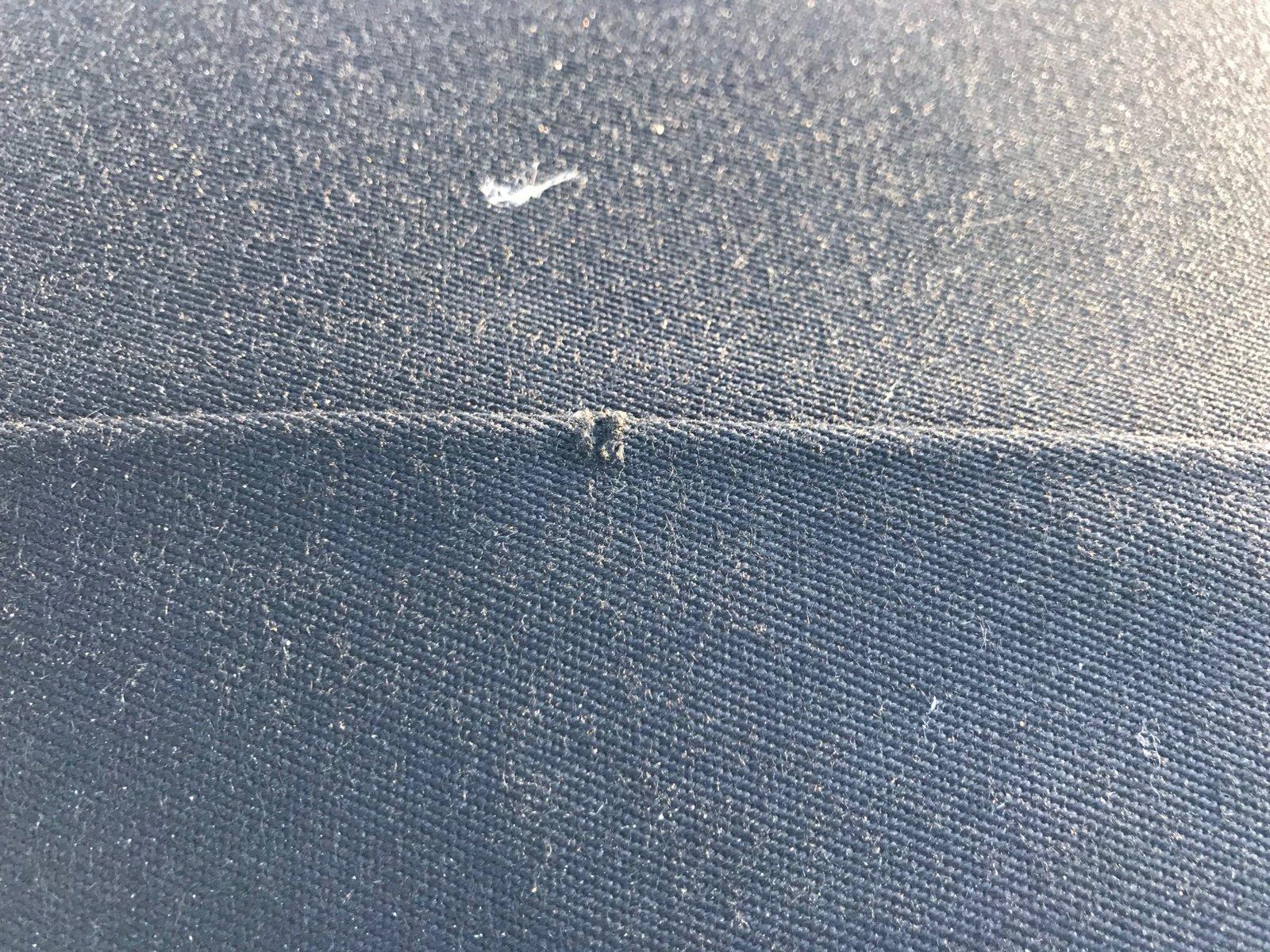

Convertible roof issue with the plastic tonneau caps.
When the plastic caps are fitted they appear to be rubbing through the roof fabricwhich is visible above the doors when the roof is up. See pictures. If your roof is damaged then it’s a new roof under warranty and at least five months in the dealer to do it.
If your roof is not damaged then speak to your dealer for a set of revised tonneau caps, you’ll need to hand over your old ones. The new ones are quite a bit different.

Lightning blue S550 Coyote convertible
Five months at the dealer?! Surely the job only takes a few hours to do and it’s not detrimental to the driving of the car so there’s no need for the car to be there for five months!?
Yep, 5 months and counting. And it is detrimental to driving the car when they’ve forgot to align the seals correctly, it leaks and then needs a whole new dash fitting because the water has damaged the leather. I’ve refused to accept the car back until it’s fixed, which is something Ford are completely incapable of doing.
The dash is just rubberised plastic made to look like leather with moulded fake stitchingso water shouldn’t affect this but not good if the roof is leaking, surely this kind of adjustment only takes a few days at most to sort? I’m going off personal experience of working in a Ford Bodyshop for 18 years now. What has Ford customer relations said or have you simply left it to the dealer to sort?
The substrate absorbed the water and burst the top material out.
You would think it would be at most 30 hours all in to remove the old roof, fit the new one, adjust and run the diagnostics. There aren’t even any special care points on the work instruction sheet, it’s supposed to bolt right in as a complete assembly.
The dealer keep saying the car is ready but it’s been an endless list of problems, the latest one is the roof won’t even go all the way down because it’s catching on the car somewhere. Customer relations are utterly, utterly useless and seem to think 5 months is an acceptable amount of time.
