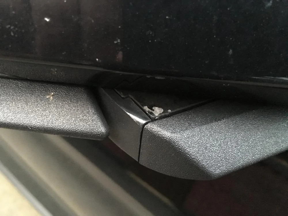

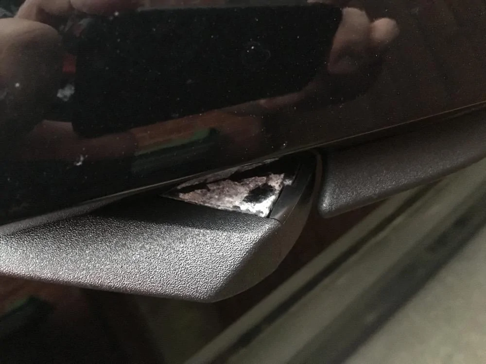

paint flaking/wearing off on door mirrors.
with the mirrors folded, the unsightly paint wear shows up. I know at least one other person who has mentioned the same issue.
Passenger side above, driver side below.
