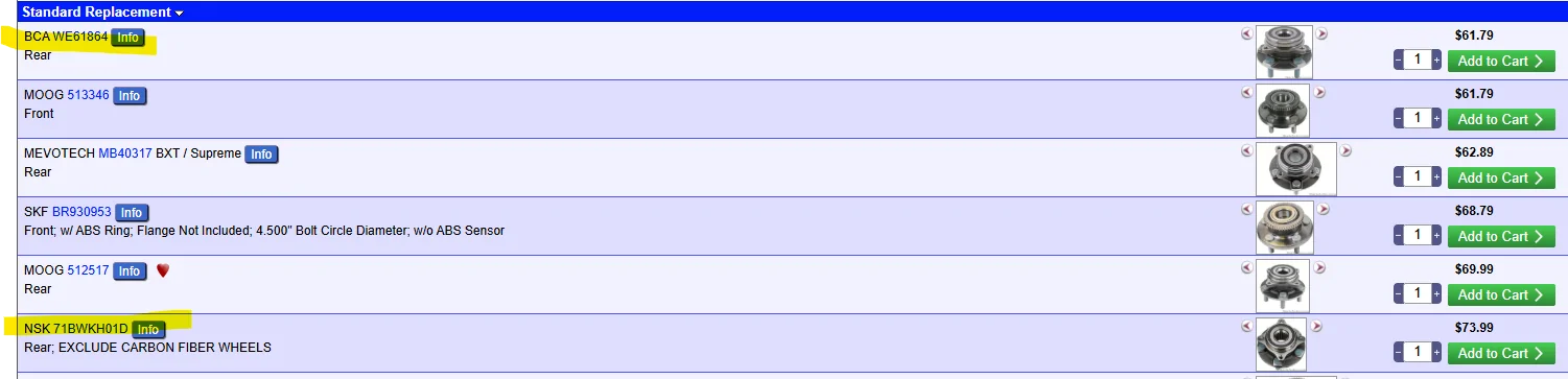

So I’m shopping for rear hubs and finding parts running the full spectrum of prices and part numbers. First thing first, I don’t need studs. I have OPM studs I’ll be swapping from my current hubs. So I don’t need the flashy “Ford Performance” ones that have the ARP studs, but I want the best hub to get. What have you guys done?

OK...I'm awake this morning, LOL. Those $400+ hubs are for a pair, not individual, LOL. Still don't want the ARP studs, so I may just get the hubs from OPM so I can get my matching studs. Dang it.
Use either of the highlighted yellow ones.
