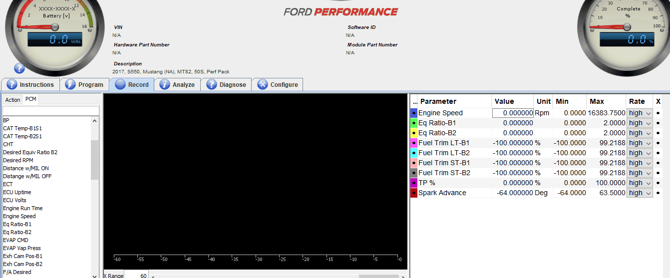

Do you have the in dash vacuum gauge? It read normal at idle , 20 ish inhg? If it went back to normal on the dash when stock tb and tune were last on I'd prob focus on Tb and adapter and fittings on intake tube. but id have expected your propane test to reveal any vac leaks, especially at idle where vac is highest. did you notice if idle fuel trims were impacted by the propane at all? no harm in continuing to verify no leaks if you already have the equipment.
the procal dongle will log with a laptop, if you do, select these parameters. its limited in what pids it will allow access to but at least some of the fueling is there. add TP commanded and MAF Rate to that list too. Idle TP angle should be around 1.2 degrees with 35lb/hr maf. if the mani is leaking, id expect TP angle to be lower.
