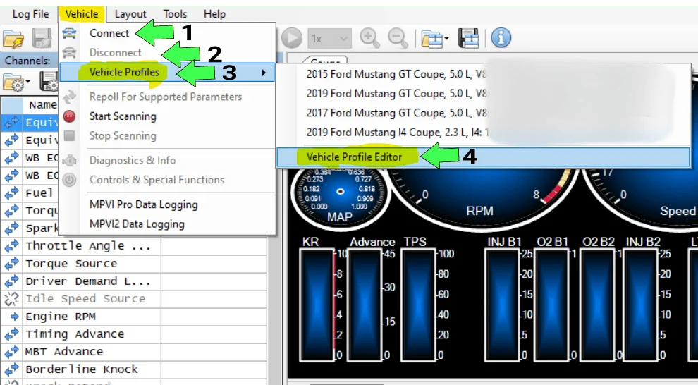

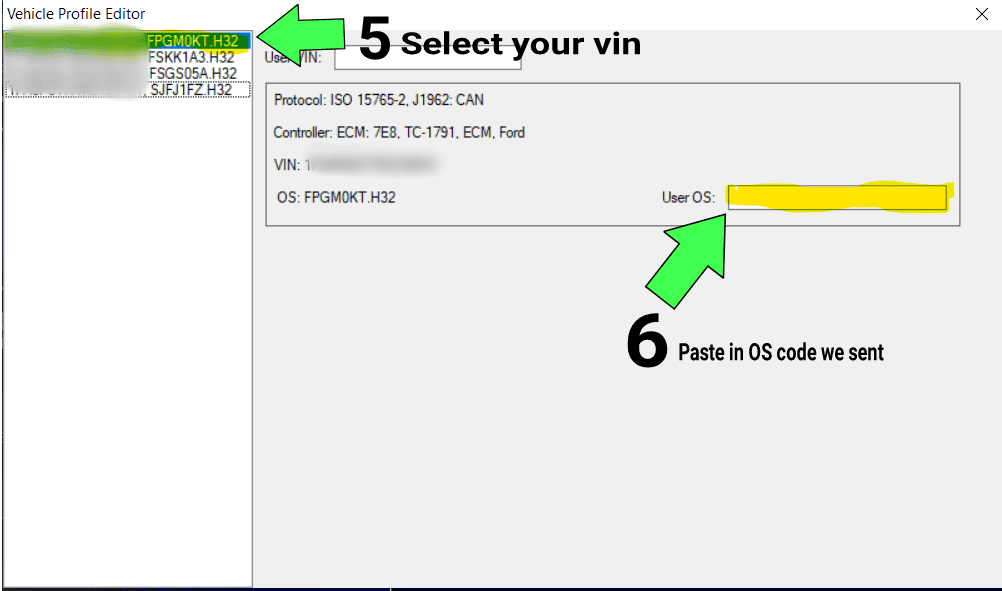

I think the issue is probably that your tuner uses a custom OS ID to lock the tune. When VCM scanner can't identify the OS, it defaults to standard OBD2 SAE PIDs that any datalogger can read. You need to get the OS code from your tuner to unlock all of the Ford specific PIDs. When I started datalogging, my tuner sent me these instructions. However, I ended up doing my datalogging with a MPVI2 because it was already setup for my laptop. I had to do this for the MPVI2 just to get the right PIDs to show up, so I assume the RTD is the same.
